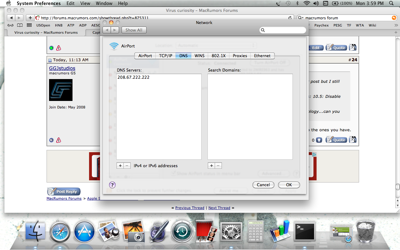

WHY AM I BEING REDIRECTED TO OTHER SITES?
Some users experience a problem with being directed automatically to sites that they didn't intend to visit. This may also occur when searching with Google. You don't have a virus! It's a problem with your DNS settings, either in your Mac or in your router. Try resetting your router. Here's how to fix the problem in Mac OS X:
  1. Go to System Preferences > Network
    There you will see a padlock icon in the lower left corner and the note "Click the lock to make changes".
  2. Click the lock and enter your administrator password, so you can change DNS servers
  3. with your network selected on the left column, click the "Advanced" button
  4. Click the DNS tab to see the listing of your DNS Servers
  5. If any of the DNS servers are greyed out after entering your admin password, refer to this: 10.5: Disable DHCP-specified DNS servers
  6. Click the "-" icon to remove all existing DNS servers
  7. Click the "+" icon to add the following servers.
    You may choose either OpenDNS or Google servers (not both sets):
    OpenDNS:
    Primary DNS Server: 208.67.222.222
    Secondary DNS Server: 208.67.220.220
    Google:
    Primary DNS Server: 8.8.8.8
    Secondary DNS Server: 8.8.4.4
  8. When you've completed your changes, click "OK" to close the Advanced settings window
  9. Click "Apply" on the Network window to save your changes

I am having this same issue, being redirected to The Click Check.....GGJStudios I read your post but I still need help! When I go to reset my DNS settings, they are greyed out. You refer to this:
"If any of the DNS servers are greyed out after entering your admin password, refer to this: 10.5: Disable DHCP-specified DNS servers"
I don't get it though, even after I read it. Not too familiar with my Mac or computer terminology...can you help me please?

What DNS settings does it show? You should be able to add the OpenDNS servers, in addition to the ones you have.
I took some screenshots. I changed the DNS to what was explained in the earlier post, but the redirection is still happening. Is the issue something else?
I also used DNSChanger tool to scan, and it said nothing was found.
