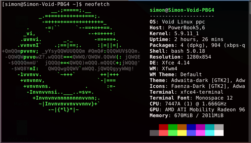

...well, sadly, openBSD has been shed from my TiBook 1GHz for the moment due to my lack of staying power, and macbuntu went funny and stopped booting, but void-linux on a freshly re-partitioned hard drive c/w Leopard is proving to be fun and stable and much much faster once I removed
Code:
slub_debug=P page_poison=1
from
Code:
/etc/default/grub
The normal USB 1.1 ports at the back behave normally. The TiBook is scruffy but all works except for the internal SuperDrive which I fitted years ago to replace the first broken one. OF booting works ok from USB 1.1, FireWire works for external FA66 audio card, Target Mode Boot, DVD burning and HD r/w in external caddy.
[PROBLEM]: I am currently trying to get my ADHD head around kernel modules and how they work, and why my AKE BC168 2 x USB 2.0 ExpressCard gives me worse than USB 1.1 speeds (~600kB/sec) in void (on HFS+ and exFAT external drives), whereas with Leopard it gives me a nice (~17MB/sec) read speed.
I've been repairing my FireWire caddy and unblocking my DVD writer to burn another ppc distro to compare voidlinux to, to find the source of the slow USB 2.0 ExpressCard speed, and swotting up on lspci, modprobe and stuff which I haven't had to understand up until now, but if anyone has any clever ideas, then I could keep my brain empty for things that matter, like music, motorbikes and guitars.
From what little I understand it seems as if the correct high speed module (ehci_hcd ??) is loaded, and loaded first, but I'm noobie with years of noobieness behind me so I could be wrong.

On my G4 it's better than any other distro I've tried: once I did the SLUB edits detailed in my first post.
It should be very responsive on a G5 and it seems well-supported by the void team.
I'm still trying to get my USB2 ExpressCard to read at speed, but apart from that, it's good.
