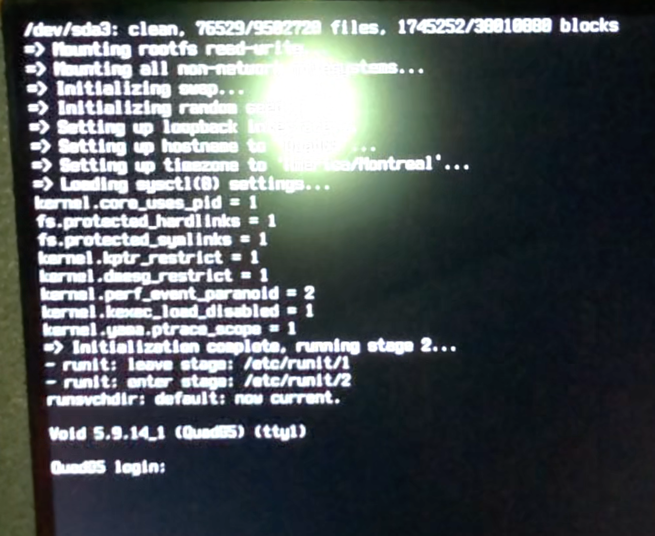

Did you get that modeline from cvt? have you tried using the fbdev driver? It looks like it either can't find the monitor you are using or can't put it into a usable state. Have you tried lower resolutions or color depths?
Thanks for your reply.
Yes, the Modelines are what I get from cvt.
I did find what I think is a much better description of what I am experiencing here. It describes as follows: "As soon as I boot up, I see the login prompt and then a black screen where LXDM should be. Switching to a TTY means I am yanked back to TTY7 in a few moments, and i am forced to 'sv stop lxdm' (I finally deleted the symlink in /var/service') and a cryptic error in the xinit logs saying 'no screens found'.".
Indeed, typing "sv stop lxdm" stops the screeen yanking me back to the blank screen every few seconds as I described in my first post.

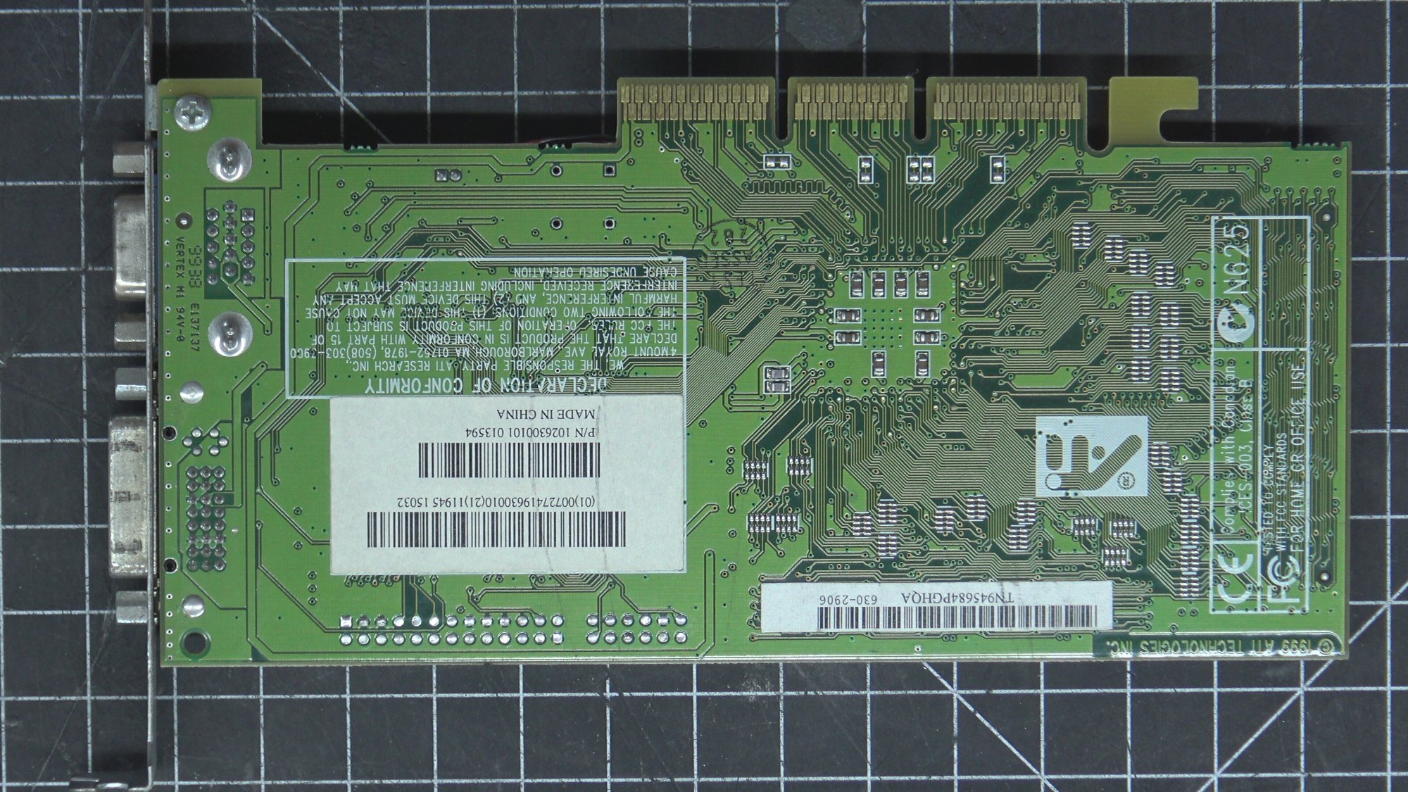

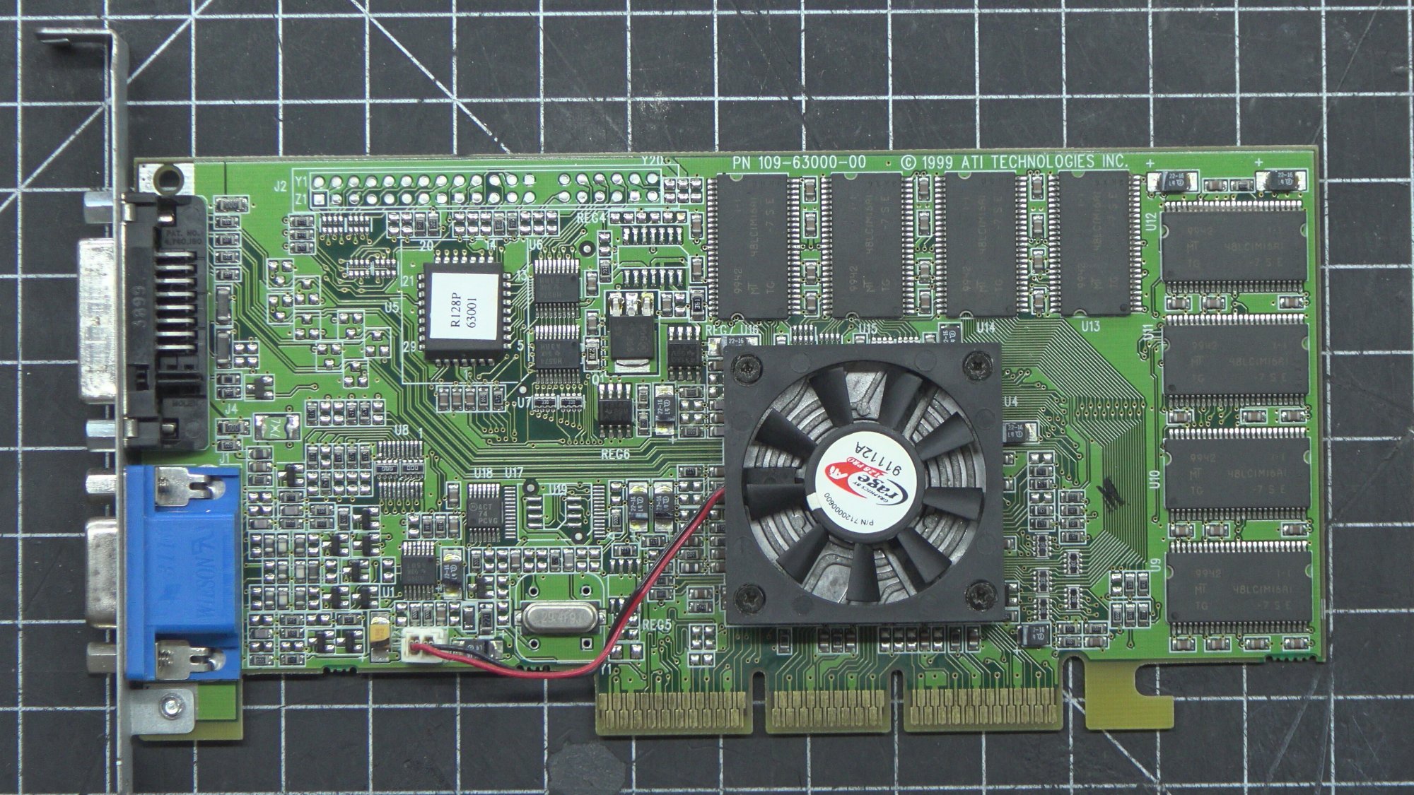

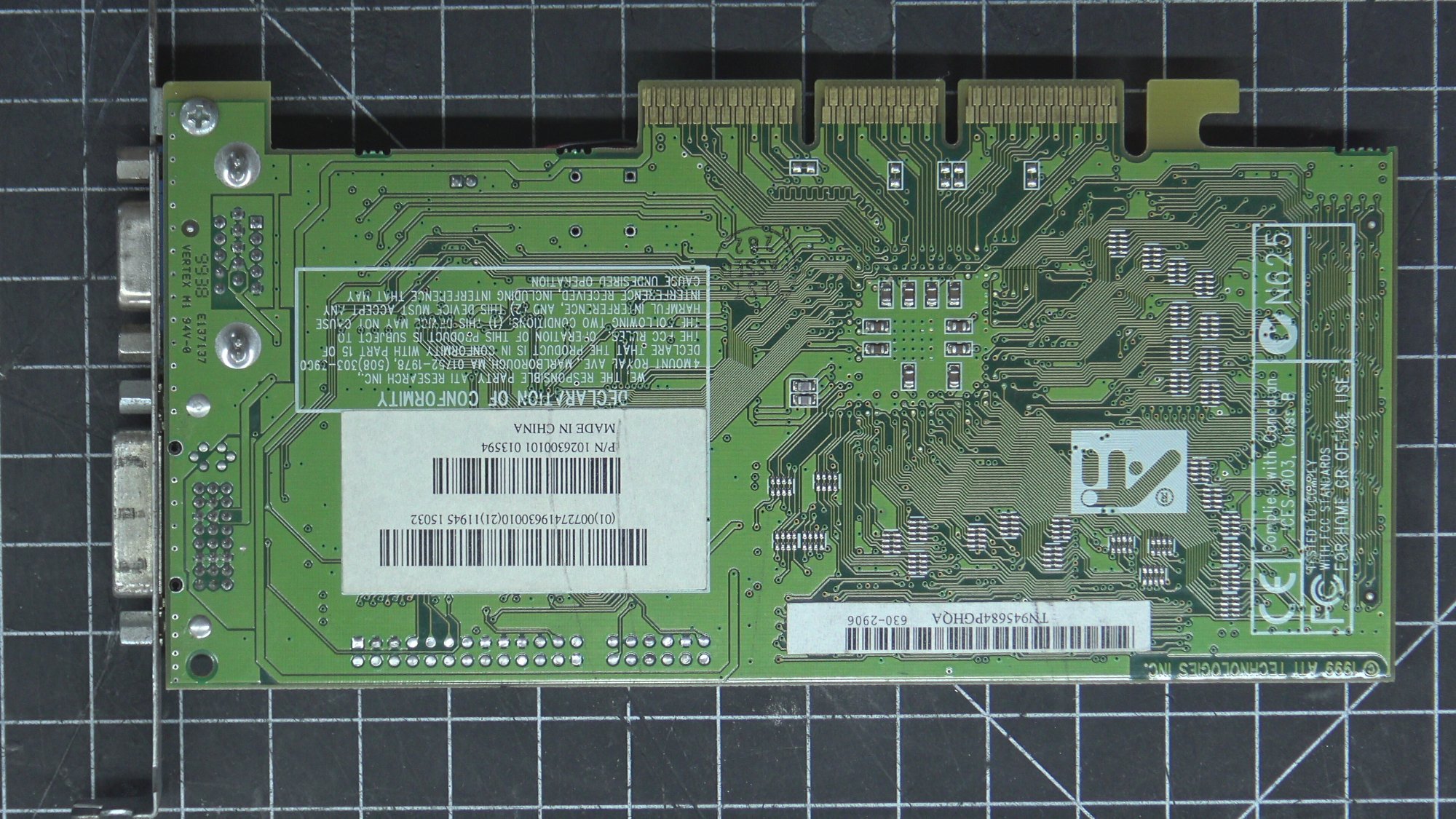

It would be great to get this AGP ATI Rage128 Pro working with Void, so I am still hoping for any suggestions, or corrections to what I am doing (I am very new to configuring Xorg).
I have a 9600 en-route which may clear up the need to get the Rage128 Pro it working (though reading the comments just above I wonder if the 9600 will also pose problems). I still have the GeForce fx5200 that the computer came with but nvidia isn't supported by MorphOS which I want to dual-boot into.

I have now tried just "r128" and it seems the same result as "xf86-video-r128". I'm pretty sure the fbdev driver is installed: at least the "xf86-video-fbdev" package is installed (the installation was from the latest xfce .iso). I have tried with different monitors with the same result, and also with the DVI port as well as the VGA port on the r128 card - no difference. My last xorg log only included lines with errors. I will include the whole xorg log in full below (Driver "r128"), followed by dmesg:

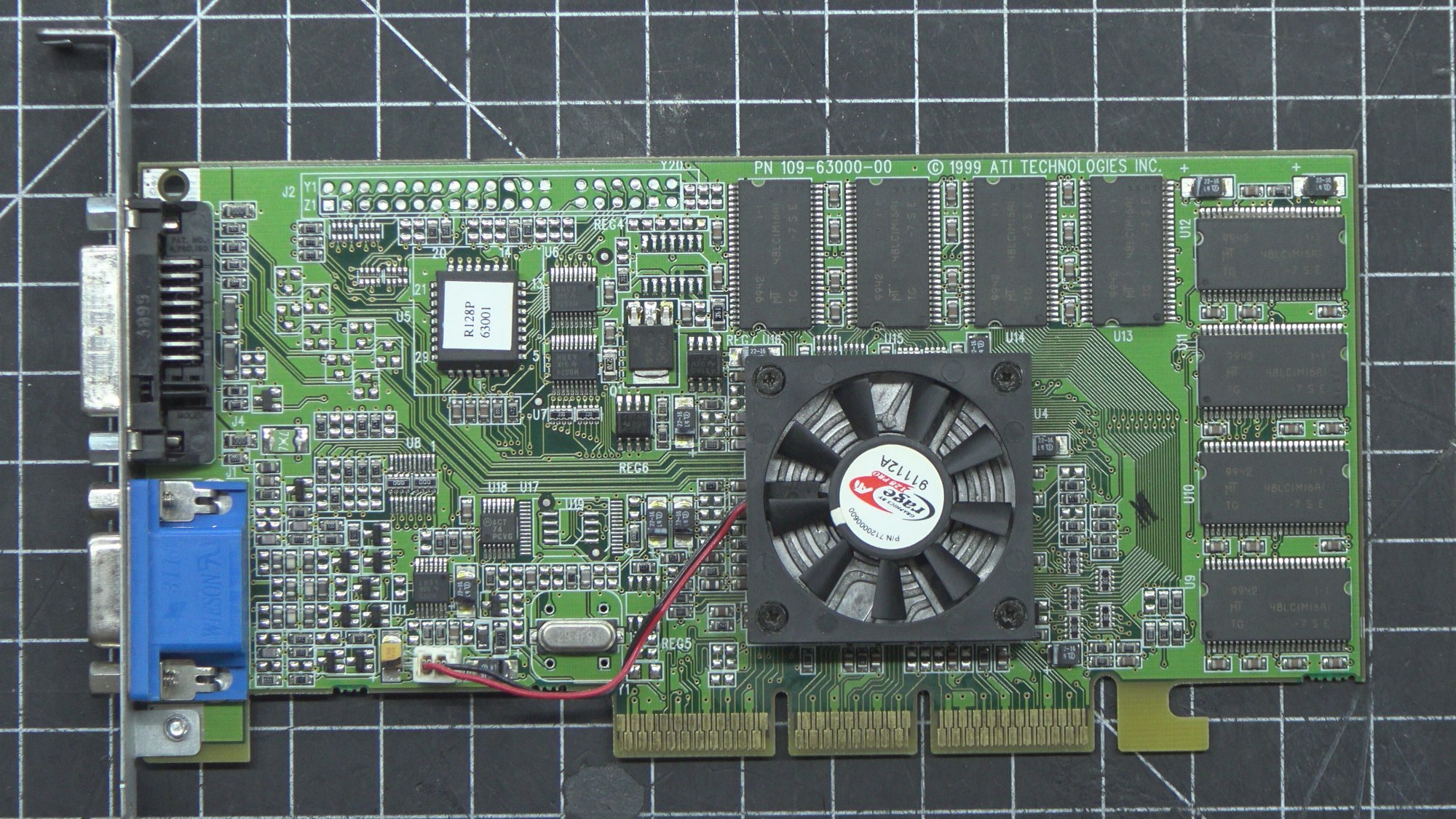

Maybe there are some hints in those logs? Attached photos of the card too incase of anything. Thanks for your help 🙂
Reactions: dextructor
It still seems to me that it either can't find the cards framebuffer (even though it seems to know about it) or it can't find a screen to use.

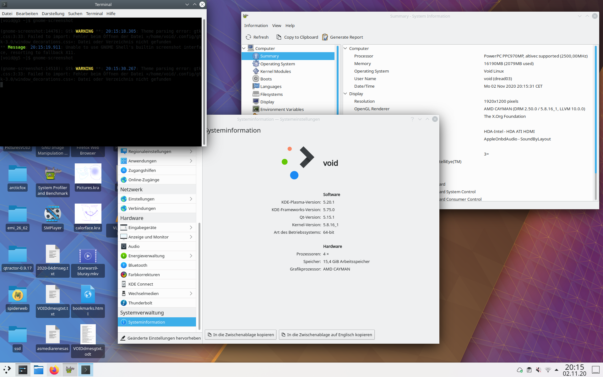

Anyone else have problems on the G5 with PulseAudio 14? When I update it, the only noise I get when sound plays is a static sound, and it gives no apparent error messages - no matter what I seem to do the the config. Pulse 13 works just fine.

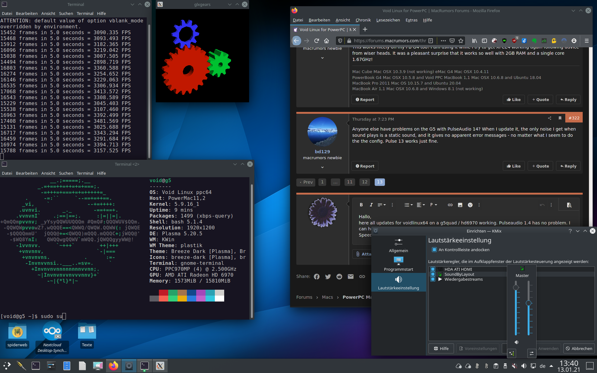

Hallo,
here all updates for voidlinux64 on a g5quad / hd6970 working. Pulseaudio 1.4 has no problem. I can hear onboard-sound.
Speed with Firefox 84.02 is ok, but colours (pictures and videos) still are not correct.

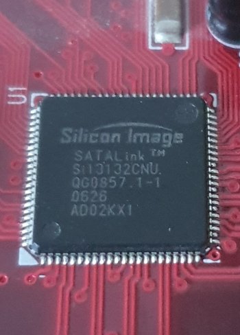

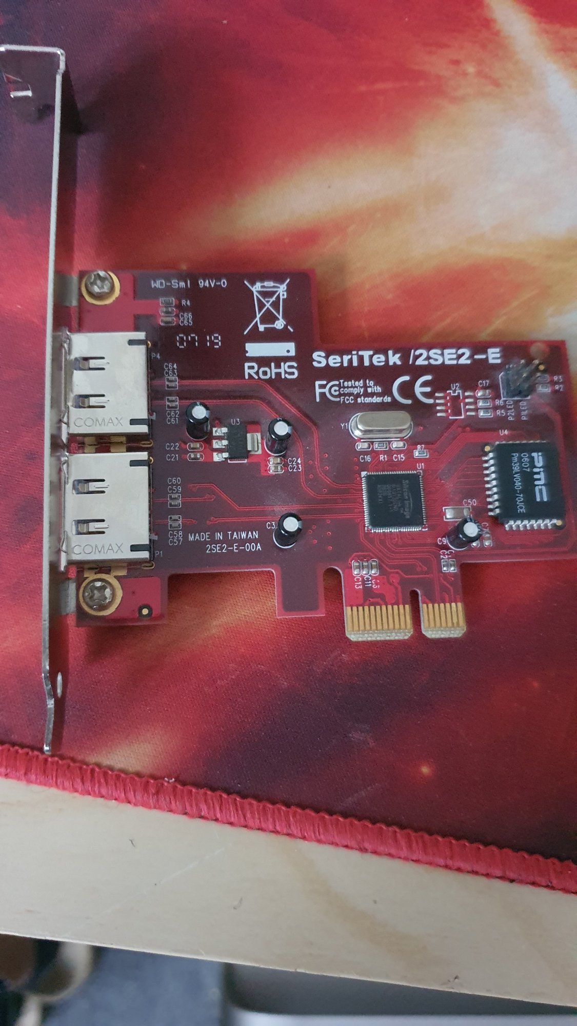

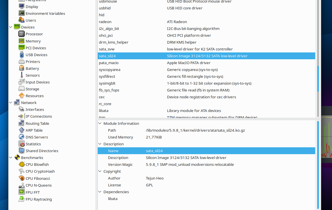

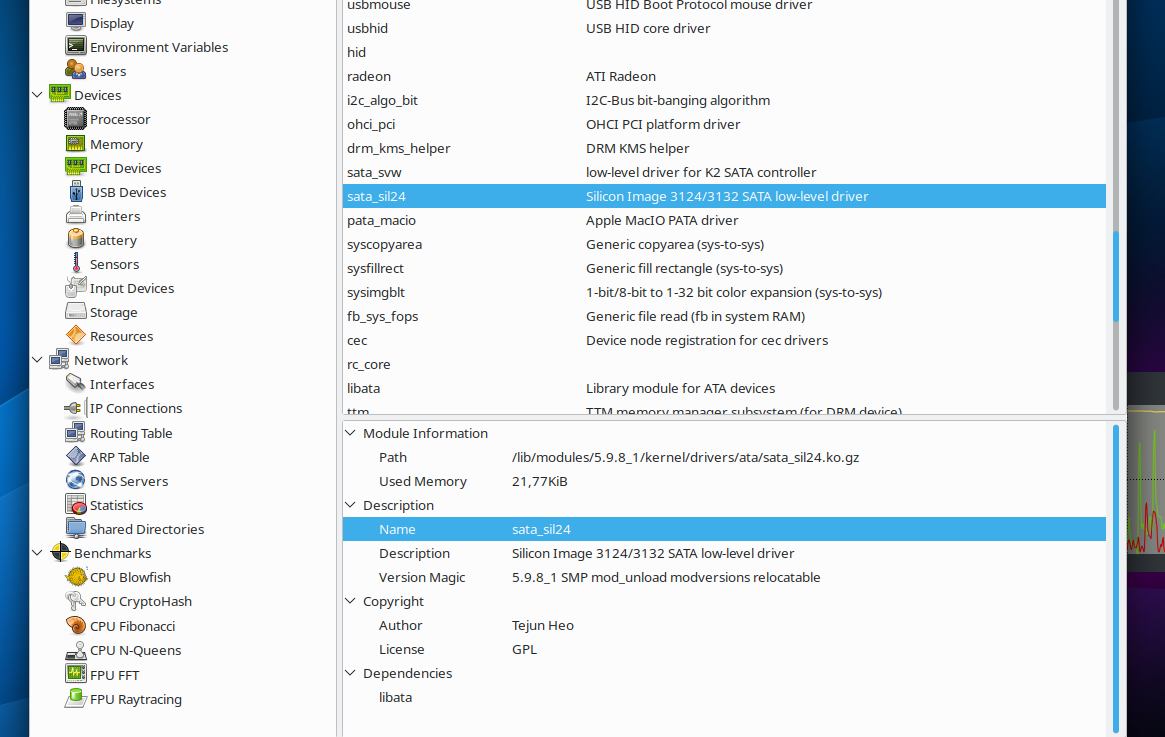

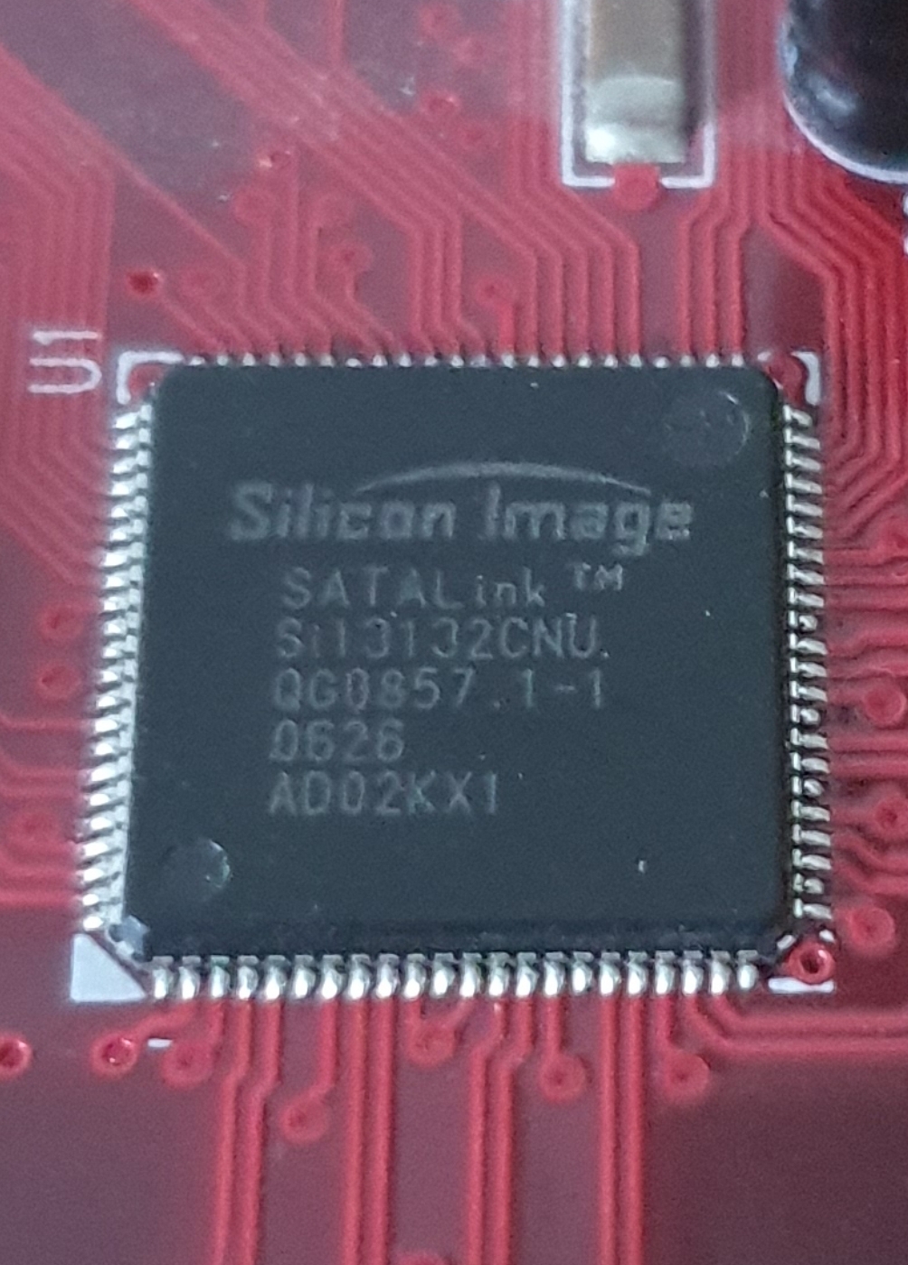

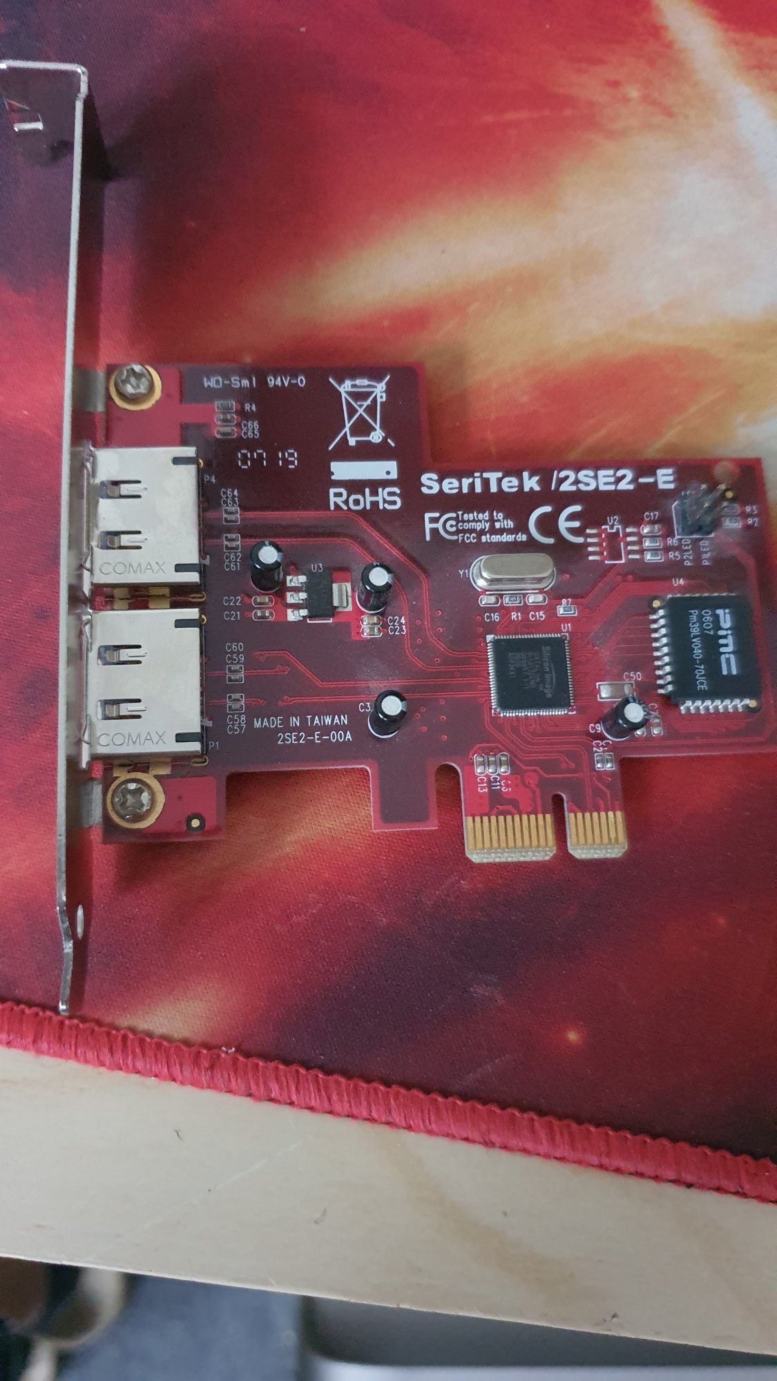

Maybe someone knows howto install this sata II /pcie card: Firmtek seritek/ 2se2-e. The card can boot a late G5 / osx. Are there drivers for this chip ?
Hey all! It's been quite a while since I've posted here! I recently got an iBook G4 second hand and I wanted to play with Void Linux on it. My main question right now is if I install a super base system (i.e. not install what the ISO has) and then once I have the repos up to date, would I simply type xbps-install kde or xbps-install etc and would it pull the proper dependencies like X11 etc? I've not used Void before, though I do use Funtoo on my AMD desktop, so I was wondering how XBPS works. Thanks in advance!
