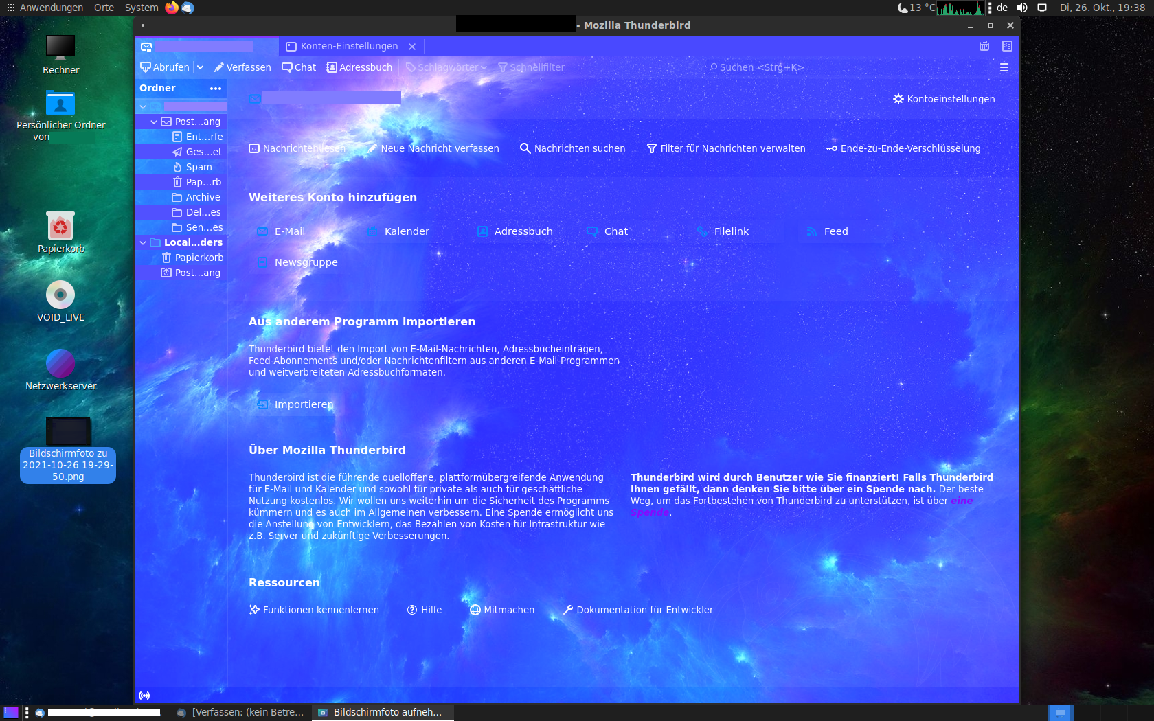

The new version of Thunderbird brings the ugly color bug.
To prevent Thunderbird from being updated during a system update
xbps-pkgdb -m hold thunderbird
Perhaps there is an other solution to fix the color?

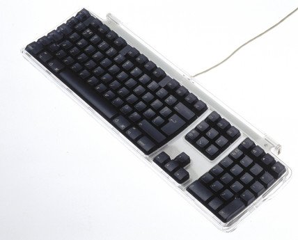

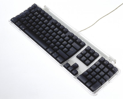

And: I changed keyboard language and now i´ve another problem: sometimes i lost the return and the space -key; i´v have to use SHIFT-key with return/space key, than it works.
Do i have to choose another keybord?
Looks like the same problem, i have at the moment. I see you are from germany, too. Perhaps a problem with the german key layout.
Have you found a solution for that problem?
Reactions: lepidotós
I also have it with US International with dead-keys, but having LibreOffice open seems to fix it for me.
I have tested different german layouts, all the same problem.
Tested 2 different keyboard types
No idea, but i will test the libre way, until i get a better solution.
I have/had the same problem with en-us layout. Figured it out. Make sure the "num-lock" key is enabled and the problem goes away. At least for me anyway.
Cheers
Did you installed numlockx for that, used keyboard Layout options, or press NUM manually?
I have installed numlockx. I will report after testing.

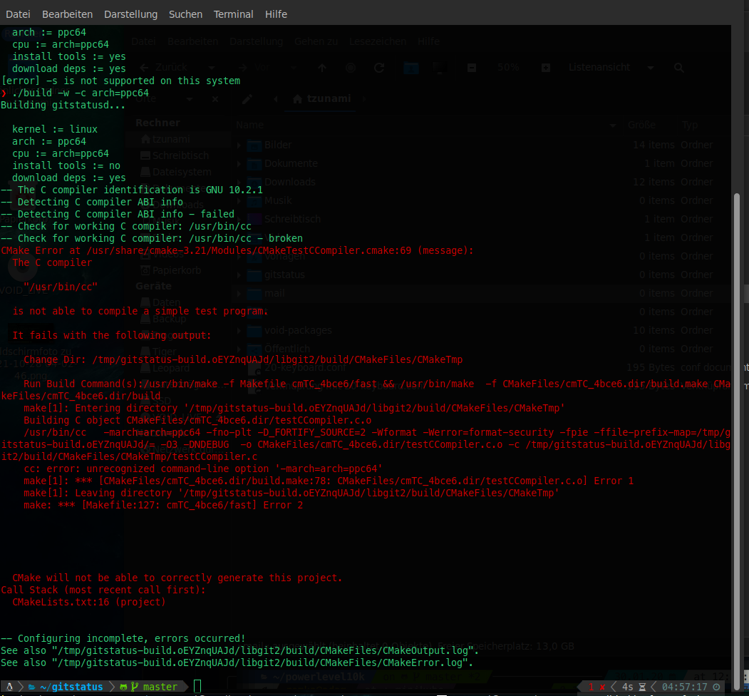

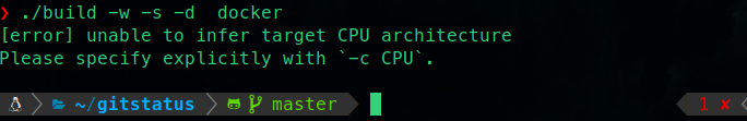

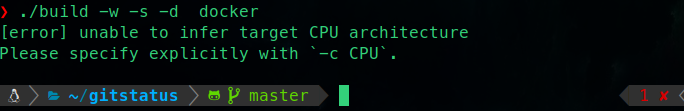

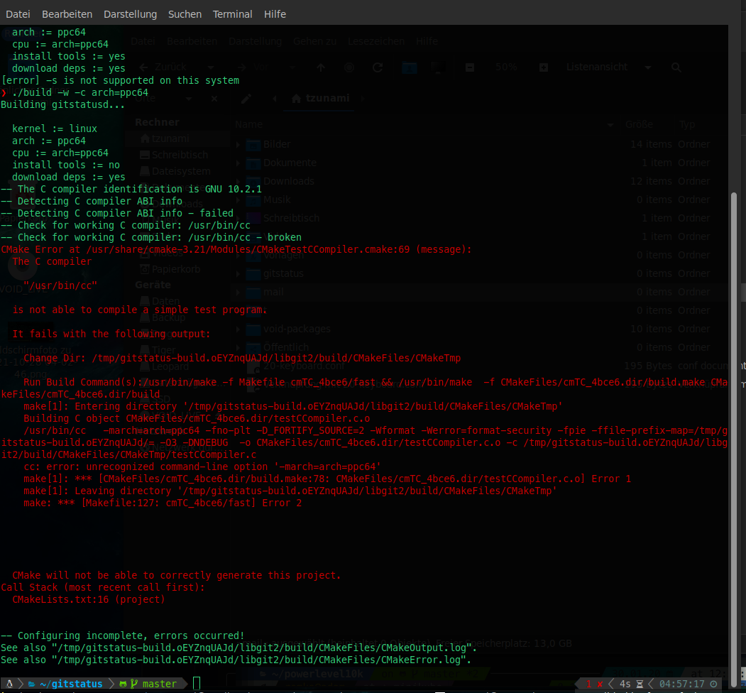

Anyone who has running "Oh My Zsh" with "powerlevel10k"?
powerlevel10k is runnig, but i must compile gitstatus (without the terminal gives an error. you can disable gitstatus, but it would be nice when all is working)
I've followed the gude but i get this error
./build -w -s -d -c ppc64 docker
./build -w -s -d -c powerpc64 docker
./build -w -s -d -c docker
All give me the error:[error] unexpected positional argument.
Any ideas?
@wicknix : Looks like numlock is working, no problem since install numlockx and ad it to my lightdm, thanks 🙂

Yes, i have updated und in KDE systemconfiguration i choose German in Region and in keyboardlayout .de language.

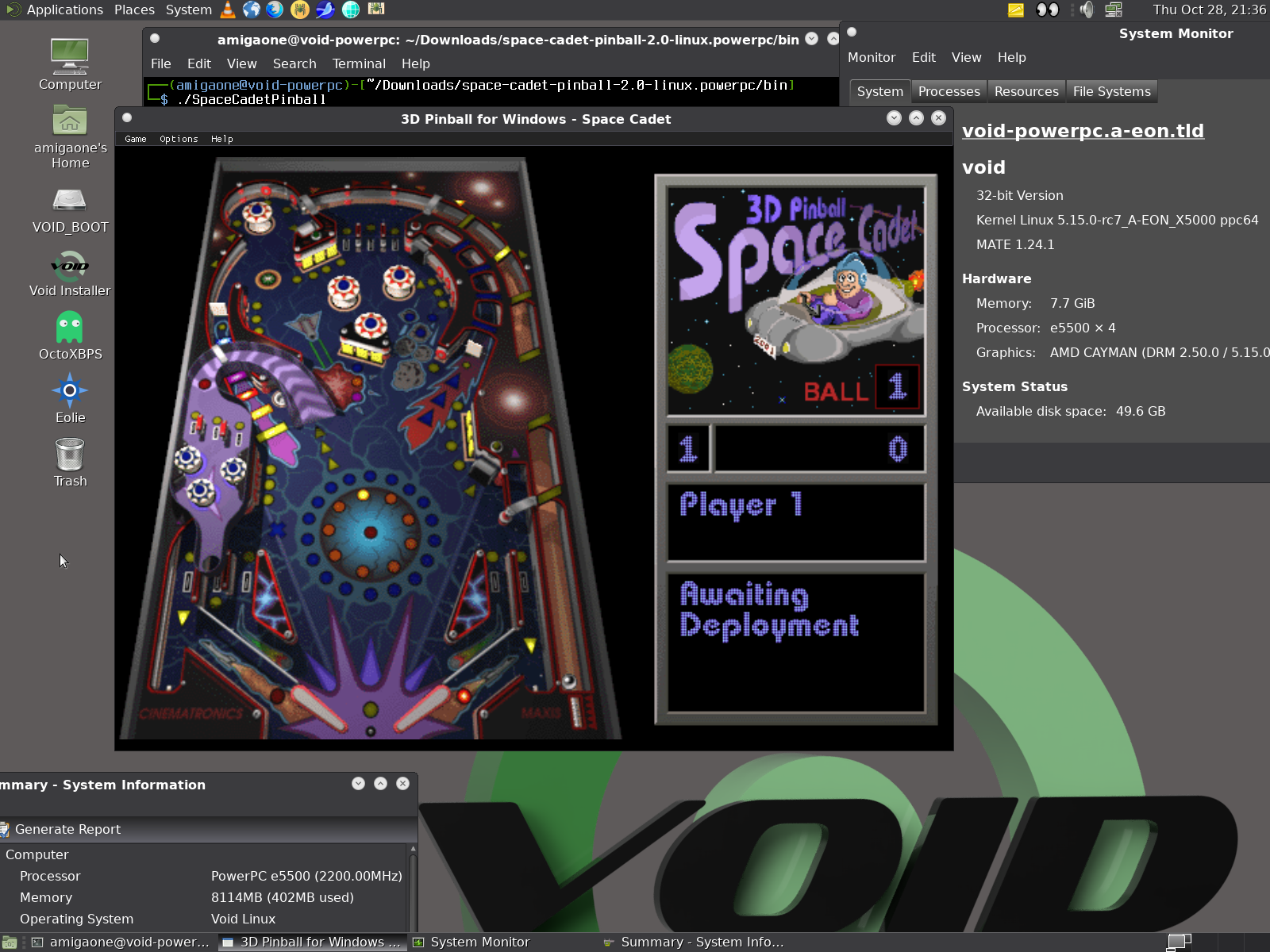

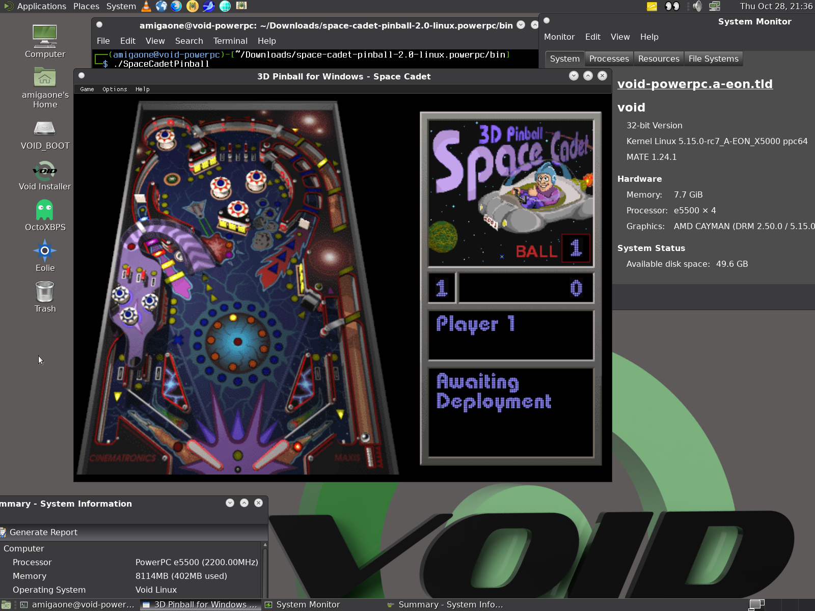

Hi All,
Do you still know the old pinball game from the Microsoft Windows Plus! package for Windows 95? It was also available for Windows NT4, Windows 2000, and for Windows XP.
This game was decompiled and rewritten for Windows, Linux, macOS, PS Vita, Nintendo Switch, webOS TV, Nintendo Wii, Nintendo Wii U, and for Nintendo 3DS. It works also on Wine.
Fortunately I was able to backport some big endian patches from the Wii U port to the official port and after that I was able to compile it for Linux PowerPC.
It works very well on Void PPC and I have a lot of fun with playing this game! 🙂

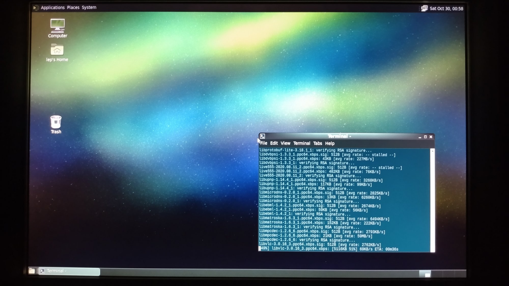

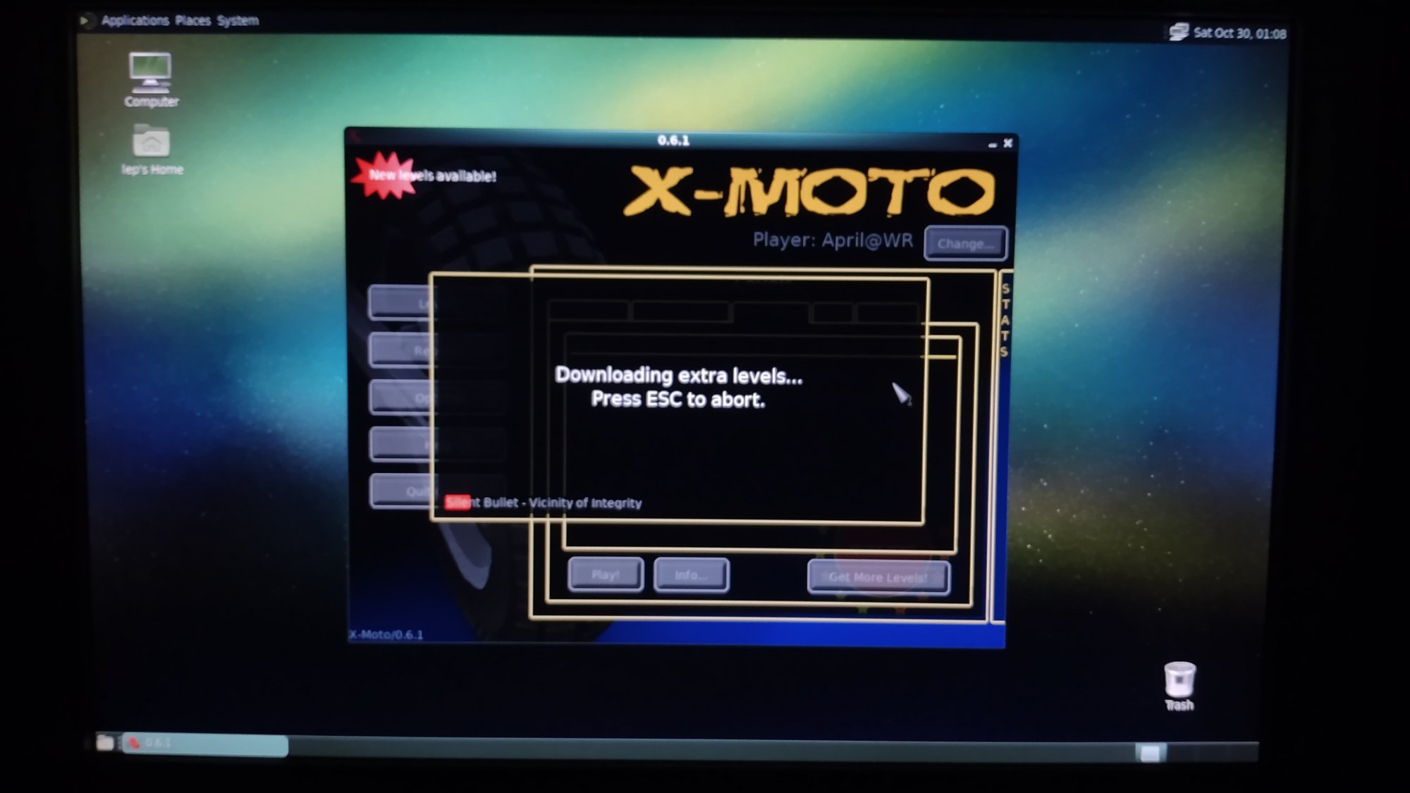

Got MATE working, it feels like home. Gnome 2 was my first DE ever, so I'm always happy to use it, even when I play around with other DEs.
