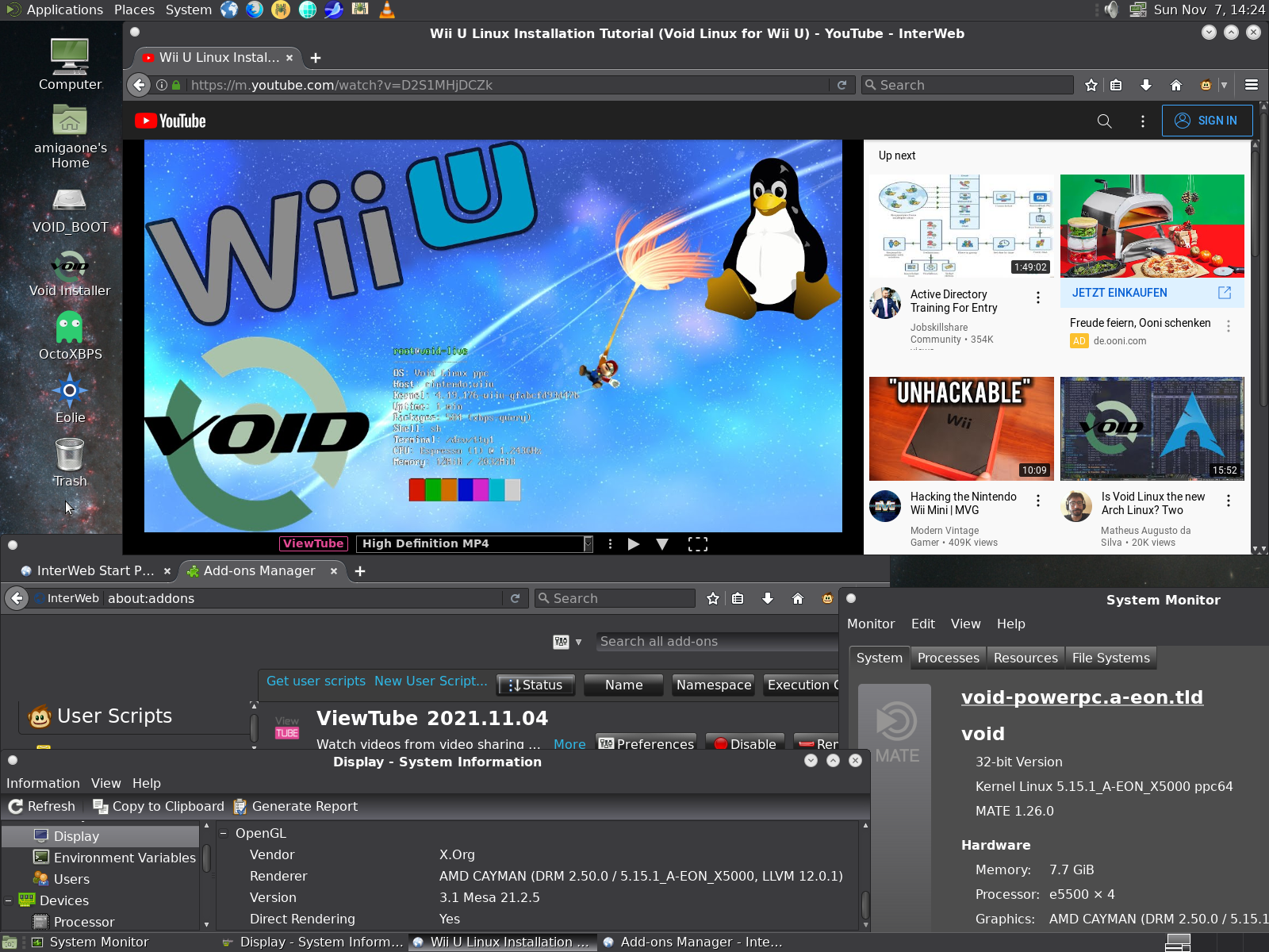

Void PPC with the new MATE 1.26.0:

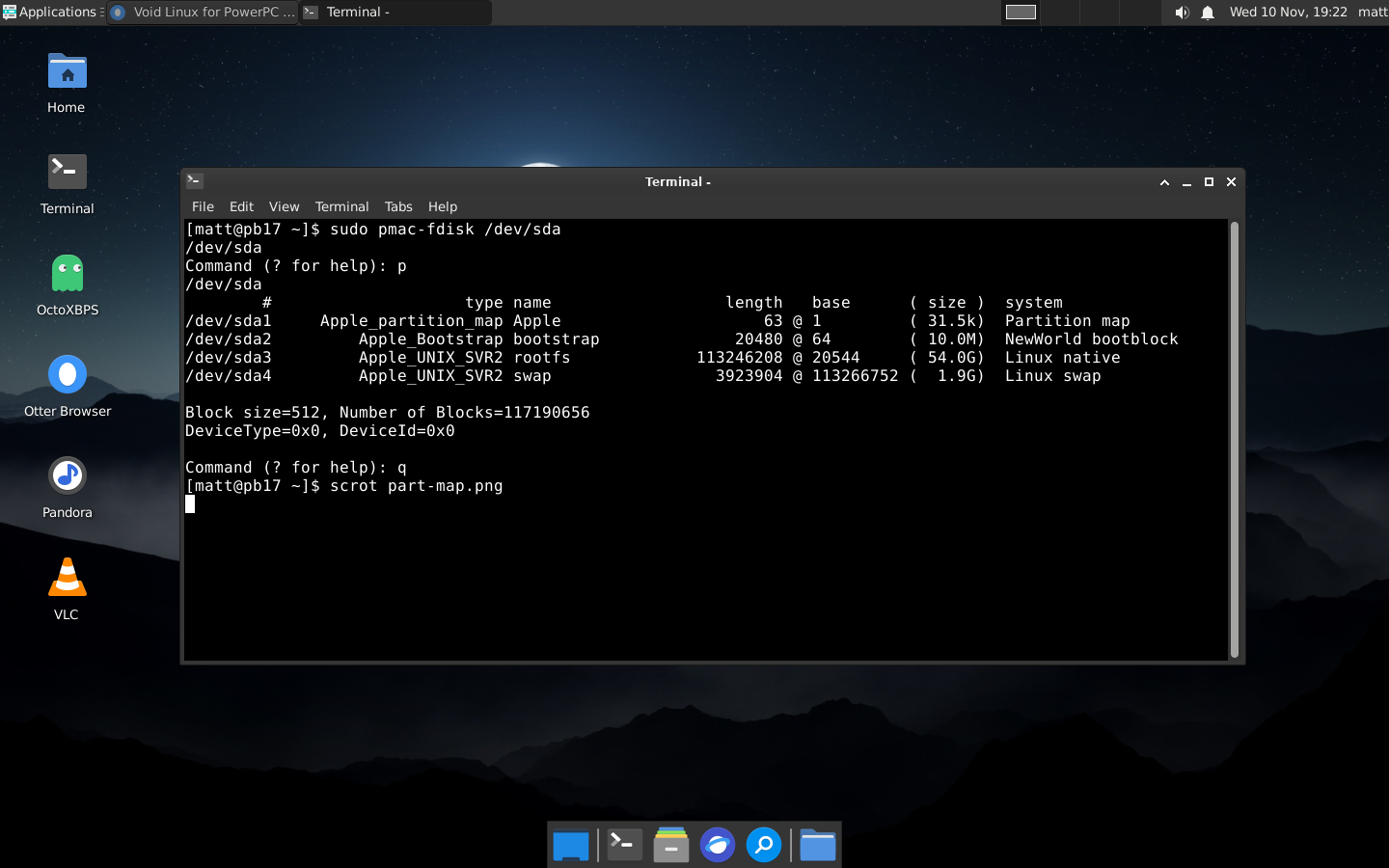

I do see your problem though. You are missing 1 partition. See attached.
As for where to install grub, use the bootstrap partition.
Cheers

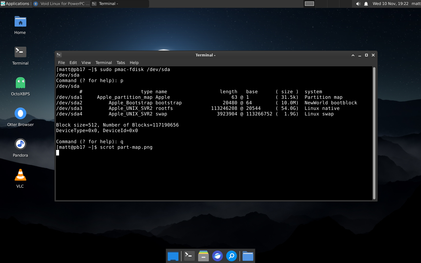

On my machine 'name' and 'type' of /sda2 is not the same as yours (i have type 'Apple_UNIX_SVR2', and name 'Apple_Bootstrap'' ! So that is one thing that is wrong at my machine
Then it must perhaps be that the 'b' is missing in my example of what i entered. The problem is that 'b' asks for "first block", and i have no idea what value to write there?
C 2p 10M Apple_Bootstrap Apple_Bootstrap
Test C as a capital letter

Thank you, yes, i think that did it!
