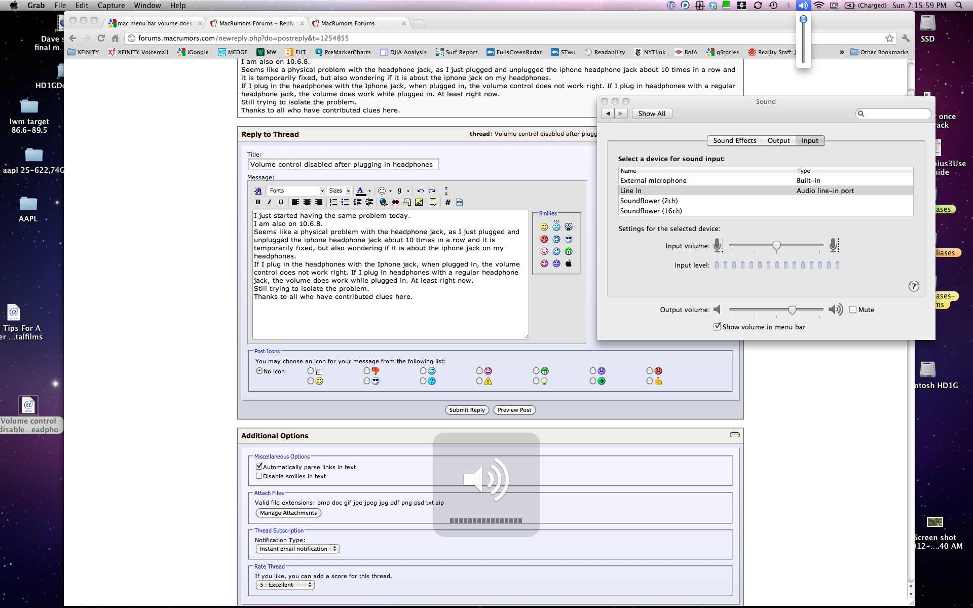

Volume control disabled after plugging in headphones
I just started having the same problem today.
I am also on 10.6.8.
Seems like a physical problem with the headphone jack, as I just plugged and unplugged the iphone headphone jack about 10 times in a row and it is temporarily fixed, but also wondering if it is about the iphone jack on my headphones.
If I plug in the headphones with the Iphone jack, when plugged in, the volume control does not work right. If I plug in headphones with a regular headphone jack, the volume does work while plugged in. At least right now.
Still trying to isolate the problem.
Thanks to all who have contributed clues here.
I have attached the screen grab showing the 3 volume methods all at different levels. This was taken with Iphone headphone plug plugged in.
