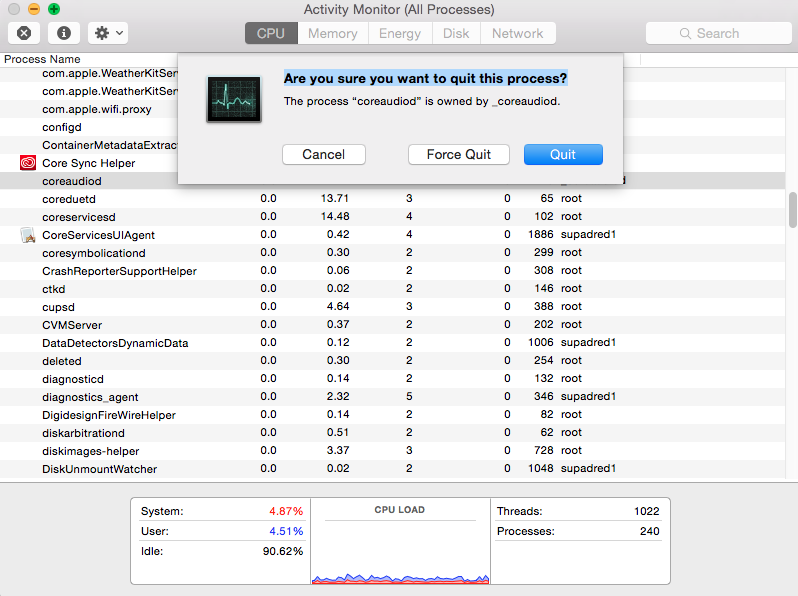

Hi all, I'm a newbie and just came across this thread whilst looking for something else, so I hope I'm not 5 years too late with the remedy to this infuriating problem.
I've found what works instantly 100% of the time is to follow these steps:-
1. Open to your 'Utilities' folder
2. Open 'Activity Monitor'
3. Make sure you're looking at CPU activity, so Click on the CPU tab if you need to
4. Select 'Coreaudiod'
5. Go to the top left hand side of the window & click on the 'X' which forces the process to quit (not the red x which closes the window)
It will ask "Are you sure you want to quit this process?" so click on the blue highlighted button 'Quit'
This will reset your Core Audio driver and immediately give you back control of your volume controls.
This is the only workaround I have found which has immediate effect, however until Apple themselves acknowledge and permanently fix this inconvenient problem, it will keep on occurring everytime a jack is plugged in & out of the headphone socket. On occasions, it may take a minute or two for the driver to fully reset and you may find initially that when previewing a piece of audio that it doesn't play, so if this is the case; just be patient and wait for a minute or two as I said previously or you can prompt it by activating iTunes or whichever music program you're using.
Hope this helps.
