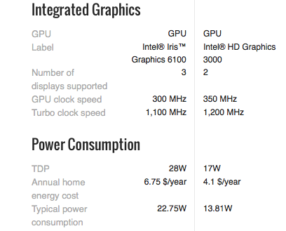

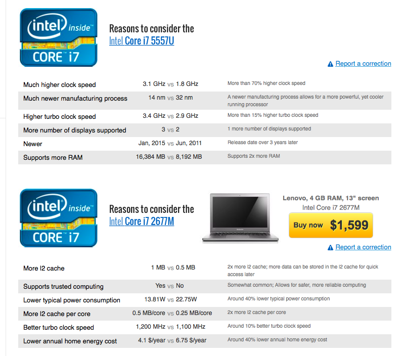

Currently I own a 2011 Macbook Air 13" top spec. I'm considering the new macbook pro 13" and planning to max the specs. I just did some research on the processor and iGPU and the comparison some what bothers me.
Why does the new Broadwell has lower L2 cach capacity + speed? And the iGPU has a slower GPU+Turbo clock speed? I always thought higher is better 🙁

This is the problem with just comparing specs. Your processor is limited to 17W of power, while the new one has 28W allowance. This means that it will be able to stay at Turbo speeds for much longer, while yours will throttle a lot when it overheats.
The same goes for the graphics. In reality, yours will be stuck most of the time at 350 Mhz because of the low thermal allowance, while the new once wil turbo to 1100Mhz much longer. Also, a spec you're missing: the new Iris 6100 really makes a difference on the number of execution units: 48 vs. 12 on the HD3000. That's 4x better graphics performance. So the 50Mhz difference in base clock speed is trivial.
I really have no idea about how the Intel CPU evolves. I understand the execution unit part. However,intuitively thinking, shouldn't an upgrade have at least the same clock speed+capacity and have higher allowance? Or same allowance with better clocks peed + capacity? Loading more power into a processor for longer turbo and allowing it to withstand more heat hardly sound like an upgrade to me, considering one is from 2011 and the other 2015.
One more question, if the iGPU has higher power allowance and turbos longer but is lower in clock speed. Is it more or less power efficient?
Don't trust random third party websites. the i7 5557U has 4MB cache.
Clocks speeds alone are not a measure of power or speed. As was pointed out below, the newer iGPU has 4x the execution units, i.e, almost 4x the graphics performance. Also over 50% improved CPU power (geek bench). I wouldn't put too much weight on the power consumption, the CPUs run in low power modes most of the time, and newer machines tend to save even more power there.
(Also if you want to be precise, since a year or two, the CPU die has much more infrastructure on it than before, i.e. comparing the TDPs of the CPU alone doesn't make sense).
You are moving from an Air Mac to a Pro Mac. The Pro line has a different class of processors (the 28W type) while Air is at 15W. These are not directly comparable. Air is more energy efficient, the Pro is more powerful. If you want the best battery autonomy, you have to stick with the Air.
It's hard to separate GPU efficiency from the CPU on an integrated chip. The bottom line is: Core-M at 4.5W is the most power-efficient (Macbook) followed by Broadwell-U 15W (Air) and Broadwell-U 28W (rMBP 13). Performance goes the ther way around (Macbook is the slowest).
