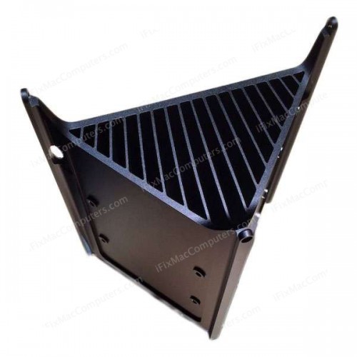

The iMac Pro's cooling is designed to cope with a single high-TDP GPU -maybe not as high as what the PC OEMs are offering, but still a fair bit more than what's in an iMac or Mac Pro right now.
I don't know where you get this info, but seems quite impossible to me.
The nMP is driving one CPU and 2 GPU, each GPU D700 is literally a downclocked 7970, nothing close to a low TDP GPU (the original 7970 is 250W TDP).
The iMac Pro even though can go up to Vega 64 (standard 295W TDP). I am 100% sure it will be downclocked like the D700. At the end, I don't think one Vega (iMac version) has higher TDP then 2x D700.
Also the nMP's fan can almost stay idle all the time, and none of those CPU / GPU will reach 100C like the iMac does. Even though the iMac pro's cooling system is improved, but it's just roughly improved proportionally to its TDP increase. That mean, cooling ability per TDP hasn't change. In this case, it means we can roughly using the current iMac's cooling ability as a reference. Which means, it's bad. Or much worse than any Mac Pro.
By considering both the nMP and the iMac Pro are using 500W PSU. I am sure the nMP's cooling system can handle only one higher TDP GPU, and most likely do it better than (if not much better than) the iMac Pro. Just Apple didn't give us this choice.
The MP6,1 is 450 watt, even worse. (As in "the Imac Pro is 'bad', the MP6,1 is 'worse'".)
The MP6,1 "thermal core" is designed for one higher wattage CPU, and two lower wattage GPUs. Very asymmetric.
If you put one high TDP GPU on one of the short sides - the other short side goes to waste. It can't handle a single high TDP GPU.
Oh, I miss read that's 450W + 50W, but you are right, that's just 450W PSU.
Anyway, isn't that the thermal core a metal (thermal conductor)? It doesn't matter which side in contact with the thermal source. It should able to draw out the same amount of heat (obviously, any side is large enough to allow the GPU make full contact). It's just a shared heatsink. If the other short side will be wasted, then all the tower heat sinks on PC would not work well either (because there are lots of surface that are not in contact with the GPU / CPU).
