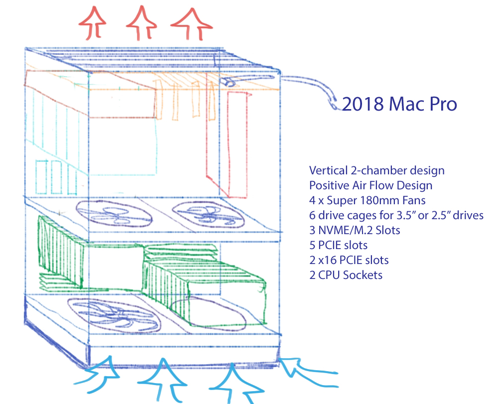

Sort of like this?
This is my more "conservative" concept, redoing the classic Cheesegrater Mac Pro... and making it a vertical air chamber where cool air is suck from the bottom and vented upwards, following natural laws of convection...
The main PCB or Logic board is vertical on the left side. And, then on the bottom chamber where there are 4-5 PCIE slots, the slots are connected via a proprietory connection from the main logic board to allow GPU's and PCIE cards to be inserted down flat (slots are perpendicular to the horizon or tabletop)... and the bottom part is open, except for the slots so there is airflow (not sure if that is clear on the drawing or this explanation. But, picture PCIE slots only occupying the bottom, if that makes sense....)
The top chamber is where HDD/SDD storage can be installed using standard 3.5" or 2.5" storage... similar to cMP except there are six slots instead of four....
Further storage expansion is available in the bottom chamber on the main logic board where 3 NVME/M.2 style SSD's can be installed...

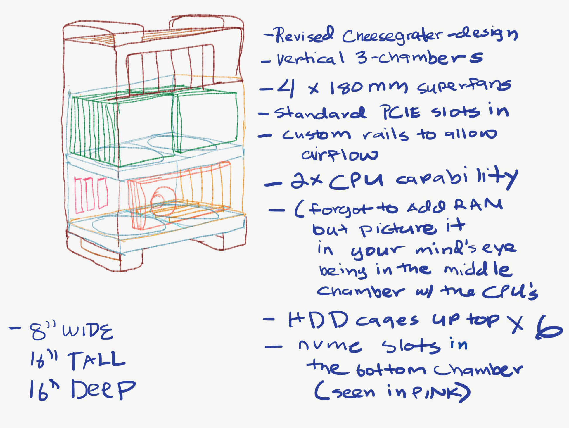

What would a "2018 cMP" really be?
Ummm... something like the drawing I did in post #7179, maybe?

I did another revision from my drawing on post #7179....
I made it even simpler, I think....
The main thing about this design is not the boring box, chamber, or even positive airflow design... but, the materials and build quality that Apple has done with their unibody design in notebooks but in a bigger small midtower case. The whole thing is made of solid, thick aluminum on all sides. There is a feeling of "this thing will last forever" in it. To compare, the thickness of the aluminum is 4x thicker than that of the cMP cheesegrater one. So, those bent legs will be harder to do in this case's case....
