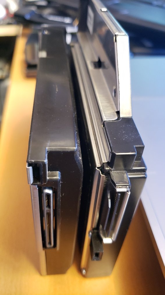

...from what I read, Lombard and Pismo modules are not compatible with the Wallstreets- is that true?
This is correct. They will not physically fit. Compare the ZIP drives for the Wallstreet/PDQ to that of Lombard/Pismo:
Both the size and connectors are different, though I assume they are using the same ATA standard for communication.
