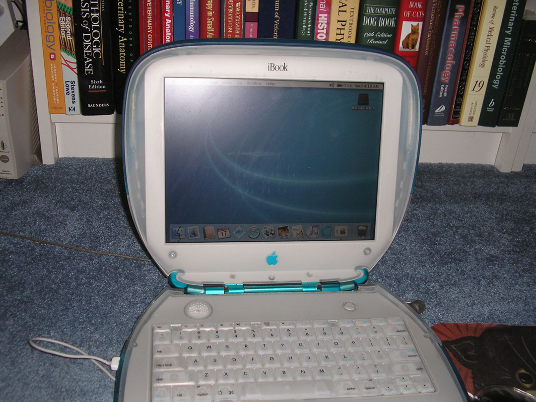

I did it!
So, I know this won't mean much to most of you, but you have to understand -- I'm a total hardware noob. I used to work at a Help Desk, but all of my support was on the software side -- the most I'd ever done inside a machine was swap out the ram.
Anyway, using the guide linked to in this thread, I opened my iBook, took it apart, got to my old 3 gig HD, swapped it out with the 60 gig HD California suggested and then installed OS X. I had some trouble installing -- there were a few moments where I thought I killed my machine -- but sure enough -- it works! Well, I killed the trackpad. But still! Oh. And I have two screws leftover. God knows where they were supposed to go.
What a testament to Apple -- a seven year old laptop now running a fairly contemporary OS in a beyond functional way.
