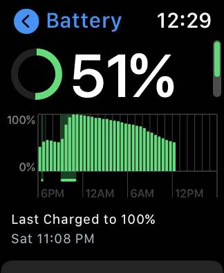

I’m still on watchOS 7.4 on Series 5, but battery has gone to **** recently. 51% at noon, so 13 hours later. AOD is turned off as well. Only thing I’ve done today is go on a walk.
