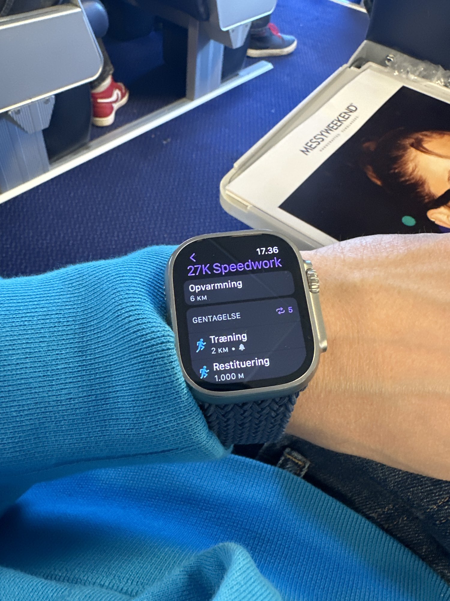

Great points ! Would love the intervals to be created on the phone - I change them every week at the moment after a program from my coach

Just editing them from my phone would be fine. Actually like preparing next days big sessions, but a bit easier on the phone
