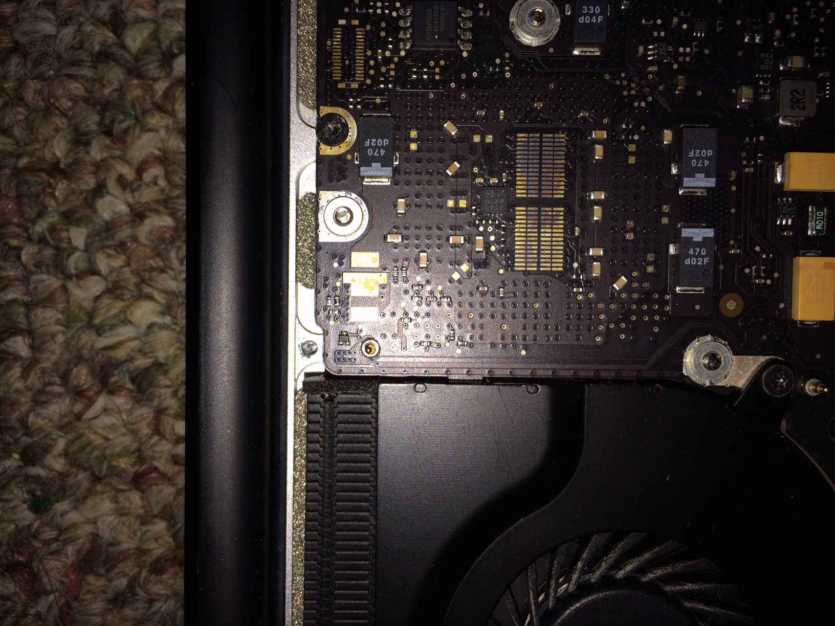

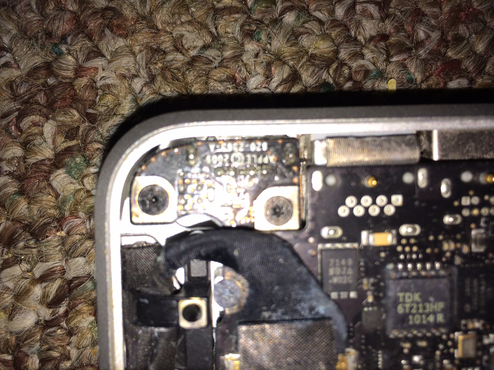

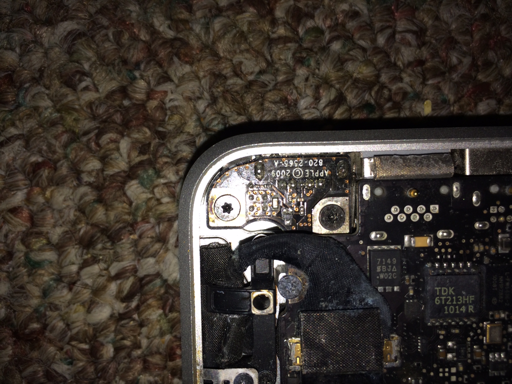

I inheritated a broken macbook pro model a1278. when i plug the charger in it lights up orange then dims to a green after a minute. the battery doesnt charge and it doesnt power on. I opened it up and I think this looks like water damage not quite sure. Figured ill have to replace the logic board but thought id post photos before hand.

Definitely looks like water damage. I would first try to reset the SMC but I highly doubt that it would do anything. Got a freebie and I reset the SMC and it fired right up.

I would start by removing the Logic Board and cleaning it with alcohol. Do not just dump it on but rather use cotton swabs and isopropyl alcohol to attempt to remove corrosion. Let the board air out and try it again.

DO NOT try to clean the Logic Board with it inside the Mac! That is quite possibly the worst idea. You are probably going to see more problems on the other side of the board in all honesty. Wait for the screw drivers to get here.

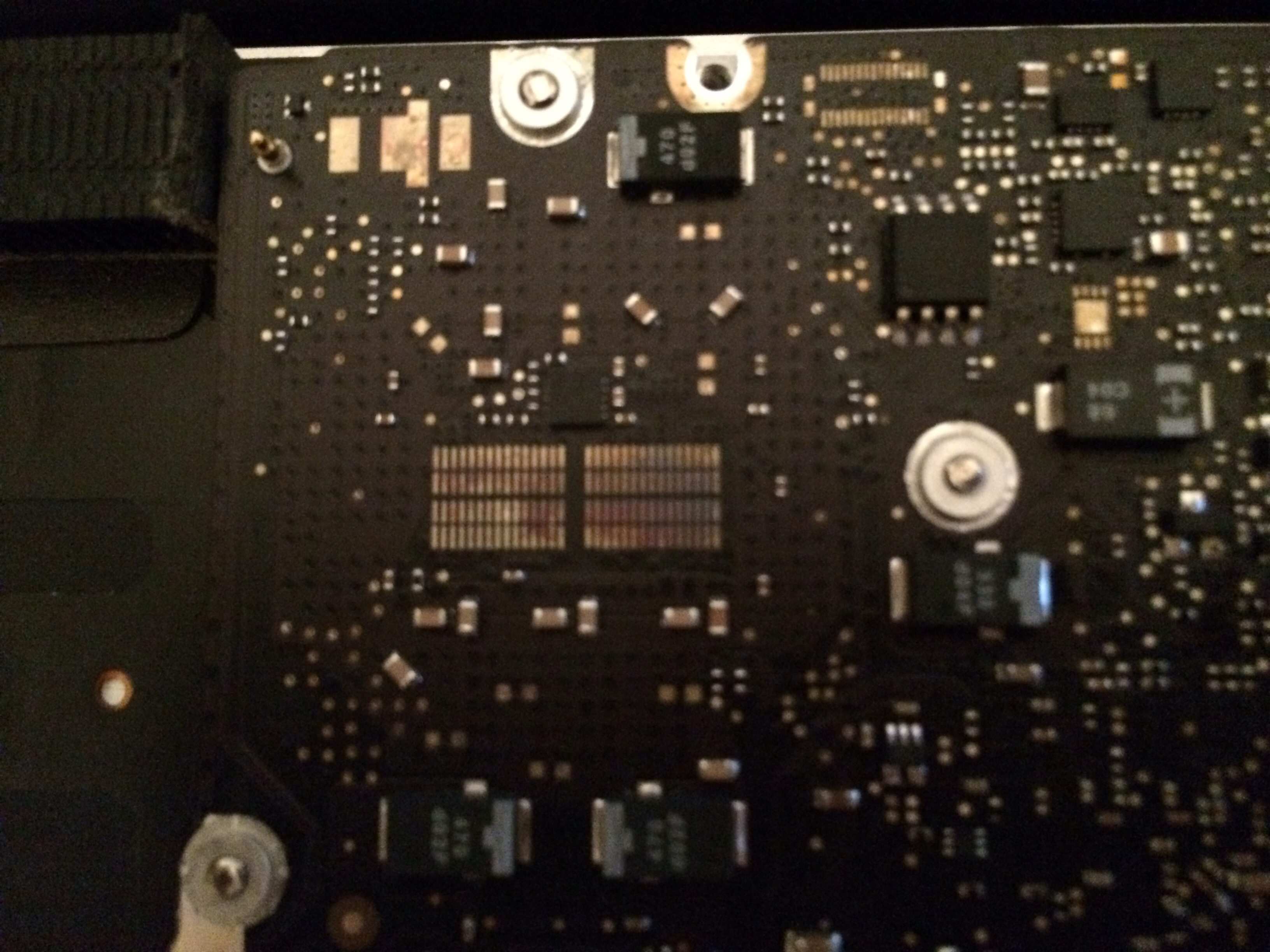

Pull the RAM out and check it for corrosion. Also, take an LED flashlight and shine it into the RAM slots and check for corrosion. Do not try to clean the slots themselves as the alcohol tends to do damage there. A mid-2010 logic board would be good, but worry about that when the time comes.

No problem. Don't be surprised if the whole other side of the board is covered in corrosion. If that's the case you may need to soak it (barring the additional parts) in the alcohol.
Note that some people will say my method works great. Others think it's a terrible idea. Provided you use caution, let things dry, and clean the parts fully after soaking (if necessary) there is no reason not to. It isn't like you are going to lose money trying this.

You definitely want to get the purest alcohol possible. Like high 90s in the percentage is good. Personally it is better to clean the board with out soaking but I have seen some people remove the whole board and put it in a container.
Depending on how long it sat and how many times it was attempted to be started while still wet could mean the board is fried.

i just took apart and removed the logic board then scrubbed it down with the alcohol. should i put it back together and toss it back in or?
