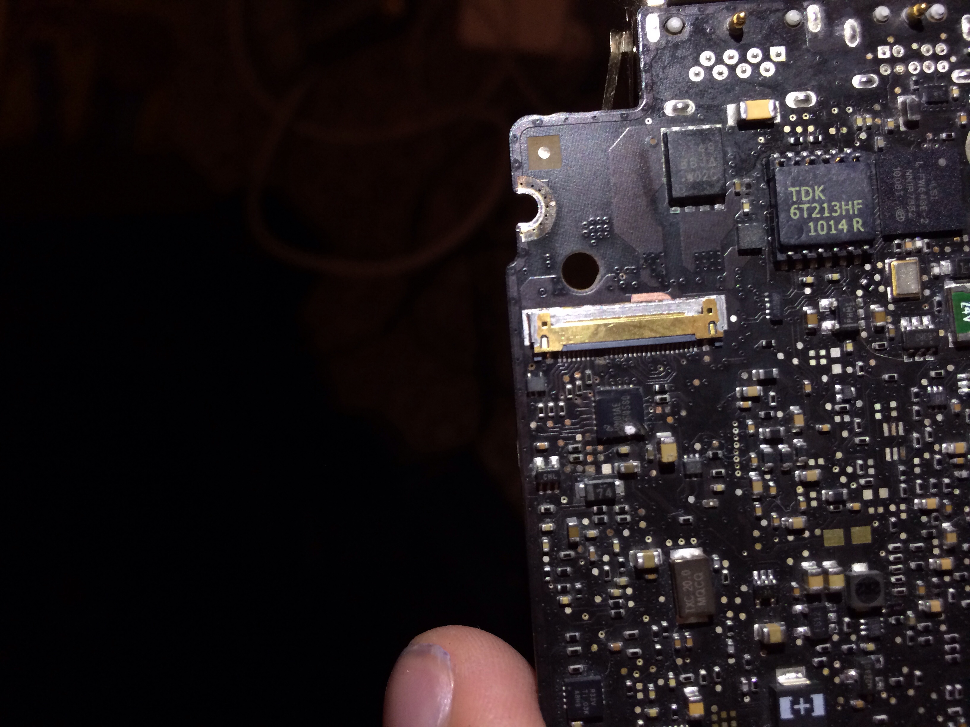

Also I think the video connector is damaged badly cause I noticed it looks corroded and it's this yellow color and the other one is silver

The gold part that is over the silver part is perfectly fine as far as I can tell in the pics. Paper is best but a regular towel will do no harm provided that none of the "towel fuzz" sticks to the board...
