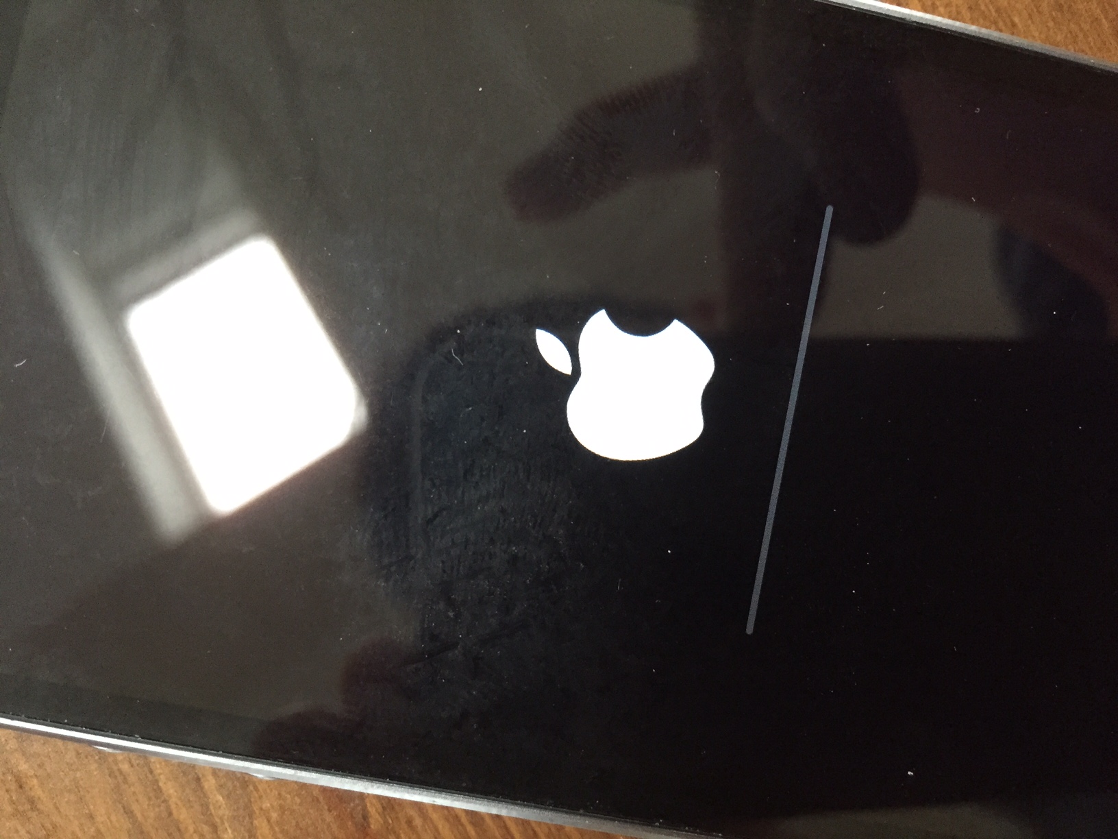

Hello,
My iPhone 5s fell into water. After that I put it into a bag filled with dry, white rice and closed the bag. Unfortunately, this procedure didn't help much – I still can't switch the iPhone on. If I connect the iPhone with iTunes, the Apple logo appears but the status bar underneath the logo doesn't proceed (see image). If the iPhone is not connected nothing happens if I try to switch it on.
Is it possible that the problem is that the battery doesn't work anymore? Does it make sense to invest in a new battery?
Does anybody have another idea what I could try?
Thank you very much!
Best regards
Franzik

How long was it in the rice? What made you decide it was time to take it out and turn it on?
Should be in the rice a minimum of a few days. Put it back in the rice and let it stay......Maybe it works in the end maybe not. OOW replacement is probably in your future.
3 weeks is enough for water to permanently corrode motherboard. Instead of rice you should've opened iPhone asap and remove motherboard, disperse water with alcohol so it could evaporate faster using hairdryer.
Nox5 is spot on, strip it down asap and clean it properly. Rice may work short term but you need to clean it properly
Okay, thank you very much!
Do you guys think that the battery might be still okay?
I had few water damaged iPhones and battery was never an issue but motherboard. Usually iPhone is stuck on Apple logo or charging battery logo but that battery is fine when transfered to a working iPhone.
When the iPhone is completely dead you might try new battery but not in this case.
Also 70% water damaged iPhones are not fixable and those that boot up have all kinds of issues like overheat,battery drain, camera flash issues etc.
Okay, thank you! I wouldn't worry about any kinds of issues as long as I would get the data from my iPhone which hasn't been part of the last backup. Therefore I would like to find out if it's worth investing money (for example in a new battery).
Forget about battery take motherboard out remove metal shields and stickers that cover chips on motherboard then clean the motherboard with toothbrush and isopropyl alcohol. Dry it put it back together and see if it boots up.
