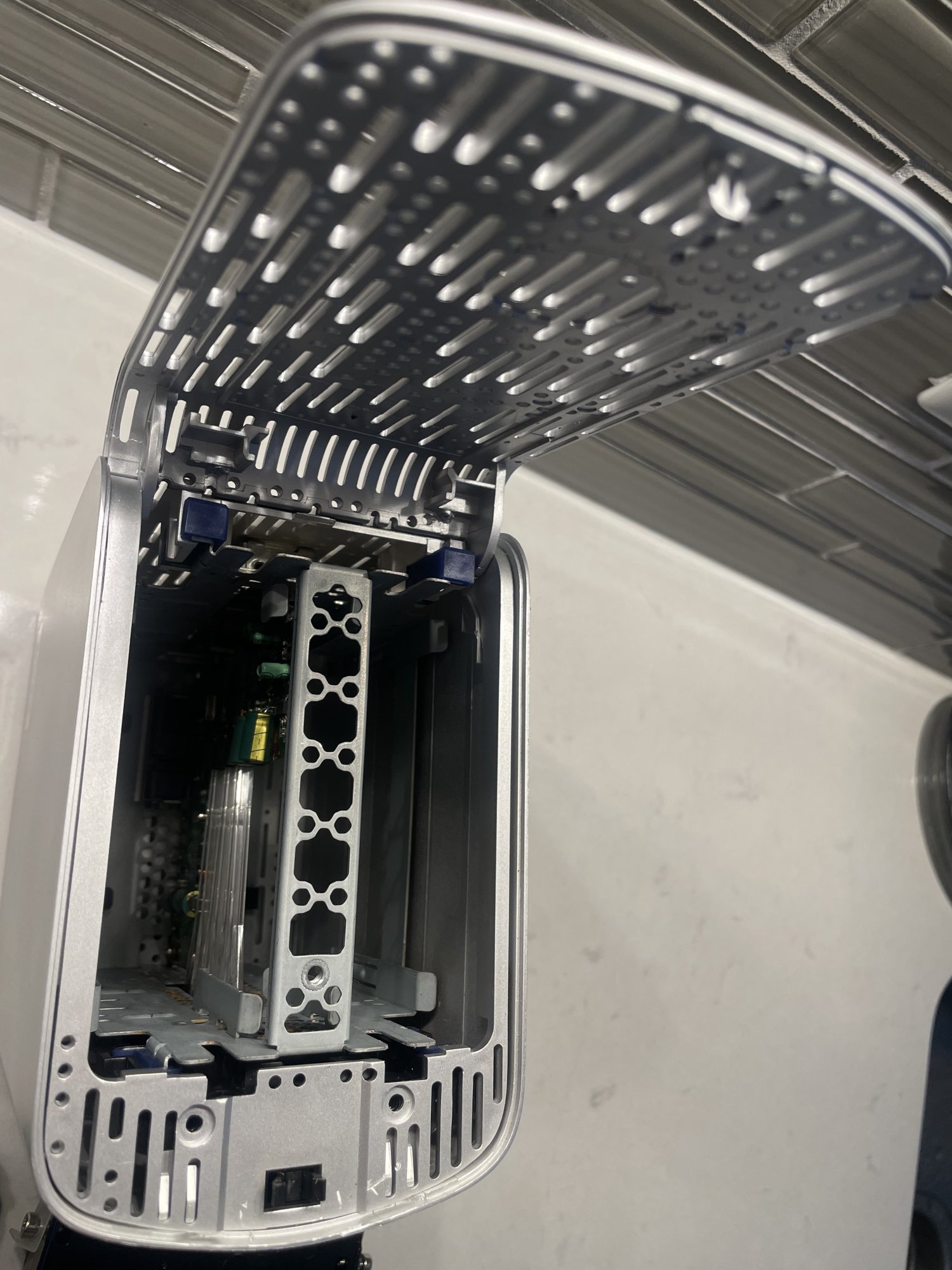

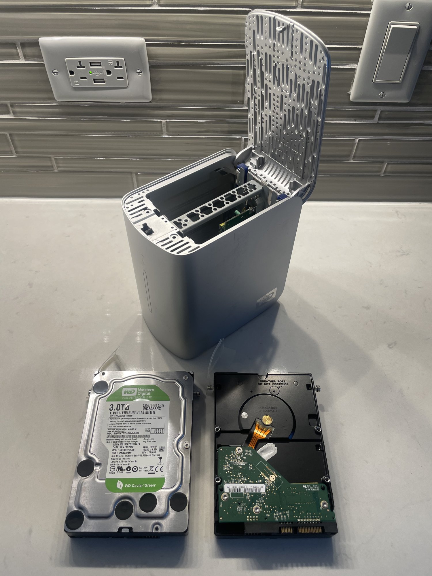

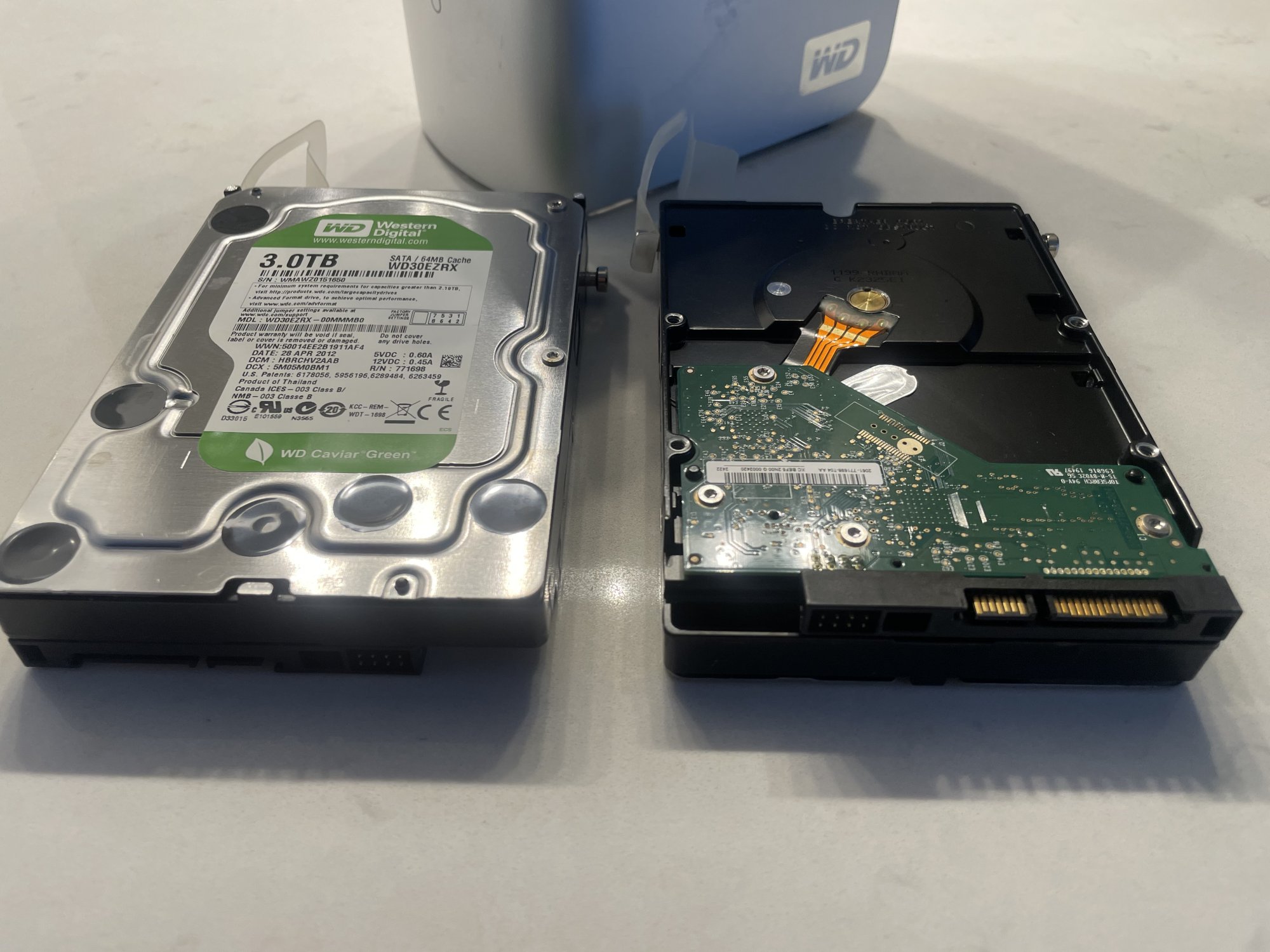

Hello, this is my 1st post and the reason why I joined. I have a water-damaged hard drive 6TB that had water on-or-in it for 1 day and then I dried it out. I see no water corrosion damage anywhere on the drive itself or the internal control board in the chassis or housing.
This hard drive would not power up when plugged into a 15" MacBook Pro but it did when plug into a 27" iMac using the same stock AC adapter. The power status with the 27" iMac has the front light blinking but no spinning of the platters.
I read that it could be a problem with the control board in the housing unit and to use a SATA-USB connector straight into the computer which I've done to no avail. I've tried this 3.3V pin tape-hack explained in Step 14 here -
...and still nothing on both drives. I don't know what else I can do which is why I'm asking you. Some extra links to the exact model I have with the online manual and attached photos. Any advice is greatly appreciated, thank you.

I'm thinking that this is a burnt out voltage diode on the either the PCB attached to the external drive casing or the PCB in the housing enclosure itself or both. My 2 possible approaches here are...
1) buy another exact sister model, housing drives the whole package and swap the BIOS ROM chips from the old PCB's on the drive casings to the new drive PCB's and mount those new boards onto the old recovery drives. BUT will that work or do I have to do the same swap with the RAID Controller chip on the PCB in the housing enclosure from the old PCB to the new PCB as well?
2) or still do as I explained above but use an aftermarket dual SATA RAID docking station. BUT will that work or do I have to have the WD RAID Controller from the PCB in the housing enclosure for the 2 drives (was set up as RAID 0 by default) to co-mingle with each other to access the data? If it doesn't work then I am forced to do the 1st scenario just to use the WD housing and it's PCB.
First, you have to check if your drives are still OK. Download the DriveDx app and test both drives separately using USB to SATA or whatever adapter you have to see what the SMART reports say. DriveDx has a fully functional demo.
