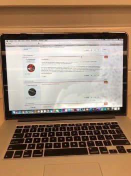

Hello there, I am in a little dilemma.
I was walking to my university as I normally do for my summer research when it suddenly started raining. I was close to school so I ran and made it. However, when I opened my backpack, I found that there were splotches of water on my macbook pro screen. I tried scrubbing it off but it appears to be actually inside and under the screen, and not just something I could simply wipe off. I've been through a number of solutions but none of them work: I tried to run my computer at 70 degrees celsius to get the fans going at a fast rpm, in order to evaporate the water. This didn't really get rid of the splotches however, and I stopped trying that route. I understand that you are supposed to shut off your computer if it comes in contact with water, which I have already done, but the water splotches under the screen still refuse to go away. What more can I do? Is there some trick with putting a huge fan and a towel directly at the screen?
No water got into the keyboard or anything, just stuck under the screen. My computer is still functional but it's very irritating to see the water splotches staining the beautiful retina display. I'm very aware that Apple and especially Applecare do not cover water damage under their warranties. In fact, the genius bar insisted I buy a new macbook pro, which I declined immediately. My computer is perfectly fine, I'm just not happy with the water splotches and I want to get rid of them.
Thanks for reading, please help if you can.

Do you AppleCare or AppleCare+? I have seen references that say AppleCare+ does cover water damage.
I will agree. That's bad...
I think you don't have any other choice but to replace the display assembly.
I am also surprised that you don't have water damage inside the MBPro.

Yea I guess I'll have to be more careful. I'll buy a waterproof messenger bag for the future, but what should I do now? Wait for it to dry? I'm wondering how long that'll take. I tried many different methods online that I saw. Like, someone used SMC fan. It's an application that can modify the RPM of the computer fans, so I tried to get the fans running a little faster and I got my computer up to 60 degrees celsius, forcing the fans to work even harder. I thought this could evaporate the water, but nothing really happened. Some spots did start to disappear, but they still linger. There is also the rice method I heard, but I don't want to try that as it sounds somewhat risky to me. I'm trying to see what else I can do. If my MacBook Pro wasn't working, that would be a different story. It works perfectly fine, which I'm happy about, but the screen is just messy.
See if you can find a friend with a dehumidifier or those drying cases that are used to store cameras and lens. That may dry the water under the screen, although I suspect it will be rather slowly.

I have just Apple care. They did tell me they do not cover water damage, and said I would have to pay over $1000 to fix the screen for my 15 inch macbook pro.
Oh wow. This is ... bad. You might want to try twisting the laptop screen, opening the laptop up, doing whatever in your capacity to get rid of that water.

Wow. That screen looks bad. You might want to power it off for a few days and let the water dry out, but I suspect sooner or later you are looking at a screen replacement.
True. Even if it continues to work, he might not like how it looks and would have to bring it in for replacement.
The backlight layer is contaminated with water. Even if you get it dry, it will not return to normal. You will need to replace the LCD.

Yeah, but those waterproof cases cannot plug up the rear vents... and that is likely where water entered. The black hinge cover at the bottom of the display actually is not water tight and will easily allow liquid entry through the ends where the hinge posts pass through to the computer body. Inside that black cover there is a cavity where the cables, LCD board, and wifi antennas are and there is easily enough room for liquid to seep past and into the LCD itself.

You could try putting your laptop in a plastic bag along with a moisture absorbant brick or somesuch (there exists such to buy for use in boats, campers etc. Re-useable too - very handy if one has such needs...) Since the water wicked in between a very thin space between glass sheets it will probably take quite a bit of time to get it out again though (the surface area where water exposes to air is very small), so maybe you'd rather just pay a thousand dollars, I dunno.
Also as mentioned, chances are your screen will be permanently affected by this experience even if you get all the water out. The water may have pulled fine dust inbetween the screen and light diffuser for example.
Anyway as I recall, the newest generation Macbook Pros use fully laminated screens, so water would not be able to get inside them the same way. Excessive moisture might still do stuff like short out the screen refresh controller or backlight driver IC though...

In any case I would turn I off, remove the bottom plate an disconnect the battery. then you can let it dry for a few days. a small warm room with a dehumidifier will help the process. after that you should see how the screen looks.
Also remember, waterproof usually works both ways, and in case with things only is resistent to water I can actually make it worse if any gets in as it will be more easily trapped.
Was the Mac laying in a position so that the un affected area were pointing up and the affected area down?
