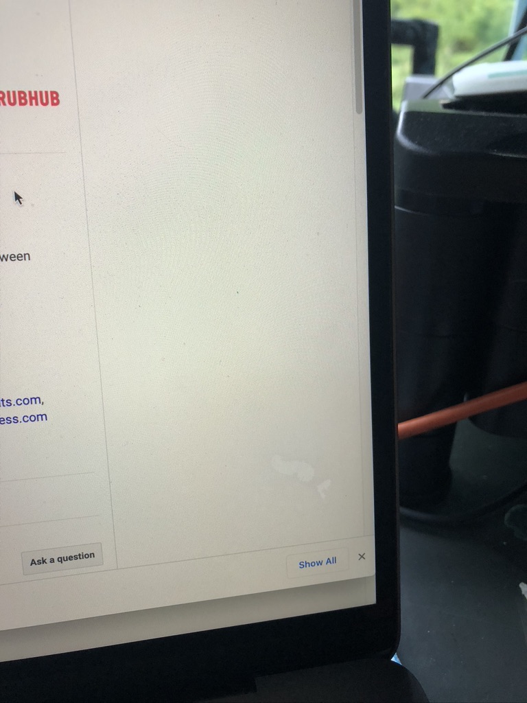

Hello there, I am in a little dilemma.
I was walking to my university as I normally do for my summer research when it suddenly started raining. I was close to school so I ran and made it. However, when I opened my backpack, I found that there were splotches of water on my macbook pro screen. I tried scrubbing it off but it appears to be actually inside and under the screen, and not just something I could simply wipe off. I've been through a number of solutions but none of them work: I tried to run my computer at 70 degrees celsius to get the fans going at a fast rpm, in order to evaporate the water. This didn't really get rid of the splotches however, and I stopped trying that route. I understand that you are supposed to shut off your computer if it comes in contact with water, which I have already done, but the water splotches under the screen still refuse to go away. What more can I do? Is there some trick with putting a huge fan and a towel directly at the screen?
No water got into the keyboard or anything, just stuck under the screen. My computer is still functional but it's very irritating to see the water splotches staining the beautiful retina display. I'm very aware that Apple and especially Applecare do not cover water damage under their warranties. In fact, the genius bar insisted I buy a new macbook pro, which I declined immediately. My computer is perfectly fine, I'm just not happy with the water splotches and I want to get rid of them.
Thanks for reading, please help if you can.

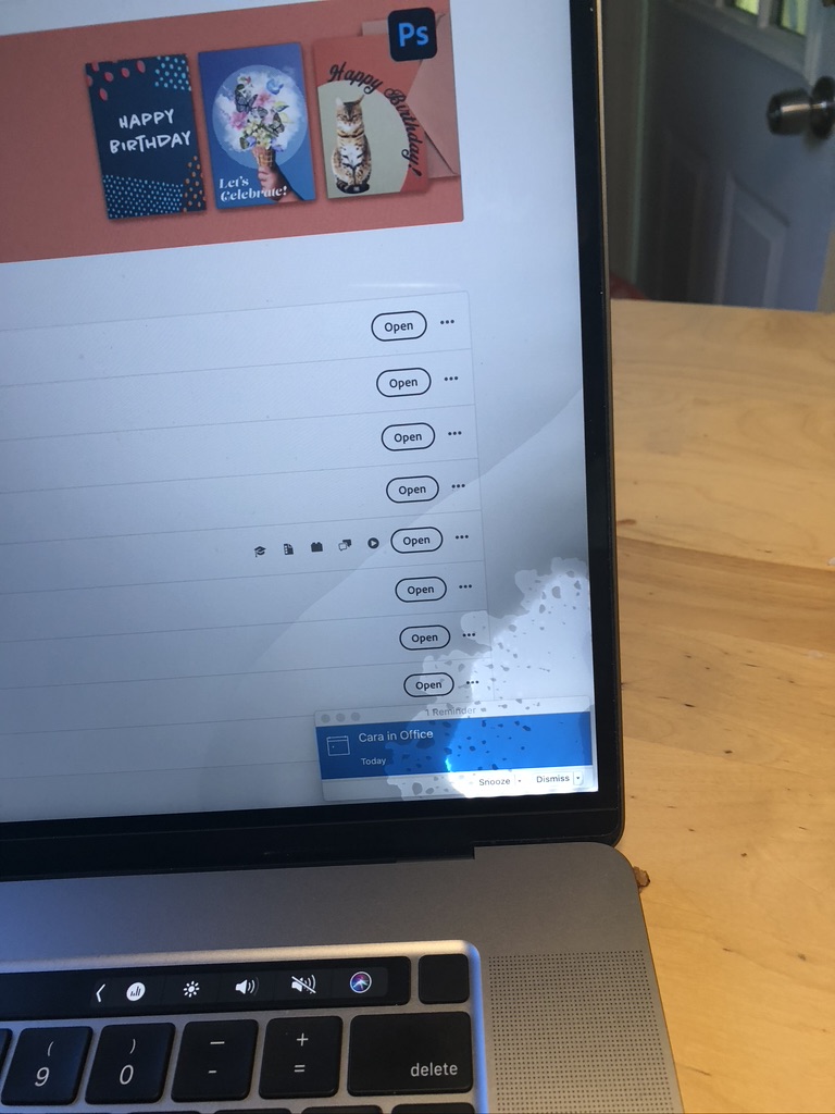

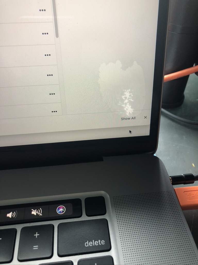

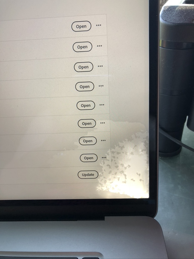

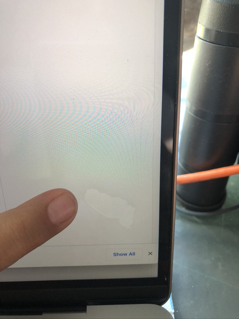

I came across this post because I stupidly dumped water into my macbook pro keyboard and the screen wicked water up into it.... I called applecare and they were more concerned with getting the water out of the keyboard and told me to use a hair dryer. My main concern was to get the water out of the screen.... I sat the laptop on it's side open like a book with silica gel packs (the kind that come in a box with a new pair of shoes, tech gear, clothing. The next day the water mark was a LOT smaller. i kept going with the silica gel since thursday and today (sunday evening) it's almost 100% gone. I'm confident it will clear 100%. Moral of the story, don't use open containers for drinks. Adult Sippy Cups are our friends. And don't pick on your SO for hoarding silica gel packs.
Here's a photo history for reference.
Thursday 5:30
Friday am
Saturday
Sunday am
Sunday PM
I had the same issue with my work MacBook Pro and I followed @cararolinson's advice. I kept using it for work during the day and at night I sat the laptop on it's side open like a book but didn't use the silica gel. I was able to remove moisture in 3 days. Thank you!

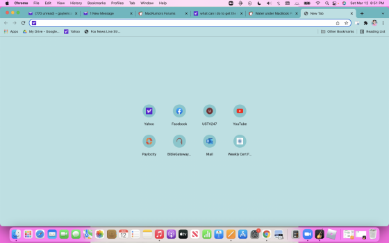

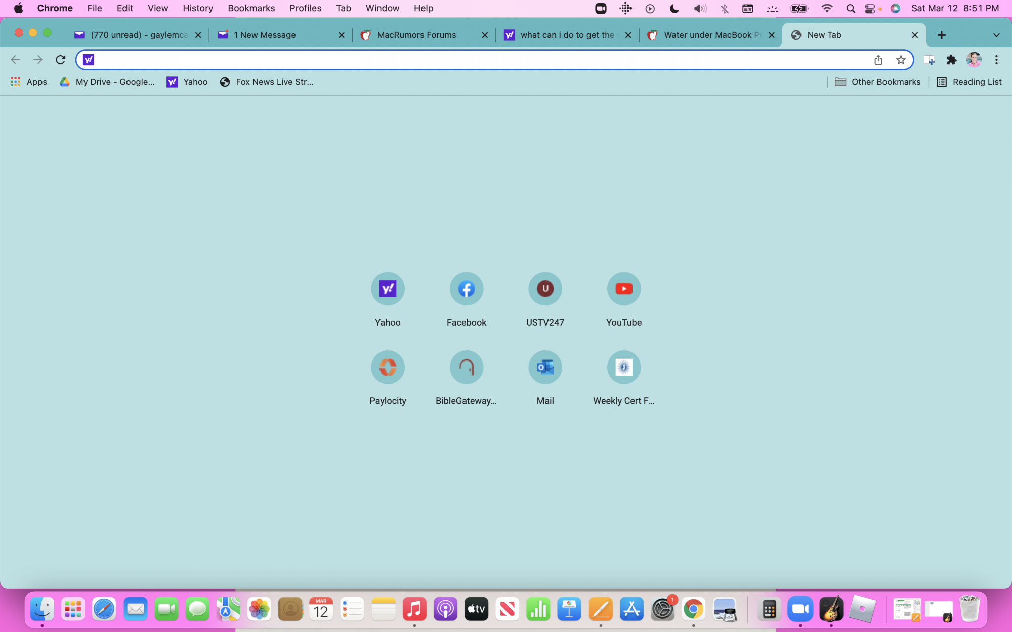

The same thing happened to me 2 days ago. I had my coffee container in the bag with my MacBookPro and it spilled on to my computer. UGH! Here's what my screen looks like. I hope it drys out in a few days. Prayers please

@gaylemcardinal:
hmm... Your picture doesn't really show any kind of water stain.
Compare to the earlier pictures in this thread, which clearly shows liquid/water behind the glass.
Where, in your picture, do you think is an area showing evidence of water under the glass?
yeah, I don't know why I missed that the filename that gaylemcardinal posted was named "ScreenShot...."
Of course, it's a screenshot...
@gaylemcardinal : You need to take an actual picture of your screen (you know, using a camera or phone), which will show us what your screen really looks like. Even a badly cracked screen will screen shot with no damage visible at all.
(there's no way to show physical damage on a screen shot!)
