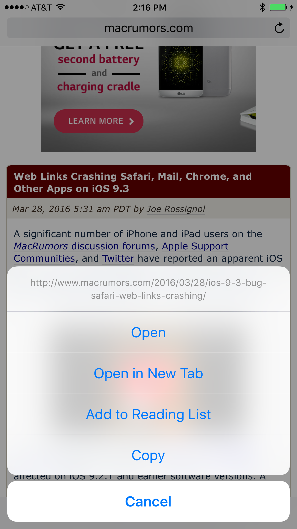

I don't know what's wrong with his phone.
When I long press, I get this:
