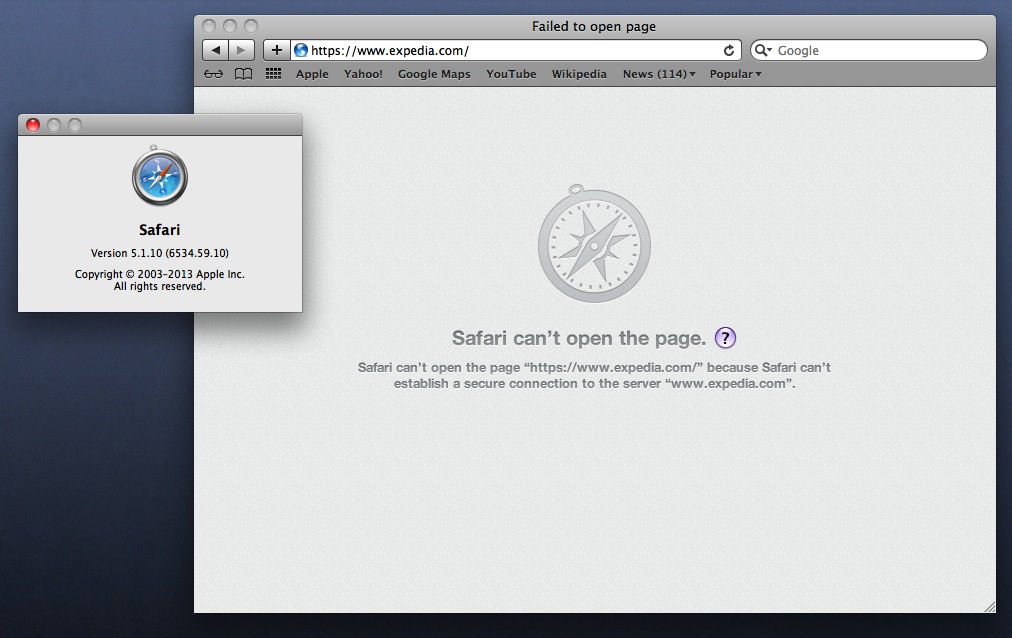

@alex_free, that seems a worthwhile thing to do, and you're certainly capable of such a feat. However, here's why I don't think a security certificate will solve the issue:

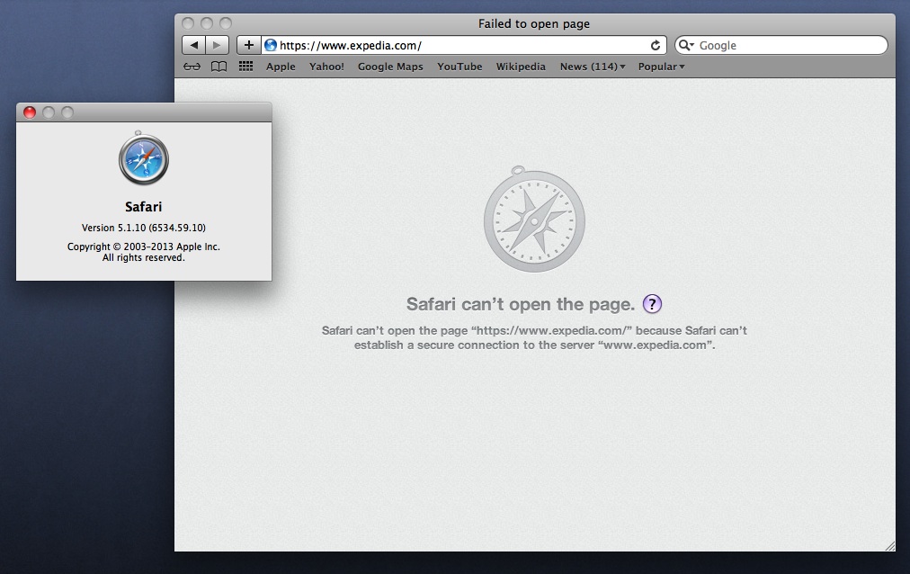

If a certificate was the problem, shouldn't the browser return some kind of warning or at least information such as this (from Safari 5.1 on Snow Leopard):

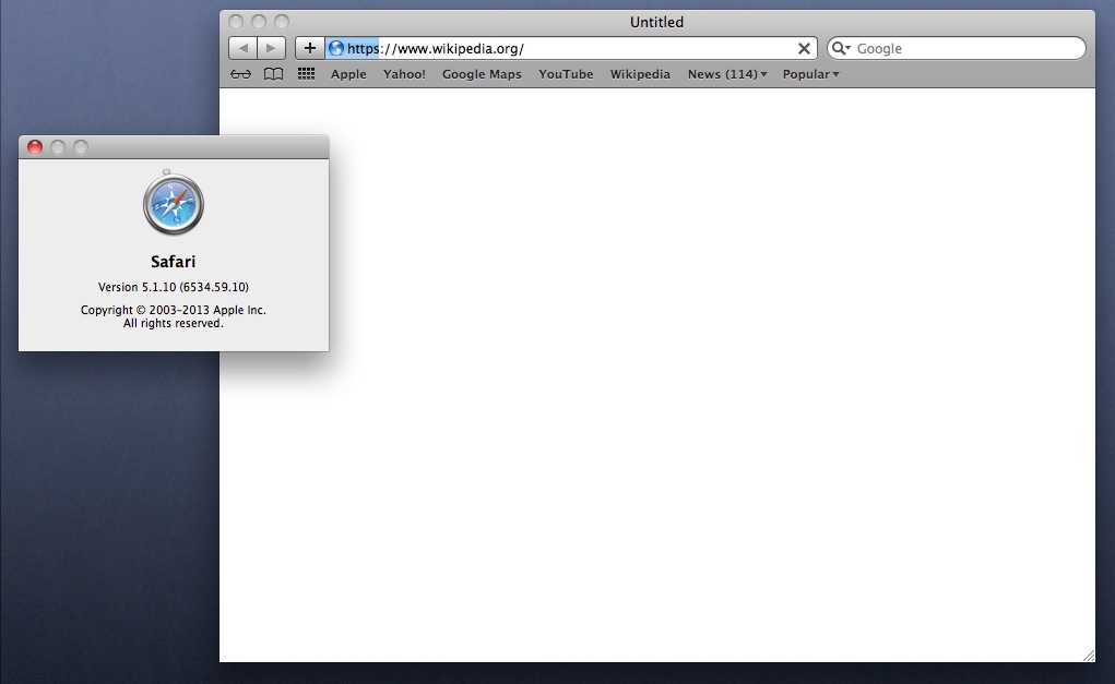

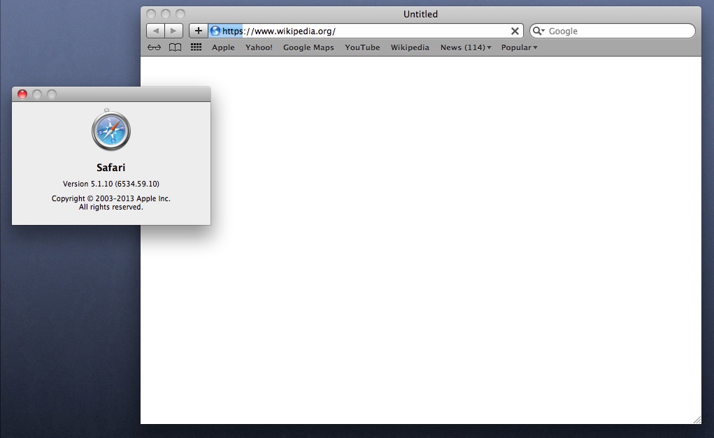

Instead, the Wikipedia site looks like this (again, Safari 5.1 on Snow Leo, but LWK on Leo is doing the exact same thing):
It just hangs there, without going any further. I'm no browser developer, so I could be all wrong. But shouldn't it at least alert you to the problem, if the problem was security-related?

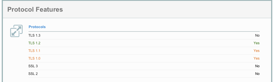

You would be correct. It's not the certs. Lots of sites are moving to TLS 1.3 these days. Our LWK is only capable of up to TLS 1.2.

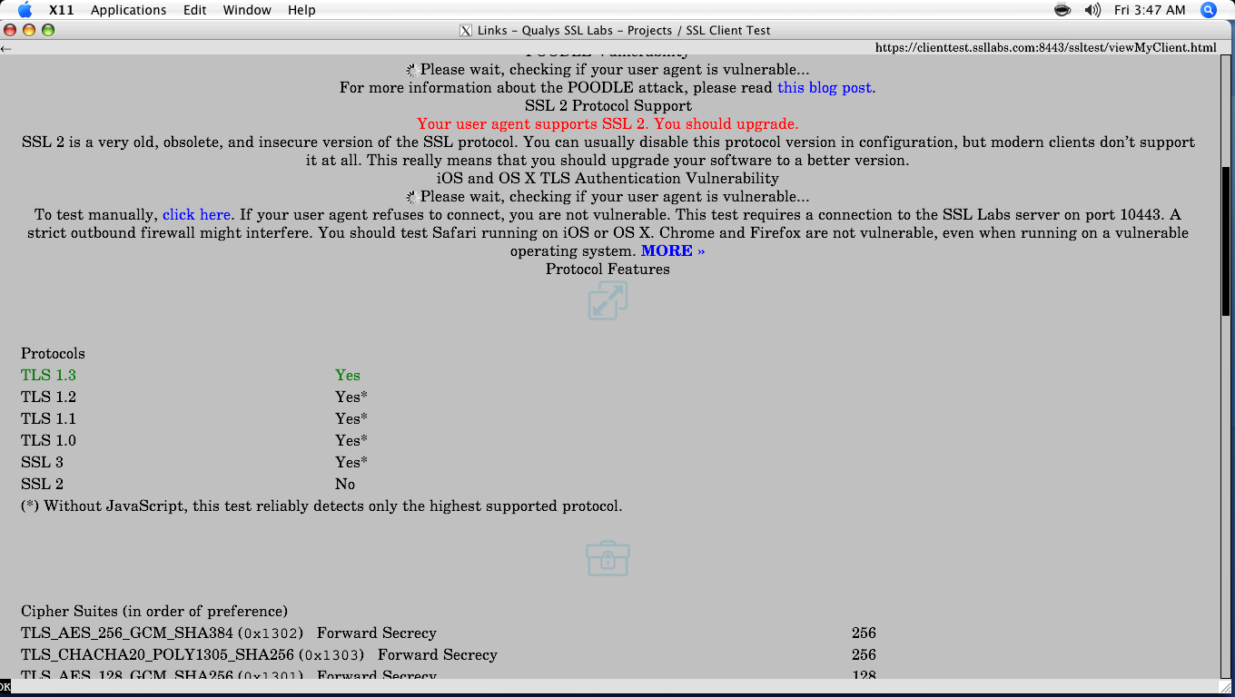

That's links2 above, I'm pretty sure TLS 1.3 support needs to be backported into LWK before it would work. Even if the OpenSSL was updated LWK wouldn't know how to handle TLS 1.3 connections as is. The best thing to do I guess would be to find the commit that added TLS 1.3 to webkit originally and go off that. Kind of insane TLS 1.3 is now required.

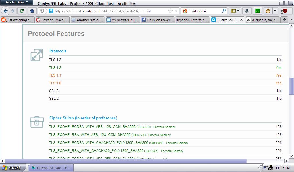

Well now i'm not sure if it's TLS related. Just tested AF on XP and it doesn't have TLS 1.3 support either, yet it has no issue with wikipedia or hyperion-entertainment which both fail with LWK. *shrug*
