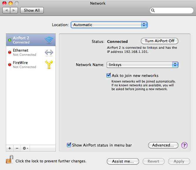

I just got my problem fixed after a surprisingly brief call to Apple tech support. here's what I had to do:
1.) Open the Network preference pane in System Preferences.
2.) Select the "Airport" service. Delete it by pressing the minus sign at the bottom of the window.
3.) Click the plus sign to add a new service. For the Interface, select "Airport." Press "Create."
4.) Press "Apply."
5.) Select the new service (it will probably be called "Airport 2") and make sure Airport is turned on.
That's all I had to do! The support tech did mention that I might have to do this again for when I plug in to an Ethernet connection, but that's no big deal.
I do want to mention that I never had the intermittency issues mentioned by many here and elsewhere. I simply could not ever access the internet, despite full wireless connection or Ethernet connection.
Best of luck to you all.
Thanks a lot! Worked perfectly. Apple support just told me to add a new Network Location with the "+" sign. That didn't work. Your solution of deleting and then re-adding worked!
