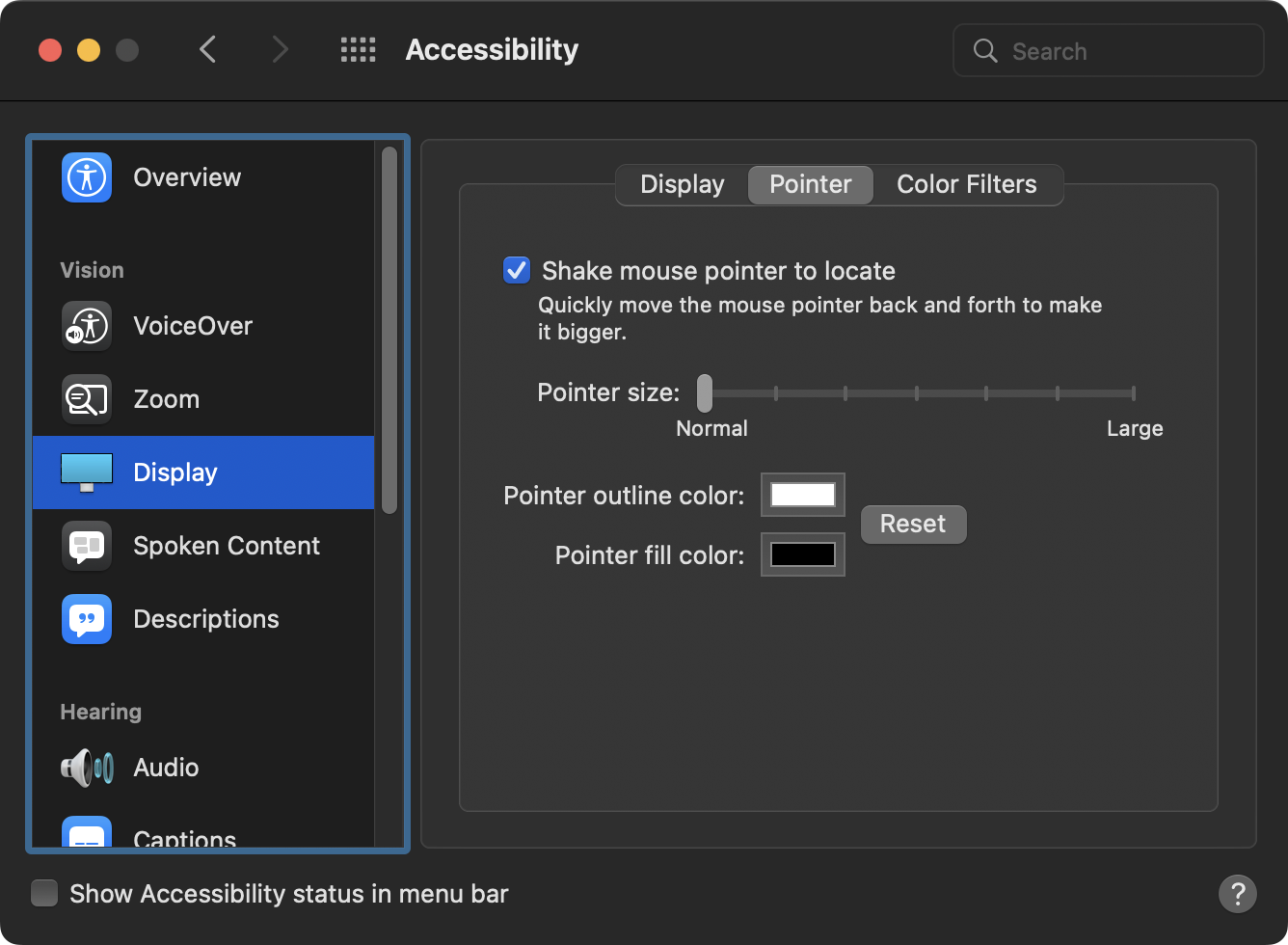

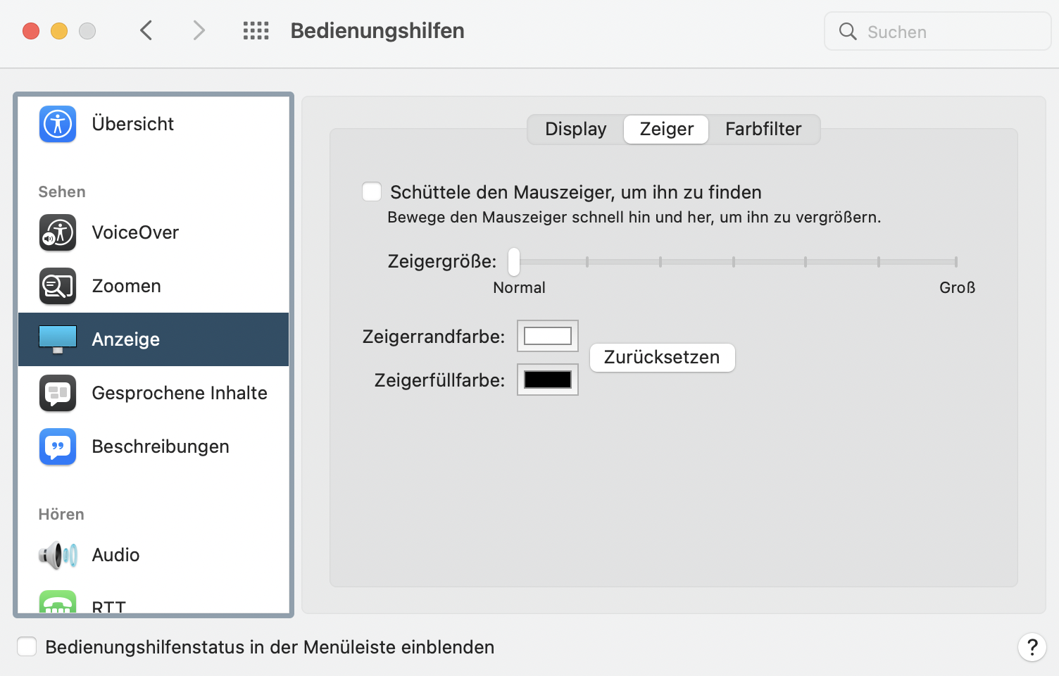

Your problem here isn't mine. I don't have these lags on windows. My pointer ist lagging, juming, too slow, too fast, bad/stupit/random acceleration. BUT, maybe I have a solution for you. Please check my Screenshot here. I don't know the wording in a English macOS ... but it should like ... "Shake your pointer to find him". Disable that option. Restart.

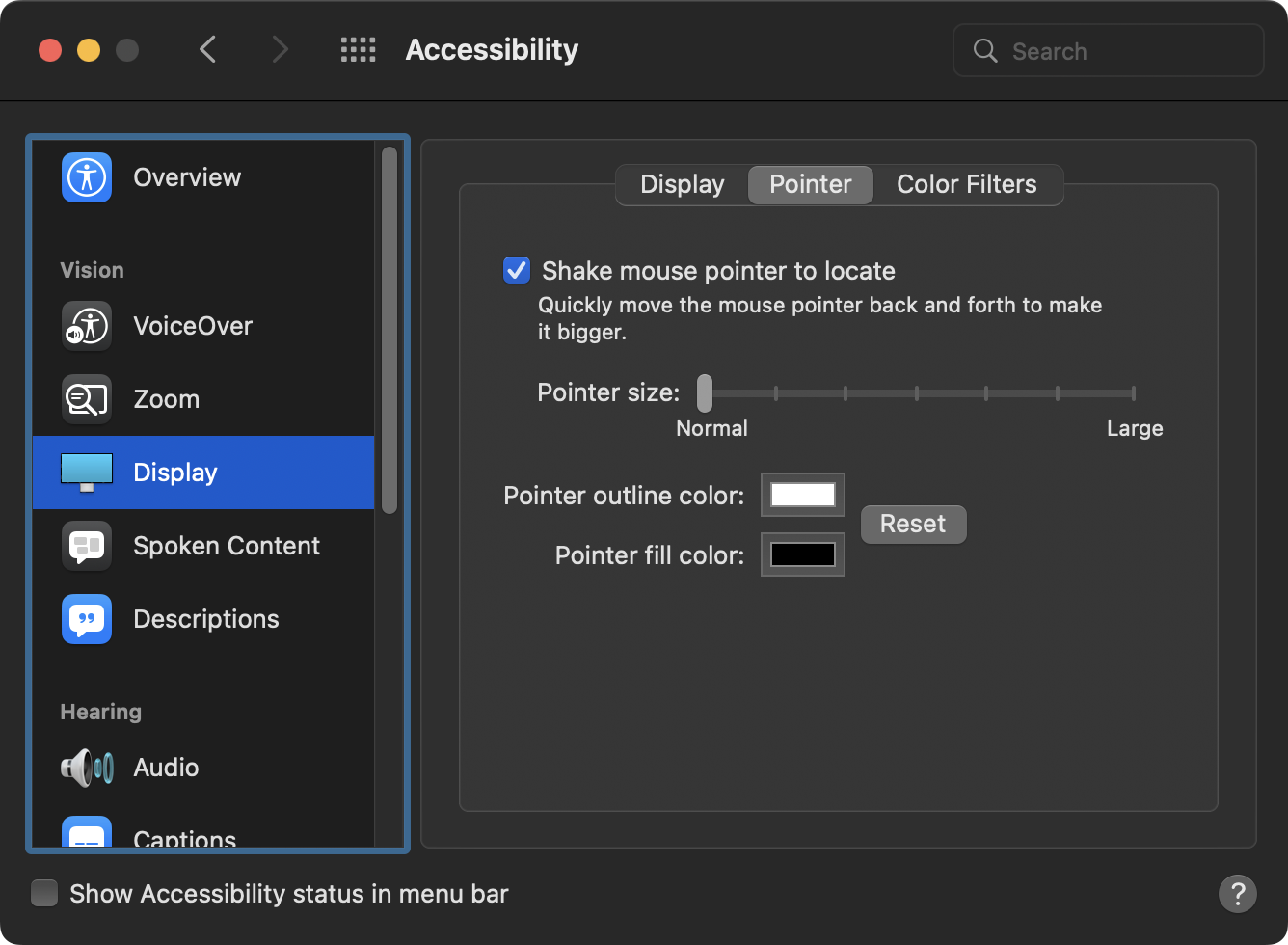

There was a memory leak awhile back when you changed the cursor from its default settings. Maybe this is related to that?
