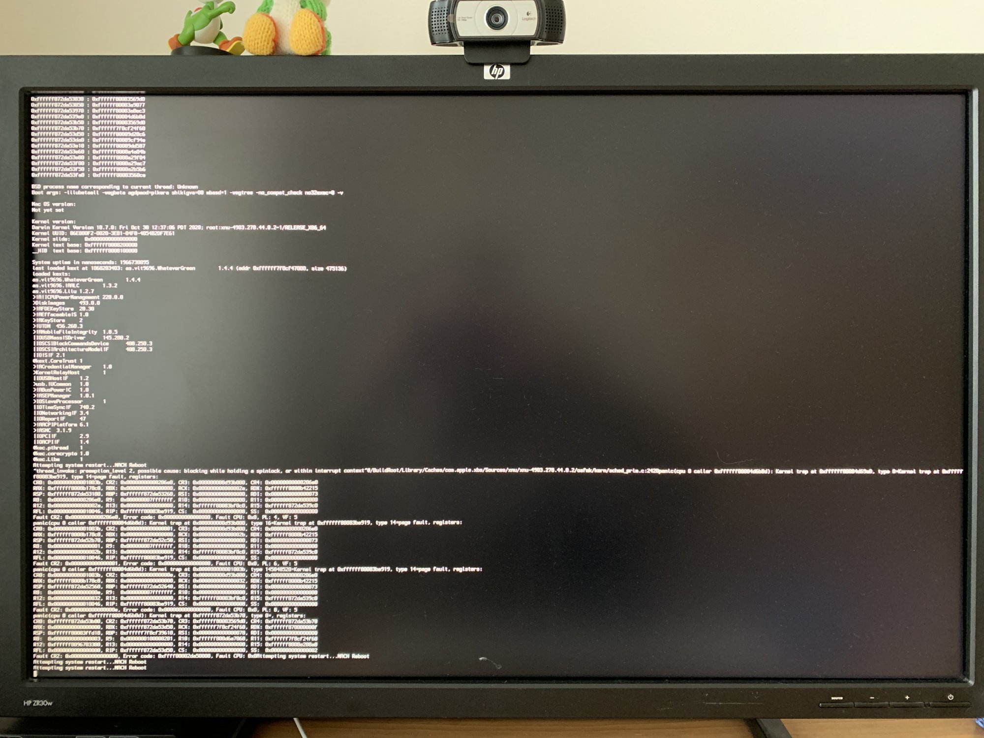

Hello everyone,
I will start with the classic "long time reader, first time poster" here.
I own a 4,1->5,1 Mac Pro (dual socket), with a Radeon Pulse RX580 with dual BIOS, with the Orinoco framebuffer and flashed by MacVidCards, running fully patched Mojave. I also have a flashed Titan Bridged TB card. I boot from a nvm volume.
I am extremely happy with the machine.
However, one of the greatest sources of frustration for me is the fact that, even though I have the Orinoco framebuffer, I get no hardware acceleration. So, in the beginning of the month, I decided to give OpenCore a shot following the instructions here and it worked perfectly for two weeks. And WOW - I was so happy! Much better performance for watching and editing videos, hardware encoding for quicktime screen capture, lower power consumption.
Suddenly, I started getting kernel panics (see attached image) every 20 boots or so. Initially, reinstalling OpenCore helped but now it doesn't. I started troubleshooting, trying different versions of OpenCore, always using the template from the post and nada.
So I decided to try things part by part. To my surprise, if I pick the recovery partition during boot, it boots fine. So I tried installing vanilla OpenCore and... it works! Whenever I add WhateverGreen and Lilu to the mix I start having problems (using the versions pointed in the post or newer). But nothing else has changed. I'm using the same versions of WhateverGreen and Lilu as before so I don't understand why it doesn't work.
Any suggestions? I have a bootable mirror of my installation so playing around is fine. My boot arguments for when I tried the whole package are in the screenshot. When I tried only OpenCore, I didn't load a config.plist at all so I just got a screen asking me to choose the boot disk (no icons, only the name of the volume on the top right of the screen).
The only change from when I installed OpenCore that I can remember of was the installation of the Supplemental update.
Thank you!
PS: I don't like getting help without giving anything in return, so please point me to the most pressing issues and I'll be happy to try to help. My Mac Pro is available for experimentation (I own a 1,1 that can get the job done in any case).
edit: I’ve just connected my unflashed RX560 and I get a boot screen and can see the kernel dump. I’m suspecting the new macOS update. Anyone can confirm?

I'm very puzzled why this started being a headache without a change in my environment.
My EFI partition is empty and PRAM reset was done after clearing my EFI partition.
edit: I did a small cleanup - there were drivers for things that I haven't connected to my computer in 6-7 years, like the creative USB audio card or ambrosia software audio support (this one I think was for marble blast gold)
More investigation:
After removing Lilu, AppleALC, HorNDIS and the creative and ambrosia drivers, rebooting clean and reinstalling everything, I managed to boot after a crash.
The system started booting, then crashed, but after getting to the point where I'd get a report, so it restarted on its on and booted. Here is the crash:

com.apple.kec.Libm    1
EOF
Model: MacPro5,1, BootROM 144.0.0.0.0, 12 processors, 6-Core Intel Xeon, 3,1 GHz, 64 GB, SMC 1.39f5
Graphics: Radeon RX 580, Radeon RX 580, spdisplays_pcie_device, 8 GB
Memory Module: DIMM 1, 16 GB, DDR3, 1333 MHz, 0x80CE, 0x4D33393342324737304248302D5948392020
Memory Module: DIMM 2, 8 GB, DDR3, 1333 MHz, 0x802C, 0x33364B534631473732505A2D3147344D3120
Memory Module: DIMM 3, 8 GB, DDR3, 1333 MHz, 0x802C, 0x33364B534631473732505A2D3147344D3120
Memory Module: DIMM 5, 16 GB, DDR3, 1333 MHz, 0x80CE, 0x4D33393342324737304248302D5948392020
Memory Module: DIMM 6, 8 GB, DDR3, 1333 MHz, 0x802C, 0x33364B534631473732505A2D3147344D3120
Memory Module: DIMM 7, 8 GB, DDR3, 1333 MHz, 0x802C, 0x33364B534631473732505A2D3147344D3120
AirPort: Third-Party Wireless Card
Bluetooth: Version 6.0.14d11, 3 services, 18 devices, 1 incoming serial ports
Network Service: Ethernet 1, Ethernet, en0
Network Service: RNDIS/Ethernet Gadget, Ethernet, en10
PCI Card: pci144d,a808, NVM Express Controller, Slot-2
PCI Card: Radeon RX 580, Display Controller, Slot-1
PCI Card: pci1002,aaf0, Audio Device, Slot-1
PCI Card: Apple RAID Card, RAID Controller, Slot-4
PCI Card: pci8086,15eb, Unknown, Slot-3@5,0,0
PCI Card: pci8086,15ec, USB eXtensible Host Controller, Slot-3@7,0,0
Serial ATA Device: HL-DT-ST DVD-RW GH41N
USB Device: USB 2.0 Bus
USB Device: Hub
USB Device: Keyboard Hub
USB Device: USB Receiver
USB Device: Apple Keyboard
USB Device: Logitech Webcam C930e
USB Device: Multi-Reader
USB Device: USB Bus
USB Device: BRCM2046 Hub
USB Device: Bluetooth USB Host Controller
USB Device: USB Bus
USB Device: USB Bus
USB Device: USB Bus
USB Device: USB Bus
USB Device: USB Bus
USB Device: USB 3.1 Bus
FireWire Device: built-in_hub, Up to 800 Mb/sec
FireWire Device: SAFFIRE_PRO_24, Focusrite, Up to 400 Mb/sec
Thunderbolt Bus: Mac Pro, GIGABYTE, 23.0
It seems to have crashed after loading this: com.apple.iokit.BroadcomBluetoothHostControllerUSBTransport
I have no idea why.
Here is the output of kextstat:
Code:
legendary-pro:~ saulo$ kextstat | grep -v com.apple
Index Refs Address            Size       Wired      Name (Version) UUID <Linked Against>
   38    1 0xffffff7f84dad000 0x2a000    0x2a000    as.vit9696.Lilu (1.4.9) 6E38576B-9675-3D9E-9763-5B0F9DA1B098 <8 6 5 3 2 1>
   39    0 0xffffff7f84dd7000 0x74000    0x74000    as.vit9696.WhateverGreen (1.4.4) 16865DE9-453C-3F11-BE9F-FDC2795B7536 <38 13 8 6 5 3 2 1>
  119    1 0xffffff7f81042000 0x47000    0x47000    com.Logitech.ControlCenter.HIDDriver (3.9.12) FEE674A7-82F4-3D96-A448-ADD5C084B172 <118 110 47 23 6 5 3>
  122    0 0xffffff7f81099000 0x17000    0x17000    com.Logitech.Unifying.HIDDriver (3.9.9) 9DD96EF2-3F19-3DB2-9260-AFF735659C21 <121 119 57 47 6 5 3>
  124    0 0xffffff7f813e9000 0x22000    0x22000    tc.tctechnologies.driver.Saffire (4.3.0 41017) 3563D1B5-FFE0-380D-B232-6D2D6CF819F7 <109 76 6 5 3 1>
  165    3 0xffffff7f84e51000 0xf2000    0xf2000    org.virtualbox.kext.VBoxDrv (6.1.16) DAF044F0-5043-3B8E-8758-5A462567BDAA <8 6 5 3 1>
  169    0 0xffffff7f84f43000 0x8000     0x8000     org.virtualbox.kext.VBoxUSB (6.1.16) CA33FA52-5933-3F0E-9B40-8B1ECF4D6A36 <168 165 57 8 6 5 3 1>
  170    0 0xffffff7f84f4b000 0x5000     0x5000     org.virtualbox.kext.VBoxNetFlt (6.1.16) C93EAF6A-676F-3370-BAE2-BDFD2BF16582 <165 8 6 5 3 1>
  171    0 0xffffff7f84f50000 0x6000     0x6000     org.virtualbox.kext.VBoxNetAdp (6.1.16) 76200407-D2F0-3D84-BCCF-7EEA18F16654 <165 6 5 1>
I think going back to the previous version caused a mess with the versions. However, this doesn't explain why I started having the crashes to begin with. I will reboot now and see what happens.
I installed the older version just to be sure there were no issues with the newest.
I had never installed OpenCore before. I started having issues out of the blue after it had been working for days on 0.6.3.
The machine rebooted fine. Thanks for the script!
I configured rsyslogd on my server and started pushing *.* there. If I start having crashes in a few days, I will dig deeper.
Thank you for your help! I didn't know this kextstat command - it's super useful! I did a good cleanup here.
