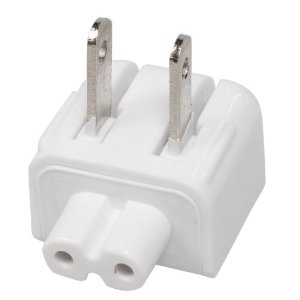

Because your power at your location current isn't 'clean', and needs to be grounded. Use the extension cord that came with your macbook. The short power head doesn't ground the connection.
Neither does the extension lead - they both plug into the 2-pin connector on the PSU. Or maybe I'm misunderstanding what you're saying?
The extension cord has a grounding pin (which works through the metal disc that the connector slides in to). That's the third pin.
The duckhead doesn't have a grounding pin, nor does it have the little metal contacts that connect to the disc but the extension lead does (at least the UK and EU 'Schuko' ones do).
By the way this feeling is indeed normal, I've had it ever since my Alu PowerBook which I got in 2004 (and the power adaptor design actually stems from that era, I think it's the only Apple design they didn't change all that time 🙂 ). You can feel it because the case is metal and thus conductive, that's why most PC laptops don't exhibit this. I usually use the extension lead too because it is a bit uncomfortable.
Ah, I'd never spotted that. Curious that the 'duckhead' doesn't though 😕
Yeah I think they're called duckhead because the U.S. one actually looks a bit like the head of a duck, with the pins folded out 🙂
I think that's also the reason it doesn't have grounding: The US model is made to be as slim as possible and has a folding-pin design. That wouldn't fit if the ground pin was also included.
The UK plug is way too bulky for this to work in such a small design, and in the UK the ground pin must always be present to open the socket latch, even if it is only plastic. I've even seen them with metal but not actually grounded. But I think the U.S. model design was probably the one that started the ungrounded duckheads thing 🙂
You can also use a short cable with a 'figure-eight' (or rather IEC 320 C7 plug). Maplin have a nice cable with a folding pin plug which I use in my laptop case - I'm always afraid the large pins will press on the MacBook and cause a dent. But this will also not be grounded as the metal disc grounding thing is a proprietary Apple design.
