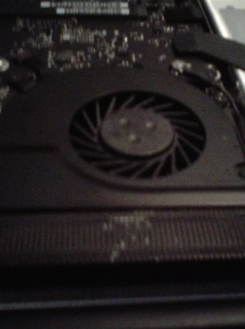

I upgraded 4gb of ram to 8gb today but when I took the bottom cover off of my mbp 2.0 i7 I found some crap on the center fan.
I took a picture of it. Does anyone know what this is?
This is the first time I've opened the case.
Thanks.
That's a bit sad... they really slop that stuff on with a spatula in whichever sweatshop it came from.
Personally I'd be returning it and showing them that picture. The thermal interface material being in between the fins of the heatsink is reducing its effectiveness and is not acceptable.

It may seem overkill, but I'd take the logical approach on this one. Try to clean it with a cloth and rubbing alcohol.
If its under warranty you really don't want to fool around with trying to dislodge thermal pad leftovers from the heatsink with rubbing alcohol, its just not worth the risk. That thermal pad originated from the opposite side of the logic board, which means its made it all the way through that heatsink, it really just needs to be swapped.
since u bought it on july 21st... i think today might be the deadline for ur 14 day no questions asked return.
back up ur files.
take it to any apple store.
return the mbp. orrrrrrrr ask for a brand new exchange.
show them the photo.
even if u pass the 14 day... i would still ask for a brand new comp.
THAT IS NOT ACCEPTABLE.
p.s. don't let them just replace the logic board.
that's thermal paste and it's on the heatsink. the fan is not connected to the heatsink.
they will either clean it by take ur mbp apart or just change out the entire logic board.
honestly though if i saw that on my machine i would ask for a new one. doesn't seem acceptable for a $2k+ machine.

Update:
picked up my macbook pro and put my 8gb of ram back in. I took a picture of what it looks like now. (sorry for the crap picture this time)
There's still some crap on there, but the computer seems to be working fine.
They said that they took it apart, cleaned it out, and then reapplied the thermal paste.
To the guy who said it wasn't thermal paste, you were wrong, but thanks for trying to help.

Update:
Thanks for the help guys.
This is unacceptable. I would take it back again. Even though whatever problem you had is gone, this might pose a problem later on. They should have just replaced the part.
