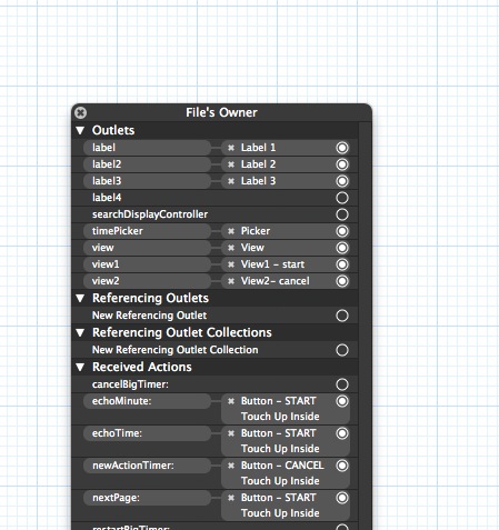

With the little code you posted, and since you haven't provided screenshots of your associations in Interface Builder, these are all pending questions we have that are preventing us from helping you thoroughly. This is not a quiz, these are things we need to know to help you.

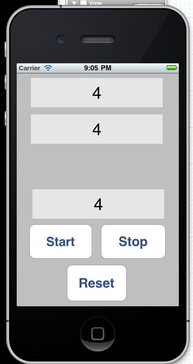

Where he makes the counter count backwards from 600 by hardcoding the initial value in the label, make that a variable that is tied to the datePicker of your choice.
If you want to do it in baby steps, first use two labels one for the input and one for the display to input the starting time and then replace the input one with your datePicker.

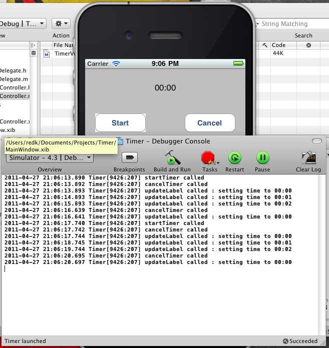

What makes you think that ? Once you invalidate a timer, it's done and gone. Look, I implemented a timer that updates on screen with minutes:seconds and it gets reset properly when I invalidate it (take a peek at the screenshot).
A screenshot like this goes a long way. Console output with NSLog to know what gets called and when is even better.
If you posted up the full code of your viewController, we might even be able to point you in the right direction. The more you are specific, the better we can help.
I'm thinking you don't quite grasp what an NSTimer object is. It's not an actual timer as in a chicken timer. It's just an object that's inserted into the run loop, waits for a specificied interval and then calls a method (depending either the NSInvocation or the target/selector you used when creating it). If you set its repeat to YES, it will call this method over and over again at the specified interval.
This specified method (in my screenshot that would be updateLabel) has to do some processing to display minutes:seconds on a label.

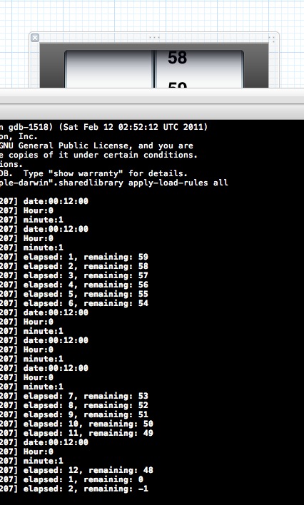

Knight , I don't know how you do it. Check my photo log, mine keeps on running.

Ok, This is another code from the one I posted. Nothing to do with the other.
balamw. I have set two more labels like you said to be variables of the original label (where he sets the seconds) the both do the same. Now.. because they are used both to display and to input.. I have no idea how to make one of the variables that I made tied to the datePicker. (I get warnings that say their not compatible classes).
Here is the .m :
Code:
@synthesize datePicker;
@synthesize label;
@synthesize input;
@synthesize display;
- (IBAction)start: (id)sender
    myTicker = [NSTimer scheduledTimerWithTimeInterval:1.0 target:self selector:@selector(showActivity) userInfo:nil repeats:YES];
- (IBAction)stop
    [myTicker invalidate];
- (IBAction)reset
    label.text = @"0";
    display.text = label.text;
    input.text = label.text;
- (void)showActivity
    int currenTime = [label.text intValue];
    int newTime = currenTime + 1;
    label.text = [NSString stringWithFormat:@"%d", newTime];

Nekbeth, I'm looking at the code and I'm thinking you still don't quite understand what NSTimer is and does. You keep track of "Elapsed" using 2 implementation scope global variables :
Code:
NSInteger seconds = 0;
NSInteger minutes = 0;
However, grepping for these variables, you never reset them back to 0 aside from their initial initialization :
Code:
$ grep -e minutes -e seconds ATimerViewController.m
    minutes++;
    NSInteger min = [num integerValue] - minutes;
    NSLog(@"elapsed: %i, remaining: %i", minutes, min);
    seconds++;
    NSInteger secs = [num integerValue] - seconds;
    NSLog(@"elapsed: %i, remaining: %i", seconds, secs);
Your minutes and seconds are thus never reset, so your "timer" is never reset (this is completely a seperate issue from NSTimer, hence why I say you probably don't understand the scope of NSTimer. It has no knowledge of these variables and thus doesn't reset them when you invalidate myTimer or newTimer).
Also, could you please post a screenshot of your Interface Builder associations ? (under File's Owner, the tab in Inspector with all the Outlets and Actions), because I can't quite figure out what buttons are tied to what actions.
You also still have 2 timers. Why do you believe you need both ? Have you tried simplifying the code to using only 1 ?
None of these are trick questions, It's me trying to understand what you think this code should do vs what it's actually doing. Now, if you don't answer my questions, I can't really help you here short of writing the code for you, which does not help you learn (I have a good idea how to make the code I wrote last night do what you want to do very quickly, but I doubt you can afford me as a consultant at my exorbitant rates!).
Thanks Knight, you are one of those who does helps no matter what, so I appreciate your patience, like Jethrotoe said. So, please don't take everything I typed and generalize it, because it's not for everyone. You personally look into the problem, ask questions about what's going on.. that is good !!, some other don't have your patience and throw in the typical sentence " Go learn fundamentals and come back" as soon as they see a basic mistake. So Patience I think is the right word to describe what's been going on here. It is actually a virtue and a basic one for a teacher to have.
Back to the code, here is a photo of my connections (ignore canceBigtimer). What you say is true I don't know how NSTimer works entirely , just some parts, I realize that and it is one of the reason I postpone my timer for a future update (need to study it).
