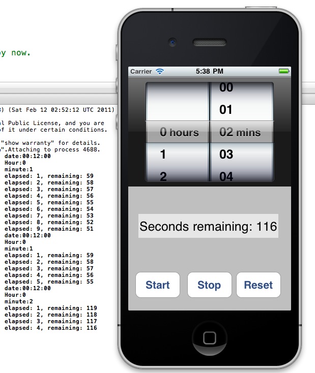

* Here is photo of the log and UI
I first started a new project in order to avoid confusion and made some changes, the result is what I think " a working timer " with start, stop and reset buttons.
Glad you got it working. Trust me when I say, it is not obvious, and that it now seems so to you is an accomplishment.
