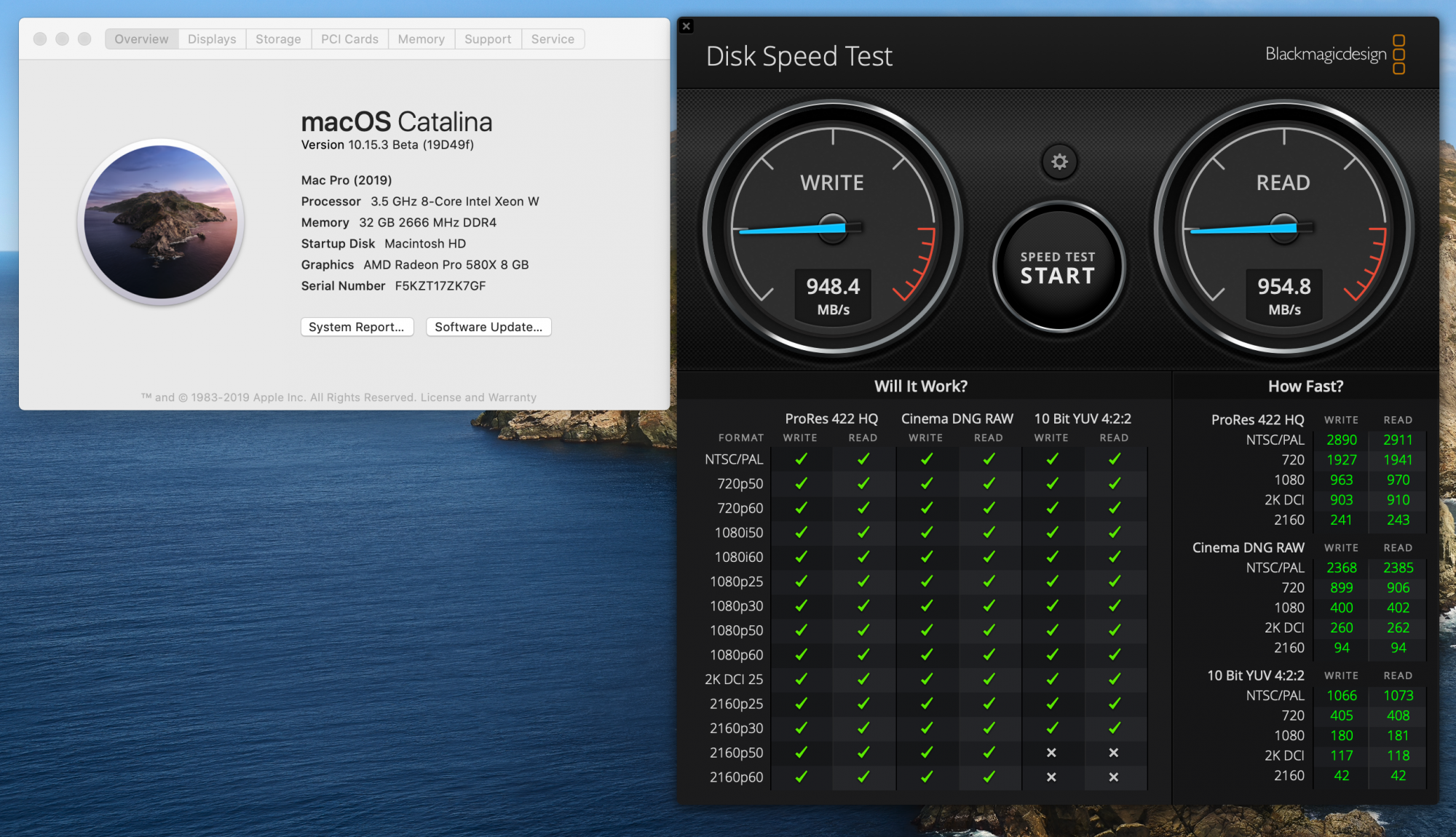

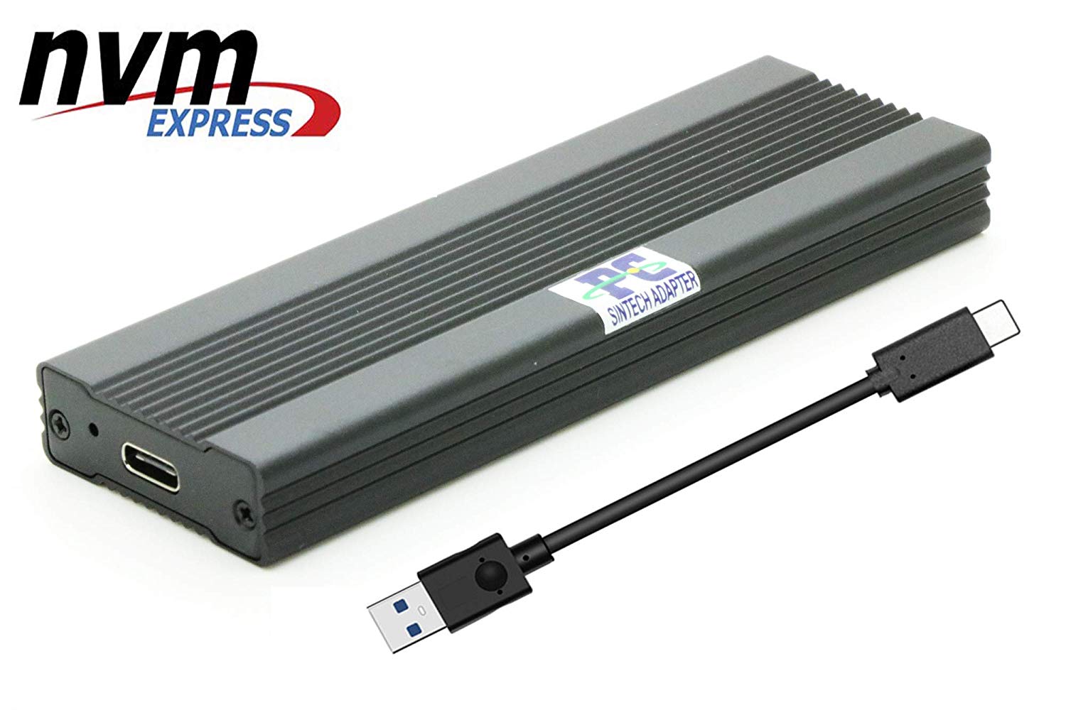

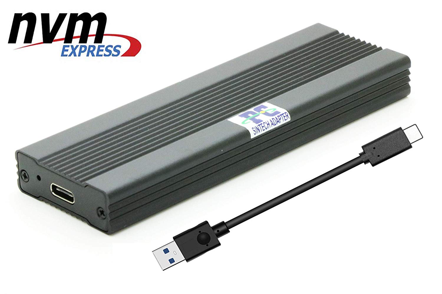

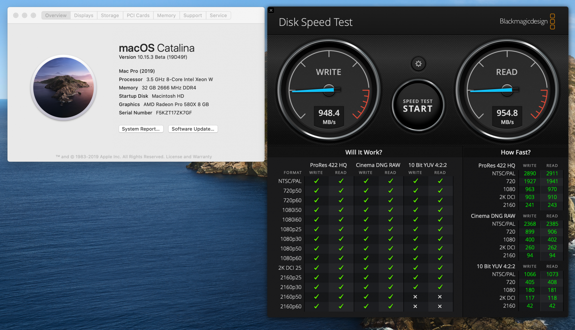

I built a nice USB thumb drive just to use with my MP7,1 .
Built the thumb drive for $135 :
Sintech USB NVMe SSD enclosure ( model ST-M2U3-U ) . $25 .
Sintech USB-A to USB-C data cable ( enclosed in the above product ) .
EasyAcc Thunderbolt 3.0 Cable USB C to USB C cable ( model SS_DC_C2C ) . $10 .
1TB HP EX 920 NVMe M.2 PCIe SSD blade . ~$100 .
The Sintech enclosure has an Asmedia ASM2362 controller chip .
The drive was formatted GUID with Mac OS Extended Journaled ( AKA HFS+ ) .
The only thing I need to do in the future is place some thermal gap material in the enclosure if the drive gets a little too hot , as Sintech did not include any .
Got around 950 MB/s reads and writes .
Here are the results using the EasyAcc USB-C to USB-C cable with the TB3 port on the top of the Mac :
