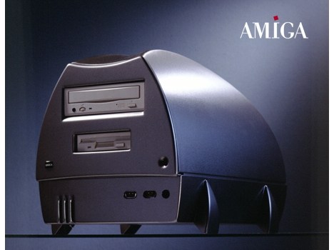

TheHerdForever's office of the future:
Awe-some!
