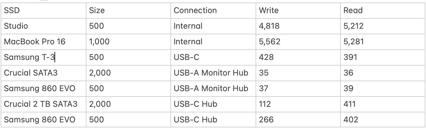

I normally don't move around a lot of files but I was rearranging things recently and decided to test the speeds of external drives and was somewhat shocked at the speed differences between internal, connecting directly to a Mac port and using port hubs. Here are my BlackMagic findings:
The USB-A Monitor Hubs are on Dell Ultrasharp U2720Q and U2718Q monitors. The U2720Q runs off USB-C while the U2718Q runs off USB-A with USB 3.0 speeds. The USB-C Hub is an Amazon Basics USB 3.1 Type C to 4 Port USBA hub (these were really cheap when I bought them). My previous setup was with the USB-A Monitor Hubs but they're now running off the USB-C Hub. The Crucial and EVO drives are run off of cheap enclosures which probably accounts for the poor write speeds. It is nice having faster read and write speeds though it wasn't a huge problem beforehand.
It's certainly interesting to see what happens when you measure things.

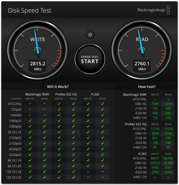

Thunderbolt basically tops out @ 2800 MB/s. I use a Samsung 980 Pro which is PCI-E 4.0 and it hits that spot. I've found that PCI-E 3.0 drives just won't give the maximum effort. As far as your drives slowing I have a RAID 0 Array in an enclosure that serves up my movies, TV and music. I notice it drags slowly when a movie is showing. I guess that is because it's in use.
I'm seeing exactly the same thing with my Samsung 980 Pro in an Acasis Thunderbolt/USB 4 enclosure attached to my Studio.

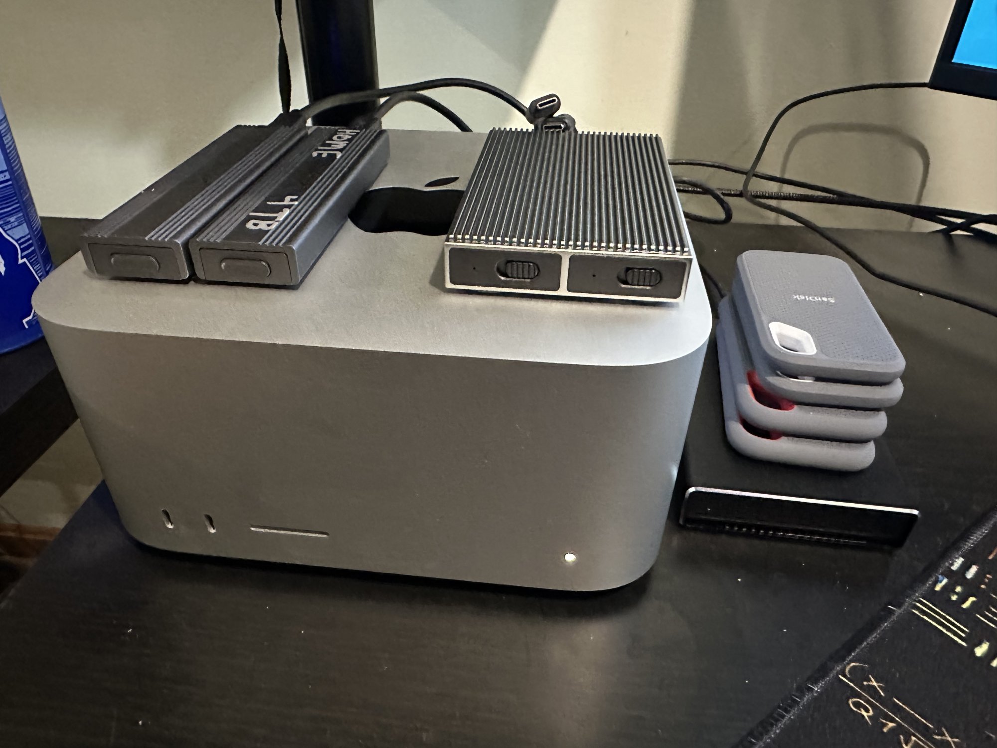

14TB WD EasyStore for Time machine and CCC clones
Two Kingston 3k nvme's in Sabrent TB3 enclosures.
Disk Speed Tests:
~2100 write, 2500 read (K3k's RAID 0)
4700 write, 5130 read (Studio Base Max)
M2 Studio Ultra with 1TB internal
Externals are all in USB3-C cases (10gbs)
2 * 4TB AData NVMEs
/Volumes/Unity (my gamedev drive)
/Volumes/Scratch (temp drive)
2 * 4TB Crucial P3 Plus NVMEs
/Volumes/Home
/Volumes/Media
1 * 2TB Inland NVME
/Volumes/Parallels
1 * 8TB Samsung QVO 870 SATA Vantec enclosure
Time Machine (only backs up Home and Unity)
I'm sure the drives could be faster but they are fast enough for my needs.. still 4-5x faster than hard drives. I'm eyeballing the OWC 4M2 Thunderbolt enclosure to move all of the 4TB drives at some point.
Also have a bunch of 1 and 2 TB Sandisk NVME drives.. use them for sharing, backups, etc.
Reactions: 2Stepfan

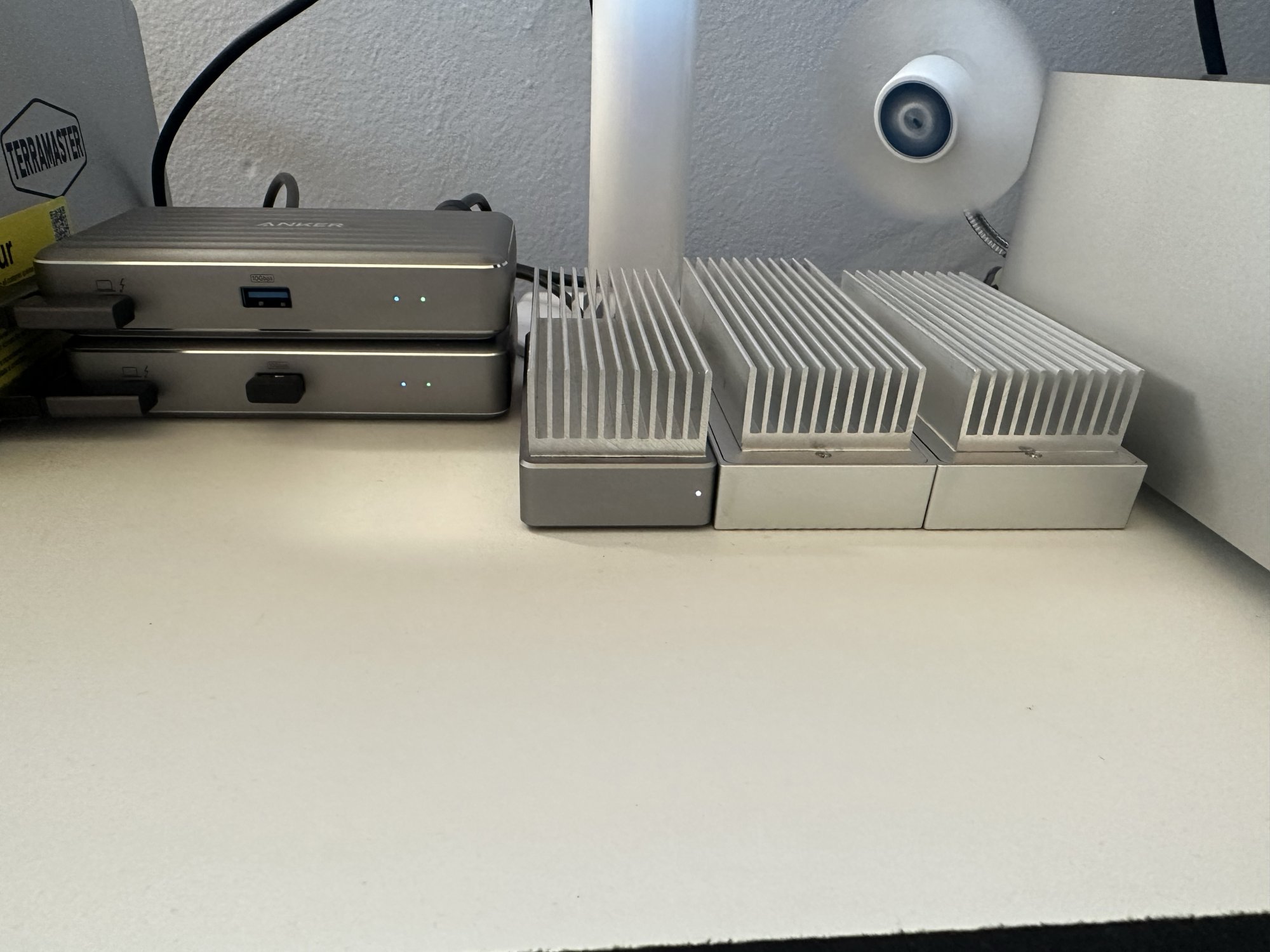

My humble setup using ORICO M.2 NVMe SSD Enclosure 40Gbps USB4. Top at 2.8GB/s. Each houses a WD black sn850x 4TB. I attach a heatsink using thermal tape then hook up a small USB fan ARCTIC Breeze Mobile which move considerable air to cool them.
I use a Terramaster 2 bay drive to get 16x2 TB of time machine back up.
Interesting. How much of a difference do the heatsinks + fan make, temp wise?
It comes down to 40C during load. I edit videos directly on those so it's a little warm to the touch and sometimes thermal throttle. With the heatsink, sustain load is fine. My room temperature is around 35C .
