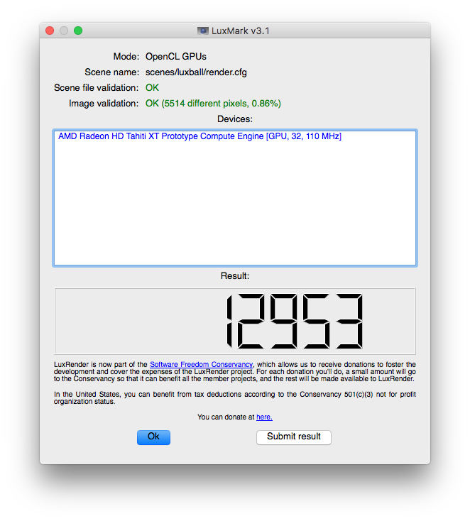

Atm, Radeon R9 Fury X is the best AMD card.

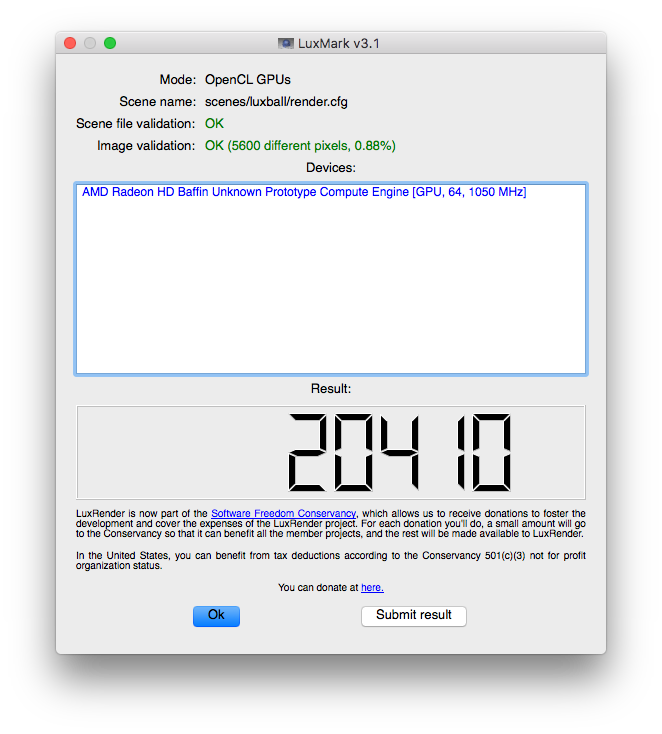

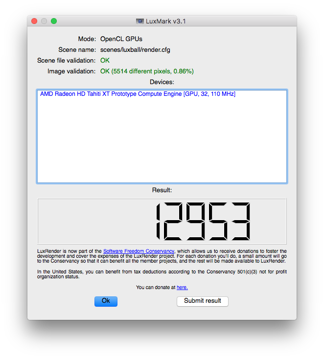

R9 280x (same as 7970) in macOS Luxmark 3.1

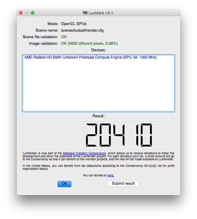

R9 Fury X in macOS Luxmark 3.1

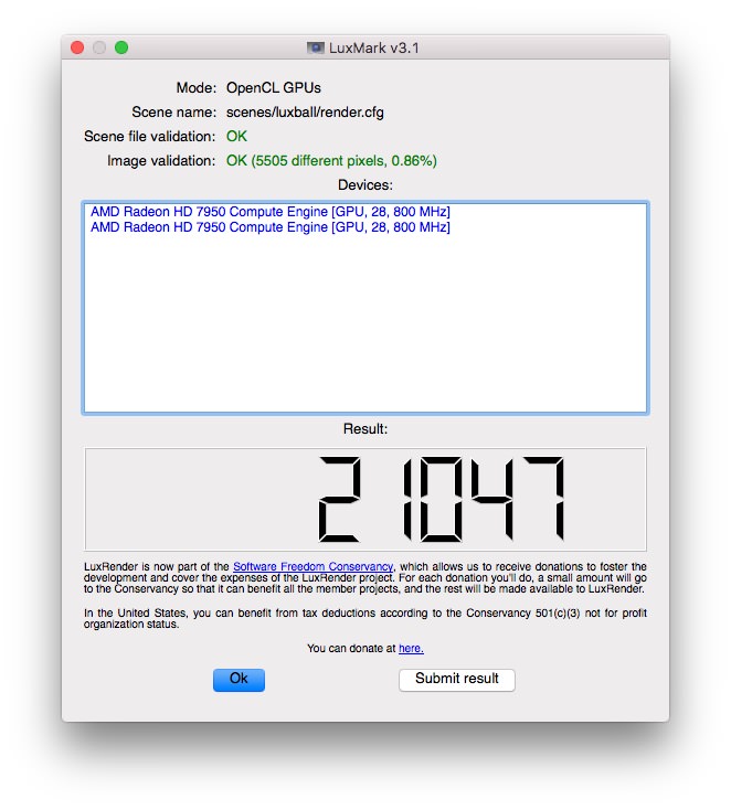

Stock clock Luxmark 3 result

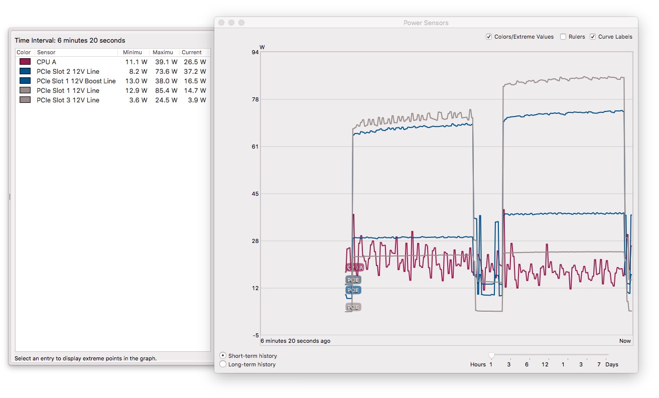

Power draw during Luxmark (LHS is the V2, and RHS is the V3, obviously Luxmark 3 is more demanding).

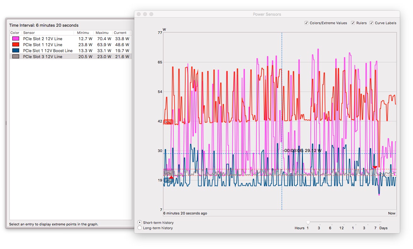

The power draw when rendering 4K video in FCPX. Even the peak loading is within the 75W limit.
FCPX 800:1250-1.jpg
