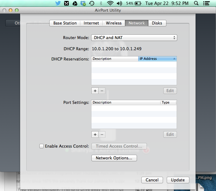

Sounds like you should have a relatively painless experience. As long as the Airport is set to DHCP + NAT (default settings I believe) you should be good to go.

*sigh can't get the wifi network working with my AirPort Extreme and surfboard SB6121. When I connect laptop directly to modem with LAN cable I can get online so it's not the modem or the comcast connection.
Did the change to DHCP + NAT and that didn't work. Something worth mentioning: I did two hard resets (holding a pin against the button) and the first time I did need to do the change from DHCP to DHCP+NAT and 2nd time I didn't have to. I wonder if even after a hard reset some settings don't change.
There are some troubleshooting threads on this subject out there. I'll see if any of them can help me.
Ok, got it working now. I'm posting this off my MBP connected via wifi.
I want to say what did it was the advice over here https://discussions.apple.com/message/22977599#22977599 . It said to plug the cable modem into the airport and power off and then on.
I did the DHCP + NAT thing before and also changed the DHCP range to matched what apunkrockmonk had in his thumbnail. And also the blocking of IPV6 based on something I thought I saw about the airport not liking that. I don't know.

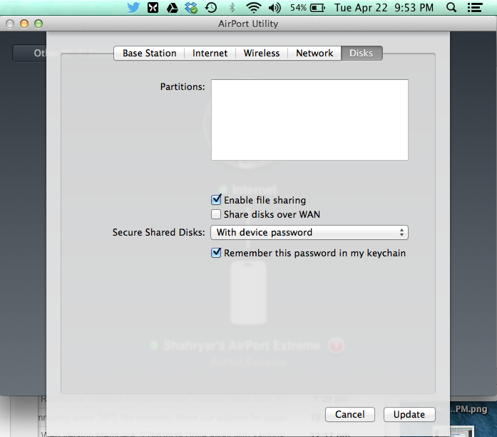

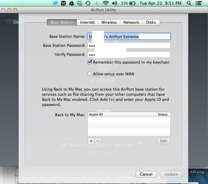

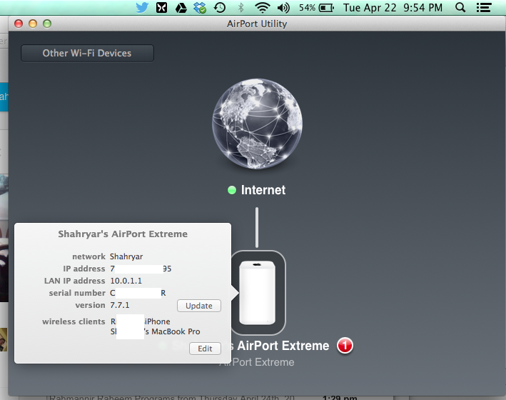

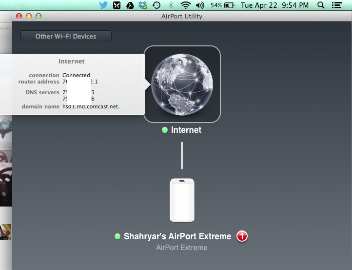

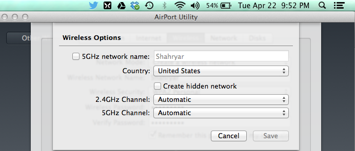

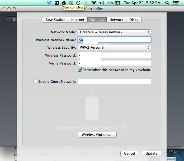

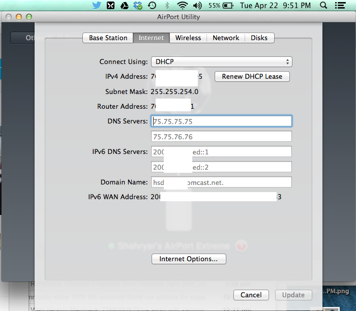

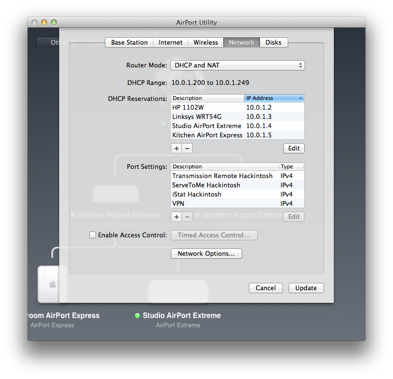

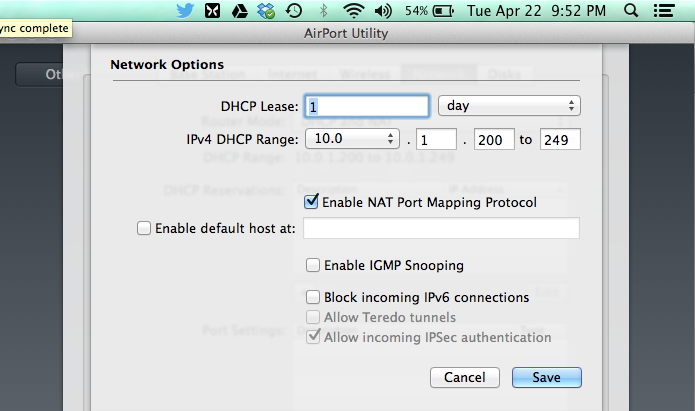

I've attached some screenshots with my settings. Maybe they can help someone else who struggles in the near future like me. Or maybe there's something I could and should improve.

More Thumbs from my Airport Extreme setup
Some more thumbs....
(Again, I cleared out any info that I thought was sensitive)
