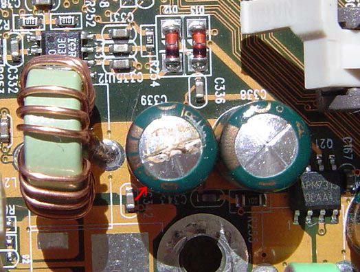

- Capacitor failure: This is probably the most common form of failure. Capacitors have two metal plates separated by an insulator... Electrolytic capacitors have the two plates tightly wound together; the insulator is electrically plated on - and the can contains a liquid. These have a limited life - they can leak, blow, short - they're sensitive to heat, over voltage, reverse voltage. Unfortunately larger capacitors are usually required in power supply circuits, which is usually a part of a circuit that gets hot.
Electrolytics often have a cross pattern on the top - specially weakened metal that acts as a vent if the capacitor needs to blow (rather than exploding!). Often blown capacitors will be domed on the top - and you can see where this vent has broken open:
