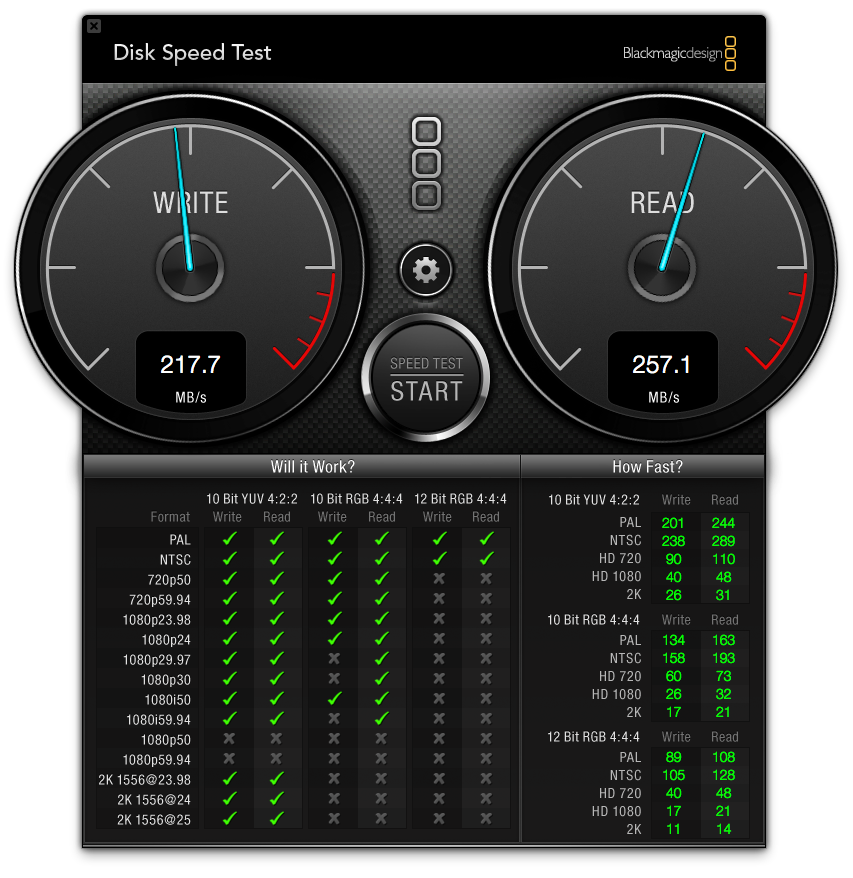

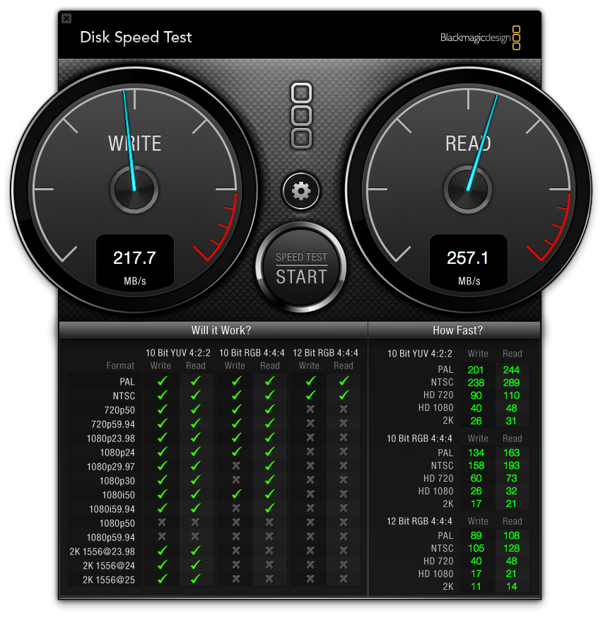

Alright I installed the OCZ 6G hard drive...so far nothing wrong but I do not know if these speeds are correct. Some others have posted in here around 500 MBPS for both read in write but my OCZ is going up to this...does this sound right?😕
If it was bad what would I notice exactly?
How is this bad at all? Those are excellent speeds. You can't always believe the exact numbers that benchmarks give you, some are more accurate than others but not all are precise. There's nothing wrong with your SSD 🙂 Consider yourself lucky.
Well that is why I am asking. I mean I know it is supposed to be in the 500's...and other people have posted in the 500's so I thought perhaps being in the 400's is not correct?😛
If you think about it, you're running tests on the drive that you're currently using, which means that those speeds aren't the true speeds of the drive, rather the "real world" speeds. If you want to know the true speeds, you'll want a better benchmark software and a way to test the drive from a different drive. 😀
