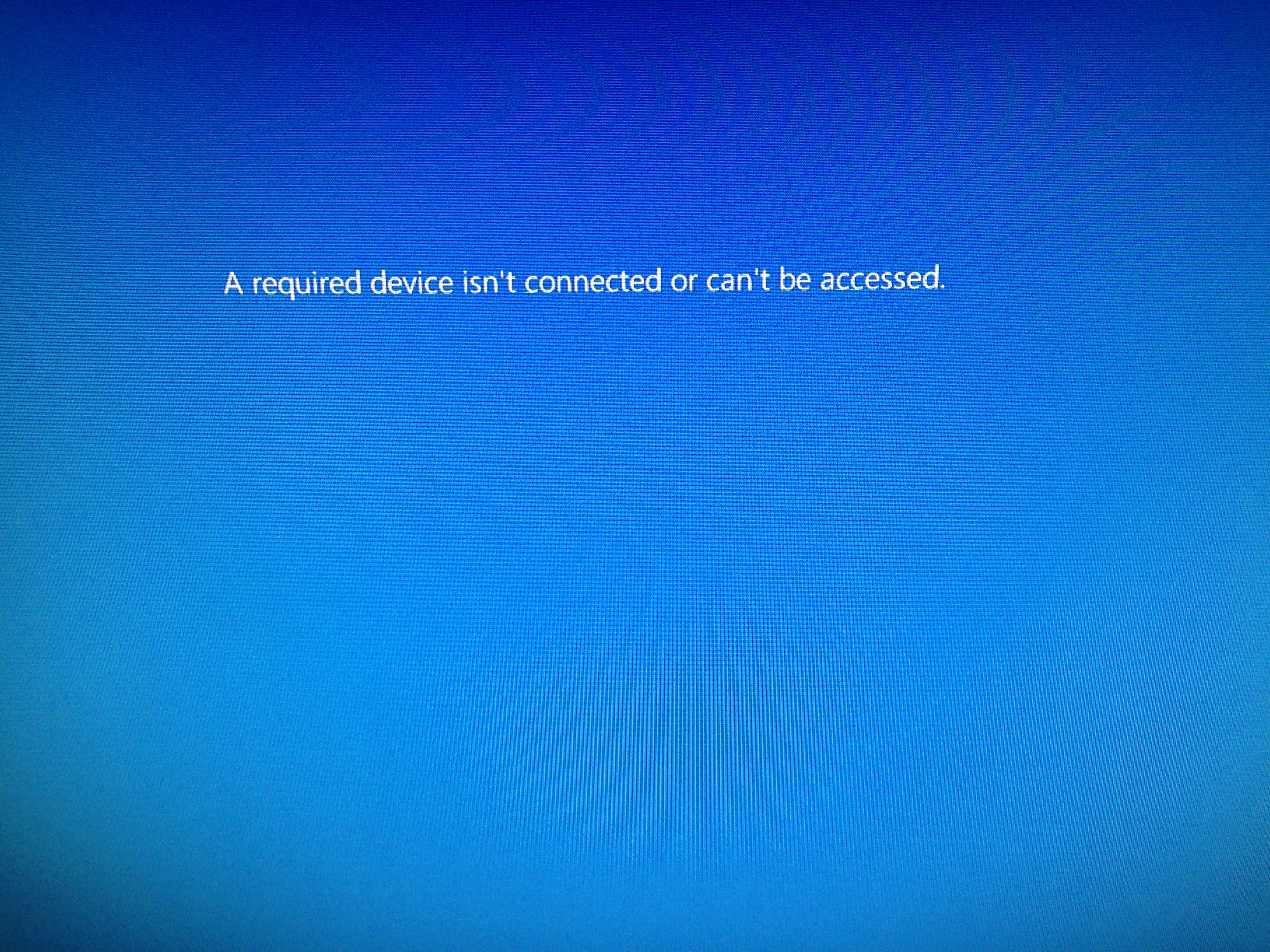

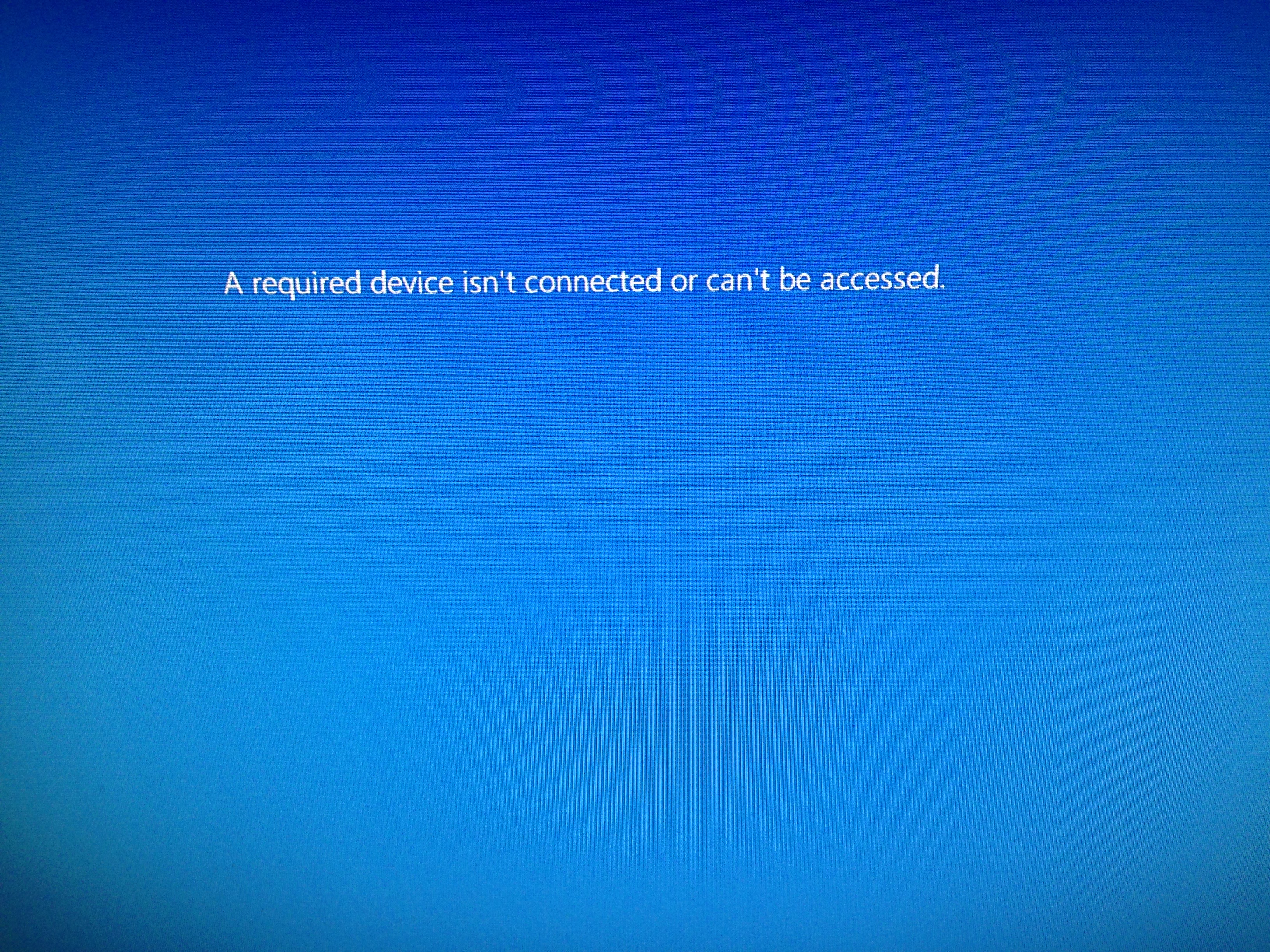

I've tried quite a few times to install Win10 with EFI boot and failed miserably with the following error
That was until Squuiid told me that one of my PCIe cards has BIOS. So I removed my MSI R9 280X (the only PCIE cards in my Mac), put back GT120 and I installed Win10 EFI with no problems.
I could even install it with R9 280X in place as long as I used GT120 as my display card. But once I installed the drivers (for both cards) I couldn't boot into it anymore.
So, since then I have tried flashed bios and original UEFI ready bios in my R9 280X and results were the same (blue screen above), Im wondering what card are you using with Win10 EFI?
Are all R9 280(X) problematic, or did I just do something with my ROMs when flashing them for boot screens?
So, to repeat the subject :) What GPU are you using with your EFI installed Windows on MP4,1/5,1?

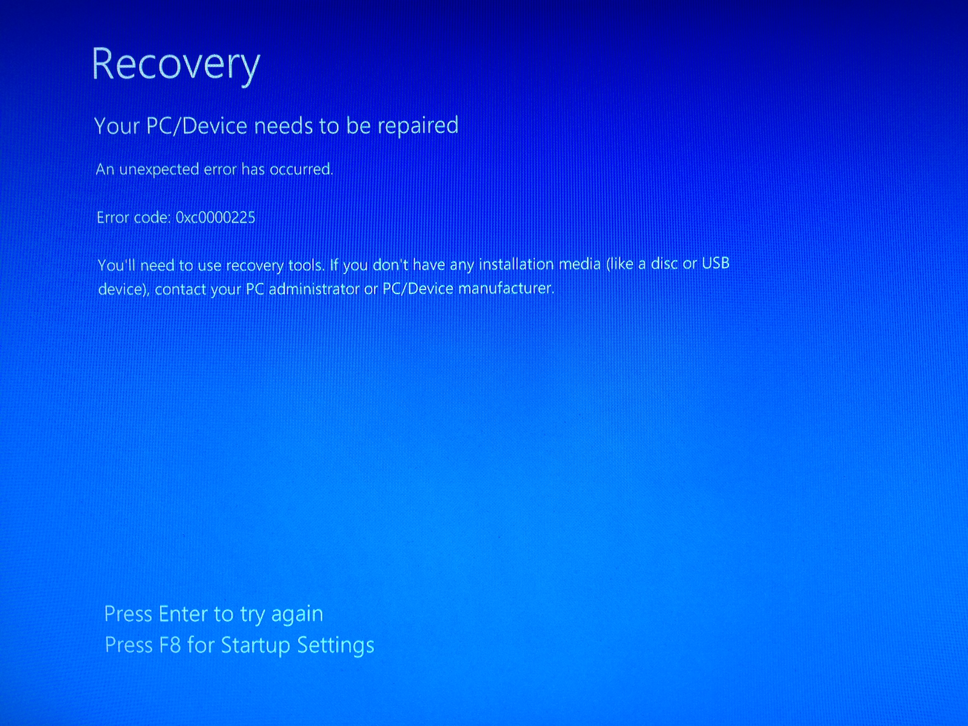

Well that was I guess, since I could, without any problem, boot into Windows' "EFI Boot" with stock GT120 (fullHD resolution of installer, AHCI mode on disks, boot drive partitioned as GPT and all...) but with R9 280X installed (flashed ROM or not) I only get that blue screen I attached in the first post.
You think that something else could be the cause?
Edit: The main thing I'm trying to figure out is if the problem is in homemade EFI ROM :) or card itself. The same way they didn't sort that millisecond glitches I have in 2D usage of the card.

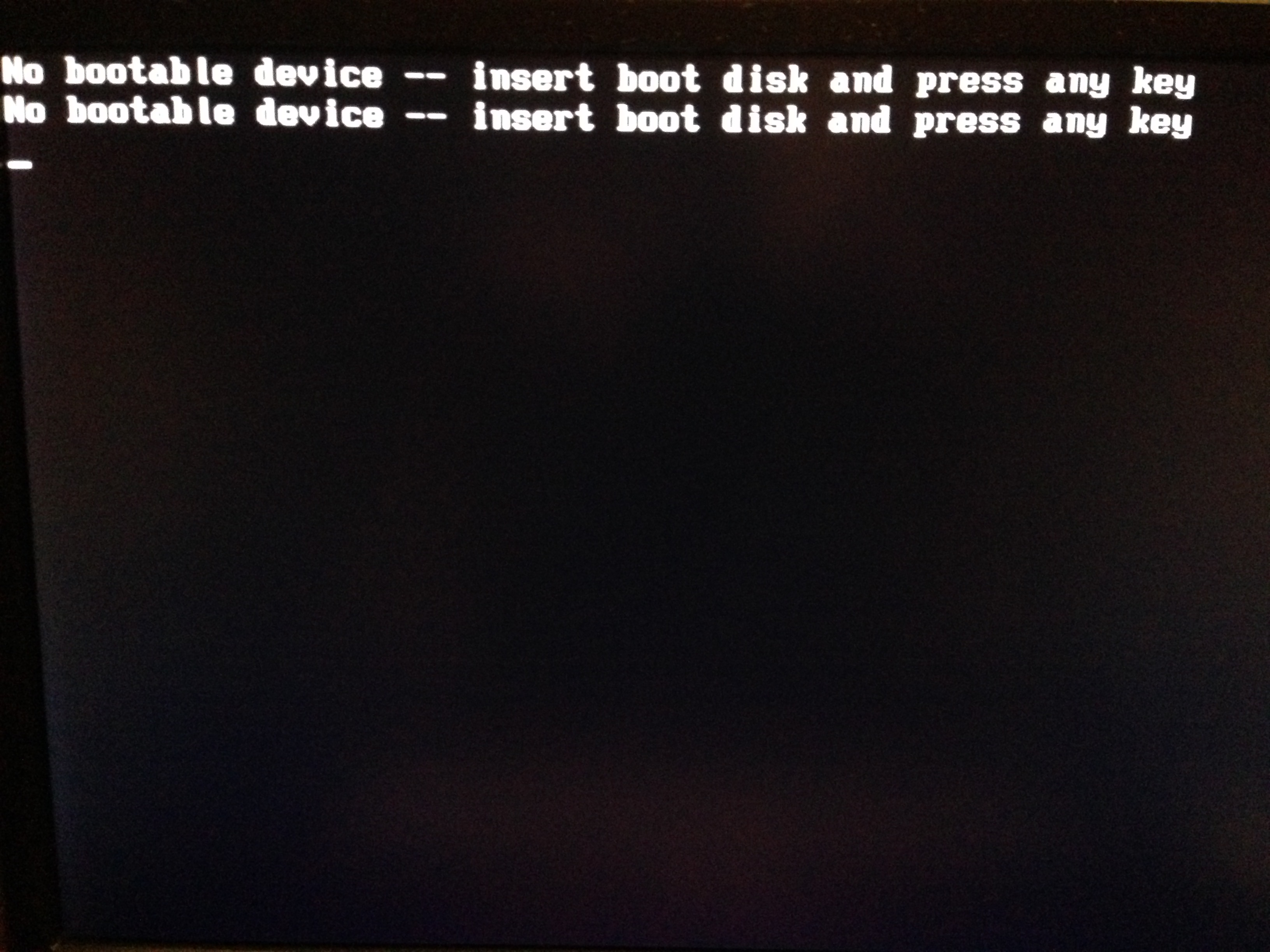

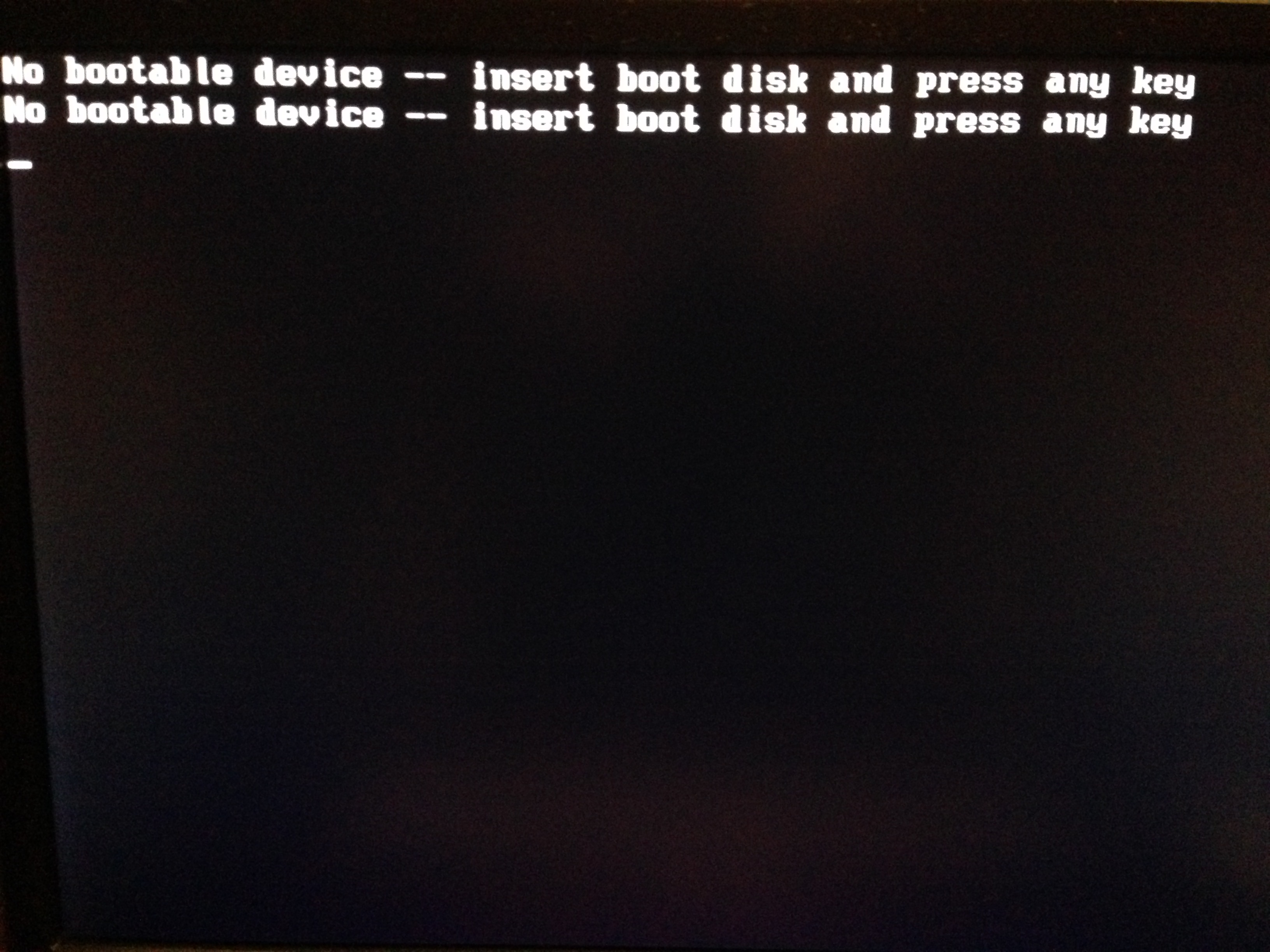

So last night I tried one more time with MSI UEFI rom (it was overwritten) and everything I could get is this
That is a definitive no go then :)

If I try to boot its with EFI Mac bios I get this message

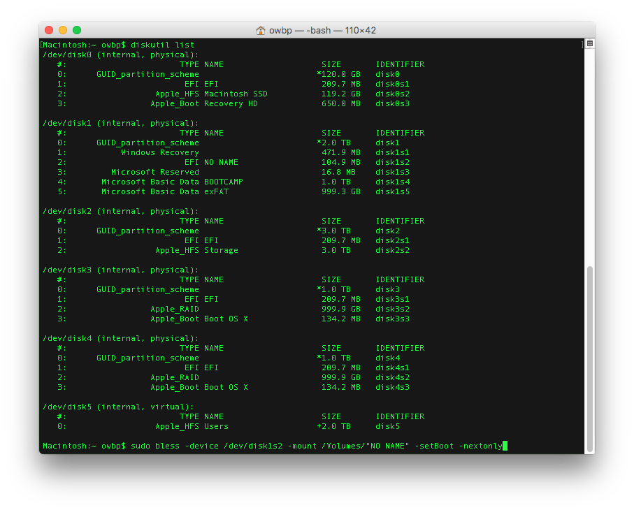

So, I'm left with blind booting, using BootCamp Control Panel in Win 10 and using terminal bless command in OS X.
