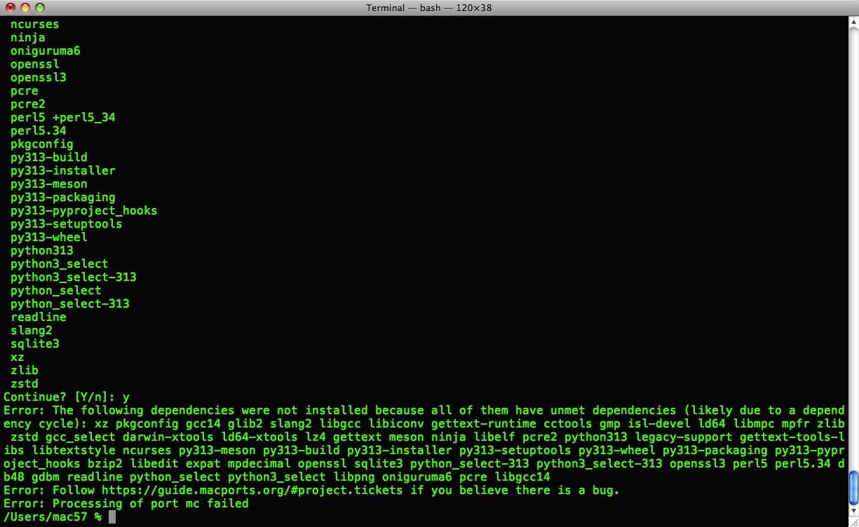

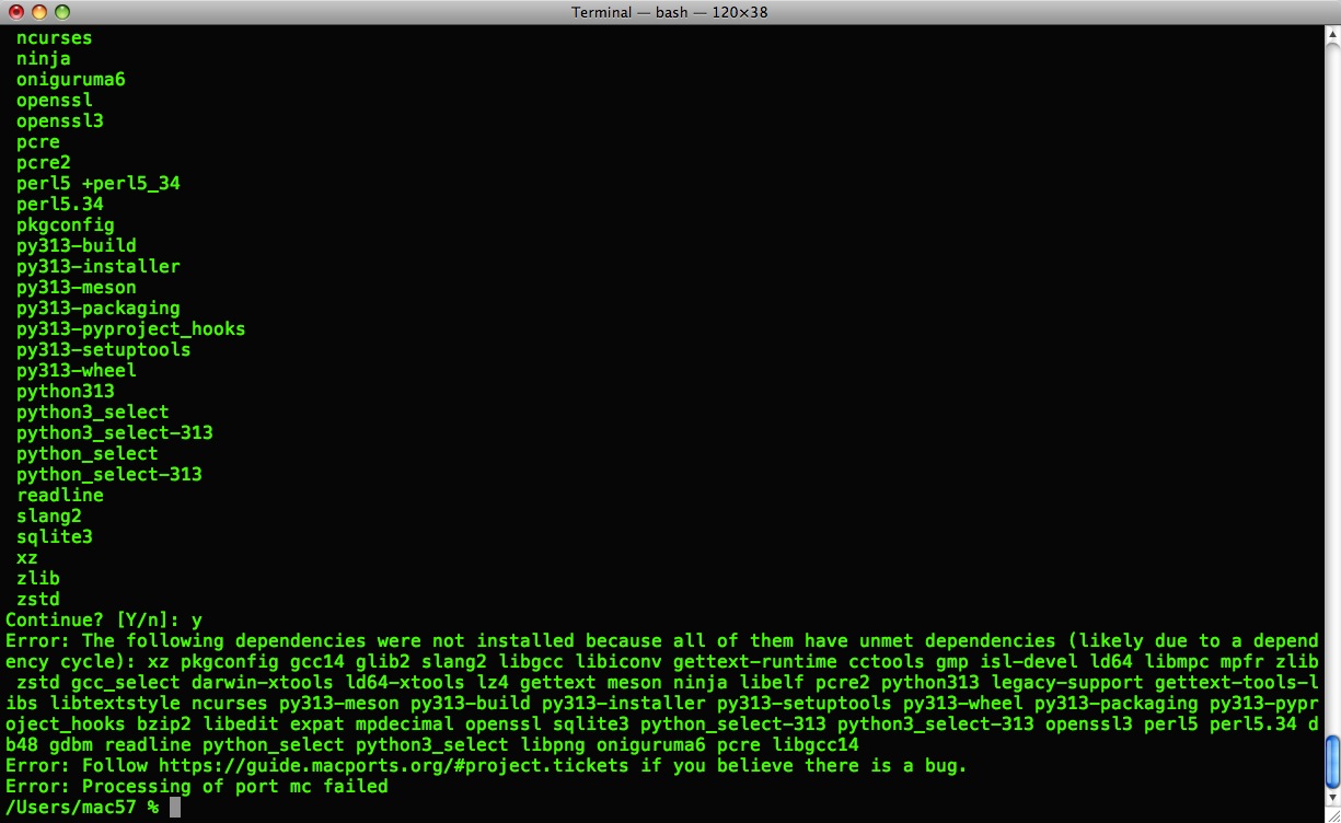

OK, I am stuck right out of the starting gate!
I apparently successfully installed PPCPorts and all the associated tools, but whenever I try to build anything (I picked on Midnight Commander (mc) as a starting point) I get the following:
Does this tell anyone anything?
Immediately before it does the above however, it kicks out this warning:
Warning: archive_sites.conf: no urls set for macports_archives
I thought the whole point of this is that it computed the dependencies, built them all and then you eventually get the build that originally kicked the whole process off (mc in this case).
Thanks!
there is a circular dependency somewhere.
Port A depends on Port B.
Port B depends on Port C.
Port C depends on Port A.
so impossible situation.
Trick is to figure out what got screwed up.
Usual approach is to start with the simpler deps, pick any, like zstd, and start installing those until you hit the circular dep.
Thanks!
Ken is giving a good advice, install sequentially. Testing on 10.5 was limited (both on my side and MacPorts), so something might have been messed with dependencies.
Try doing this:
Code:
sudo port deactivate active
sudo port -v sync
sudo port -v install gcc10-bootstrap
sudo port -v -N install cctools ld64
sudo port -v -N install libgcc14 gcc14
sudo port -v -N install python313 meson
If this works, proceed with the rest. If this fails, please let me know where exactly.
Installing gcc and python was working on 10.5 last time it was tried. I am away from powerpc hardware until 28th, so cannot check myself right now. (Unless someone gives me ssh / gsocket access to a machine with 10.5.)
P. S. It is not clear if you already have gcc10-bootstrap installed or it got left out of the chain somehow (which will create a problem). It is used to build gcc14, so it must come prior to it.

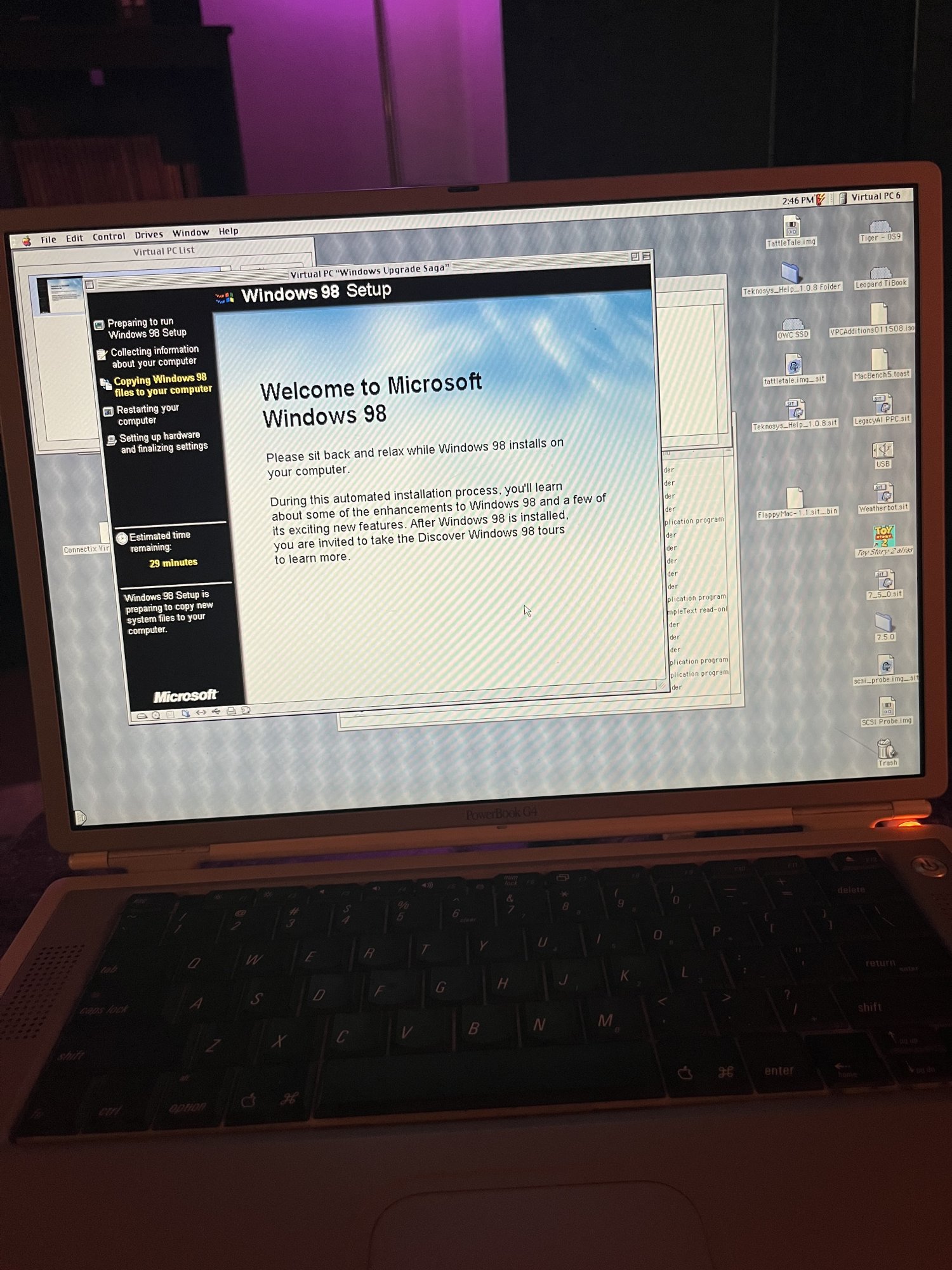

Today I’ve decided to take a page out of MichealMJD’s book and use my boredom to install and upgrade Windows as far as I can. Except I’m doing it on a PowerBook G4. I started at 3.1, and am on 98 now.
This is a 1GHz TiBook, with VPC 6 running in OS 9 so I feel like its fastest possible way to do this, lmao.
The goal is XP, and if that goes well maybe 7 but that’ll be pushing it.
Why? No idea. Because I can

I've found Windows 2000 to be the sensible limit - I've installed Micro XP before for the odd app necessity but it's slow, full XP or beyond is merely POC.
Yeah that tracks. This isn’t a sensible thing I’m doing though lol.
98 finished and then I had to leave for thanksgiving at my parents place. But I’ll be continuing this.
95 and 98 are surprisingly quick though. VPC 6 and below are faster and OS 9 has a lot less overhead. I’ve ran 98 under VPC 7 on a faster G4 than this before and it was always dog slow. I think Microsoft purposely made that application worse.

Small update. I started over. I got up to Windows 2000, but the install was somewhat borked. I'm not sure if it was from expanding the partition beyond the original 2GB, or just Windows rot from in-place upgrading so many times. The Win 2000 install also made me skip a bunch of things, all appeared to be related to IE 5 though.
XP kept failing with some registry error stating access denied. I now have a better plan in place to resize the 2GB to the full 60GB of the VHD so, once I get back up to 2000 I'll try again and see what happens.

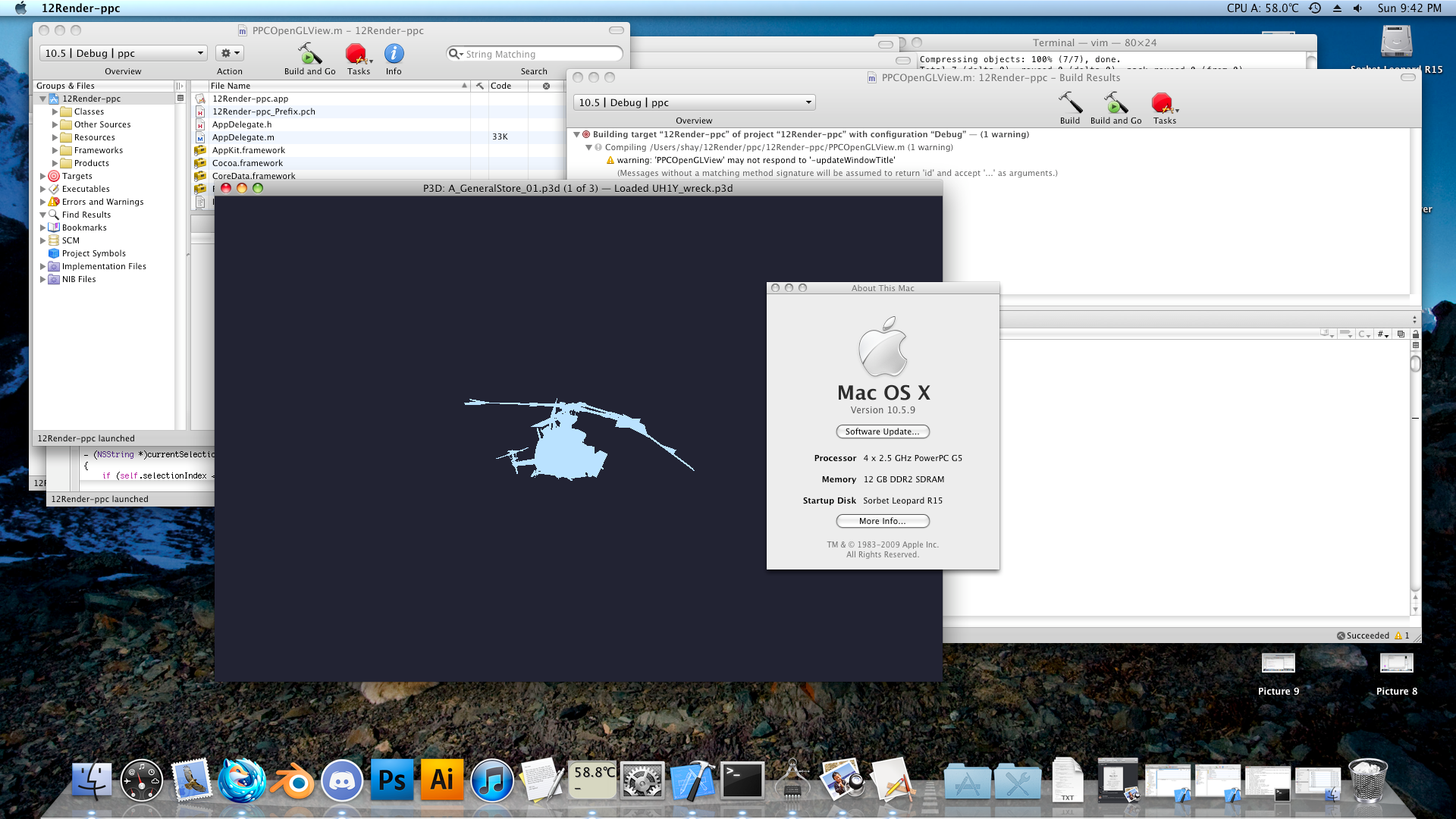

A P3D file format viewer I've been making for PPC Leopard. Simple Cocoa app with an OpenGL view that loads MLOD P3D files and associated PAA textures from Bohemia Interactive games (Arma, DayZ). I work on DayZ mods for PC so I was already pretty familiar with the formats. Got bored and wanted to see if my Quad could handle Arma models. May release it once I fix some bugs if anyone wants to play around with it. Kinda new to this so idk what else to say. I used Macports to install git and some other basic stuff I needed. Pretty cool considering it's a 20 year old machine.
View attachment 2584086View attachment 2584087

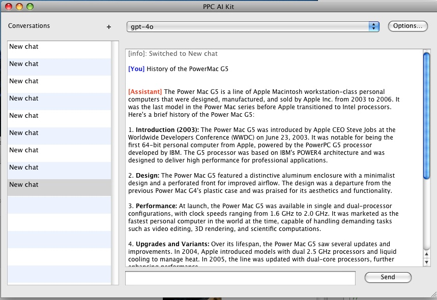

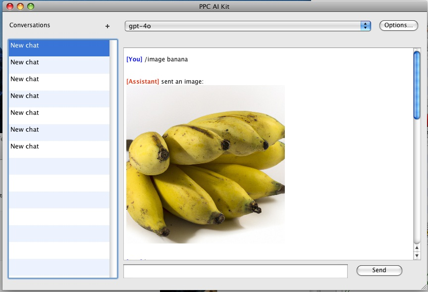

I've also been working on a chat tool for AI models that supports OpenAI, Claude, Gemini and local OpenAI-style APIs with image generation support, Markdown formatting etc.. I took a look at that "LegacyAI" app recently and I wasn't too impressed with the shareware model (although I do understand why they do it like that) - this is just as simple as plug in your API keys or your local inference server and go. I could see this being more useful to the average user than my other project.

I've also been working on a chat tool for AI models that supports OpenAI, Claude, Gemini and local OpenAI-style APIs with image generation support, Markdown formatting etc.. I took a look at that "LegacyAI" app recently and I wasn't too impressed with the shareware model (although I do understand why they do it like that) - this is just as simple as plug in your API keys or your local inference server and go. I could see this being more useful to the average user than my other project. View attachment 2584349View attachment 2584348
