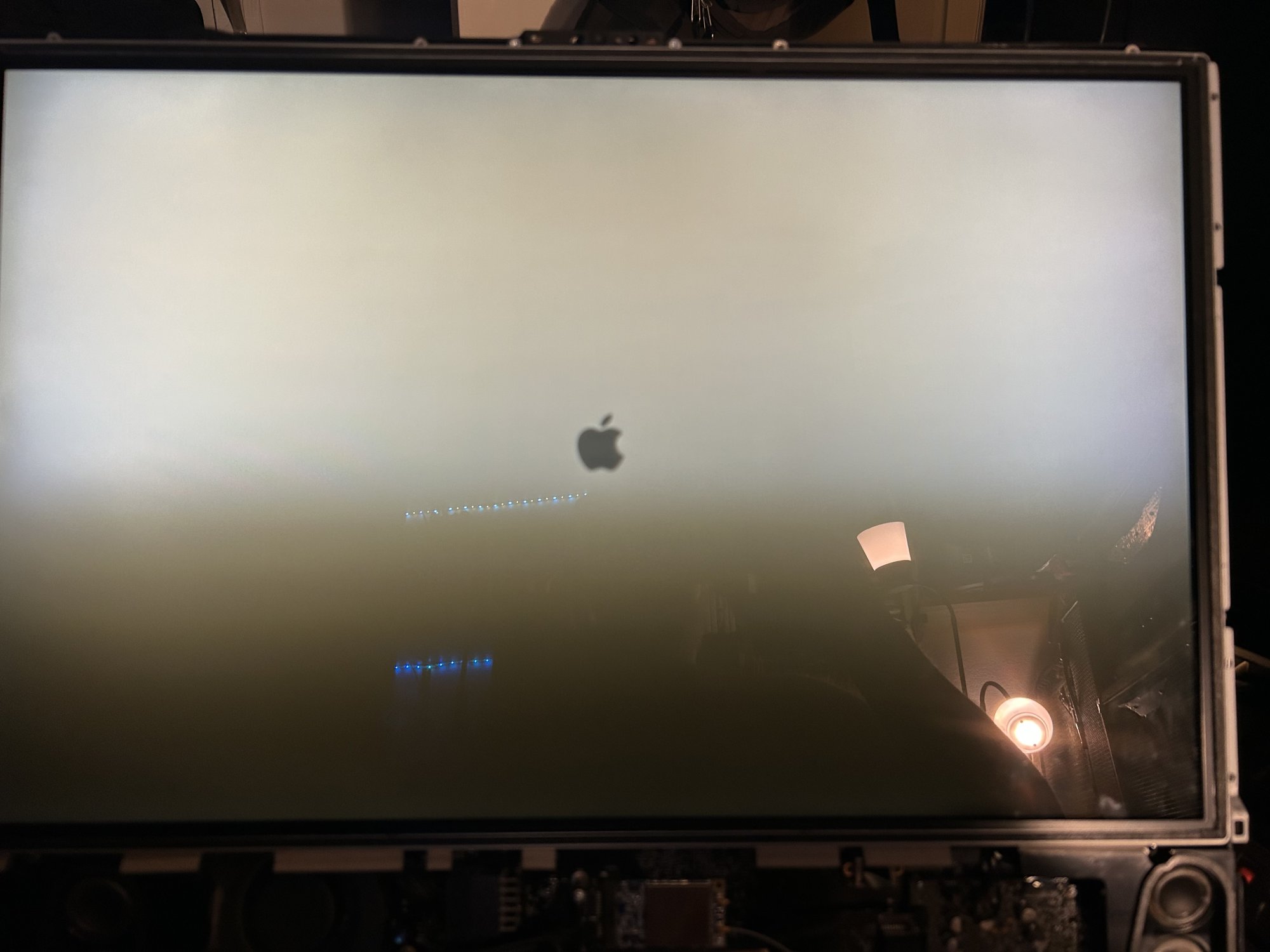

Bummer. The replacement screen I picked up for my kids iMac has a bad backlight.
On the bright side, I picked up a cheap lvds cable and they sent me two lol + the seller refunded me right away which was very nice of them. I assumed they would want me to send it back to them but I offered to take it to recycling and they said that was fine.
Bummer about the screen though. I thought I was done with this project & the kiddos would have been happy to have this biggun back on their desk.
The search for a replacement lcd continues 😉

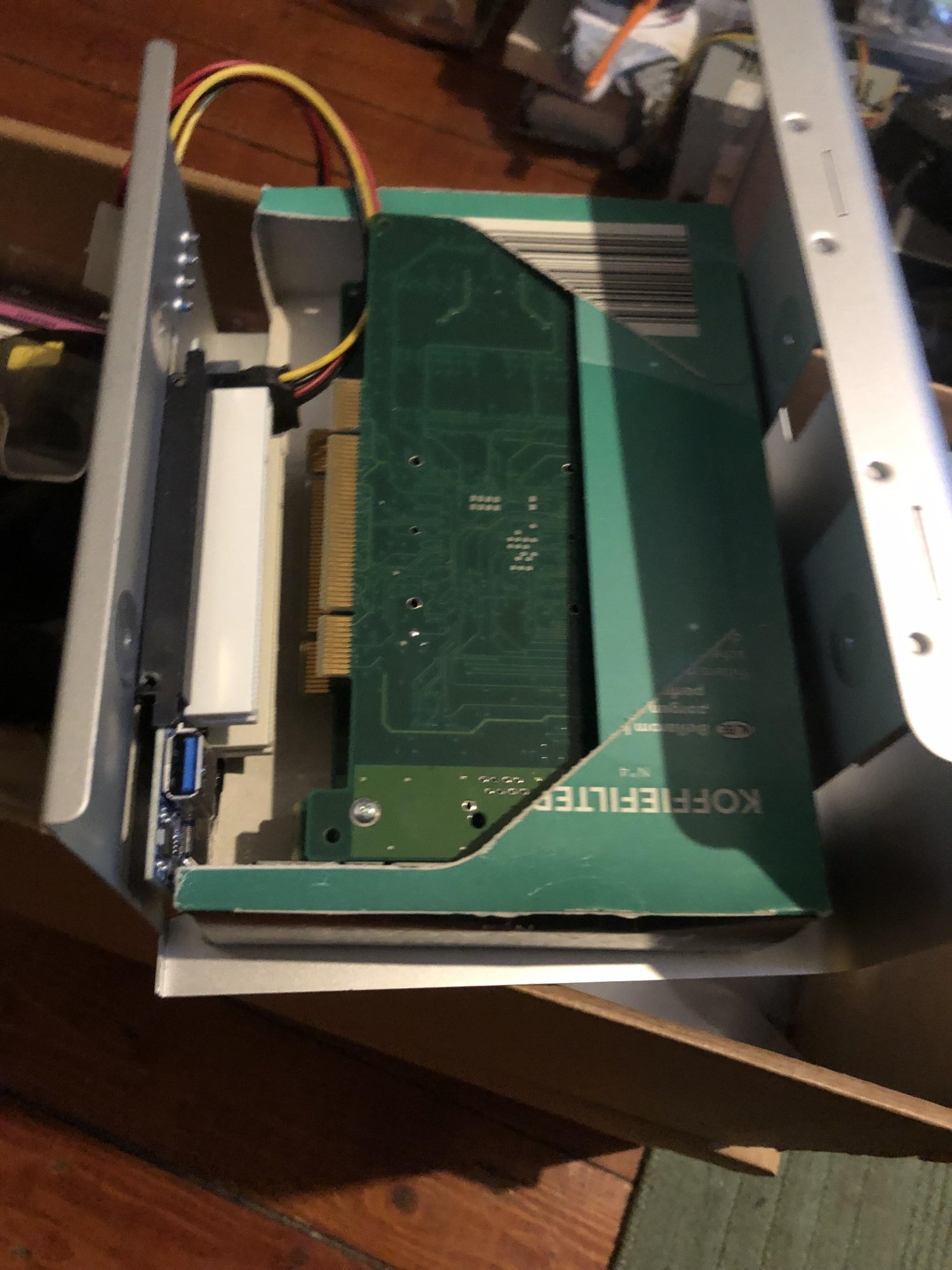

2 mac pro's 1,1 have ahci m2 ssd's now. Need to test the new 512gb drive from china on drive dx but the other one looked like new health wise. A lot faster than the sata ssd's.
Been trying my uad cards in them but that has been a struggle. i have 2 uad1's and 2 uad2's. Now i have 2 uad's in the optical bay with an pcie to pci extender but need to authorise only 1 card first and then add the second. I think. They are not linked in myuad account so running them together and then authorise give errors. All though they both are seen in system and uad control app. For me kind of wild because they act like magma box and i have never seen people do this before.
Also these 2 mac pro's 1,1 will house 2 sets of 2 mirrored raid hdds as servers. Looking into fibre vs copper.
