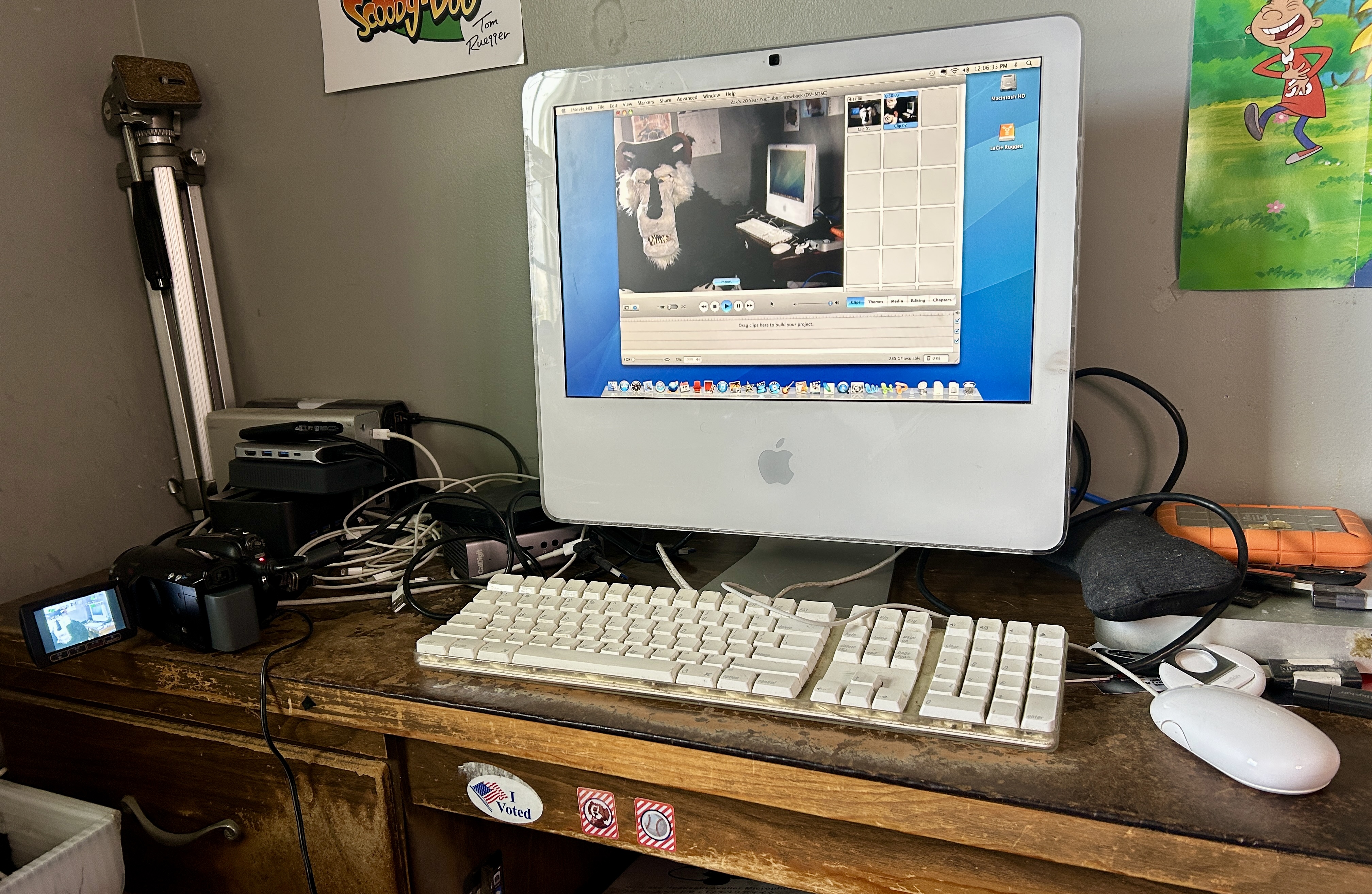

For a fun little throwback, I produced a quick Zak Wolf vlog in the style of how a YouTube video may have been made 20 years ago!
I used my 2006 Core Duo 17" iMac (1.83 GHz processor, 2 GB of RAM, 160 GB hard drive) and edited the 4:3 standard-def MiniDV footage on iMovie HD 6! I don't have a working MiniDV camcorder from the mid-2000s, so I took a creative liberty by setting my Canon Vixia HV40 to standard-definition 4:3 DV mode. The quality is still somewhat better than it would be on an actual Optura or ZR-series camera of the time.

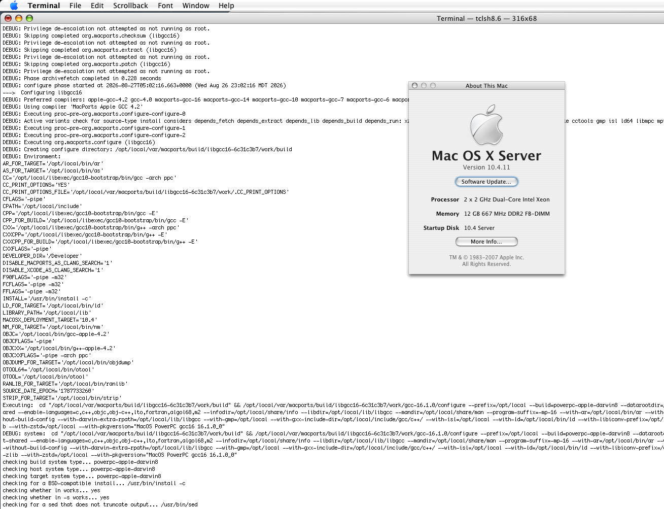

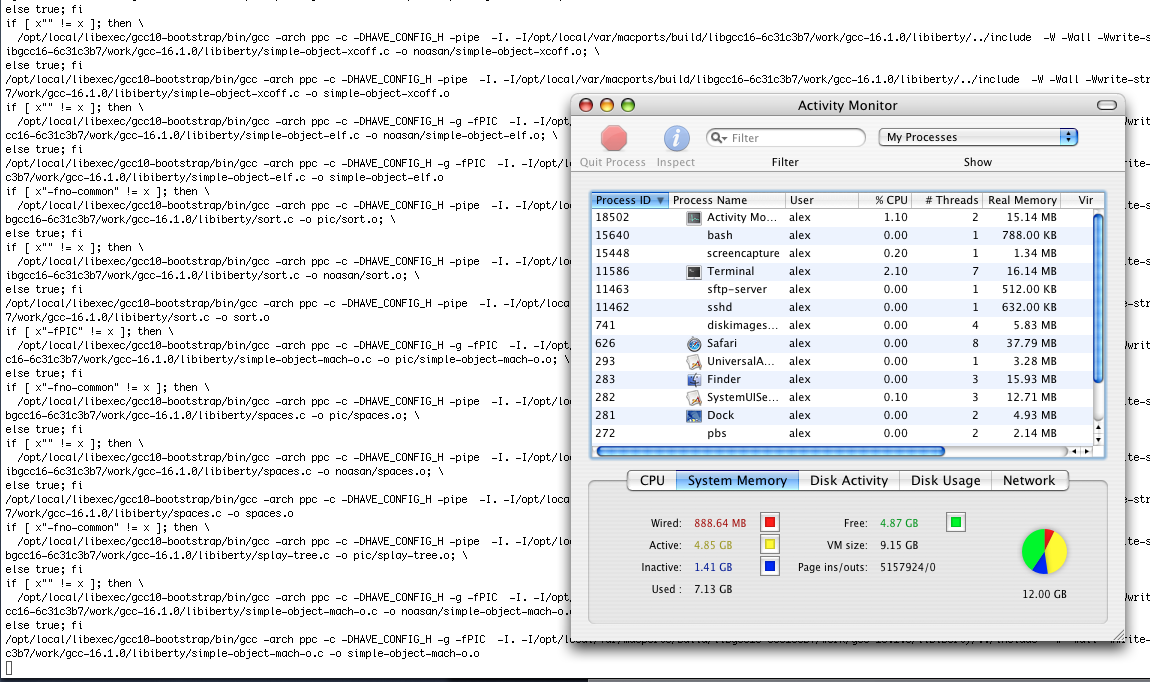

GCC16 really, really doesn't like being compiled on a dual G5 2ghz with 4GBs of RAM running tiger. After weeks of failed build attempts (running out of memory even with 1 make job or 4 make jobs, etc) I have installed tiger server on another HDD in my Mac Pro and have resorted to dedicating that install for using Rosetta to build specific PPC software. It's weird because gcc16 is known to work on a G4 with much less RAM on Tiger, and also on Leopard with the same dual G5 2ghz 4gb ram hardware config.
It's almost certainly just wanting more RAM on a dual G5 system then what I can make available (building GCC16 is one of the most insane things you can make a computer do) and Tiger isn't making it happy for some reason without it.
Once binaries are available I can just use the G5 to build PPC software (Rosetta can't build everything from intel targeting powerpc, but according to @barracuda156 it certainly can do GCC16).

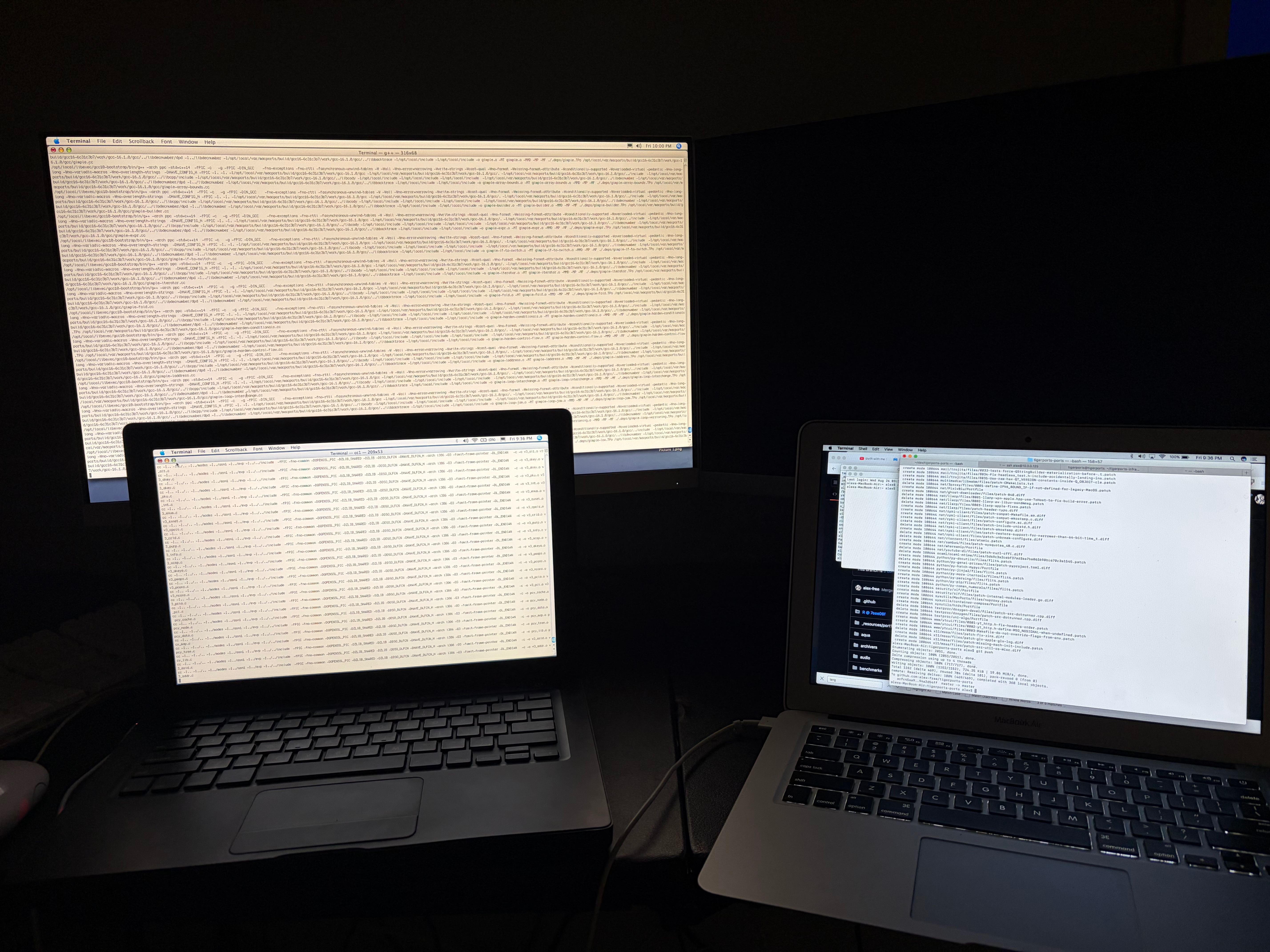

(back) building gcc16 via Rosetta on tiger server (finally have libgcc16 for PowerPC, now just the actual compiler).
(Front) need to test some intel fixes for tigerports so using the 2007 MacBook also running tiger server.
(right) MacBook Air 2017 doing some git stuff merging my PowerPC ports branch with the macports ports tree on 10.12

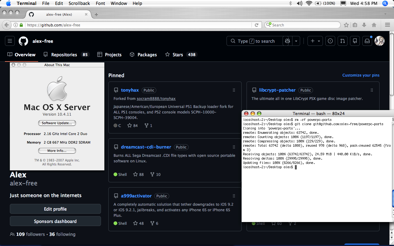

Finally stopped being lazy and started writing my "Guide to Tiger Development" which explains how to replace tiger ssh with modern ssh, configure git to work over ssh with your github account so you can push/pull/whatever directly from tiger, etc. I can write it in markdown, gen html with cmark, and upload it to my website. Another awsome thing is https://github.com/alex-free/github-ssh-setup is confirmed now to work on every Mac OS X version since 10.4. I mean how cool is this
