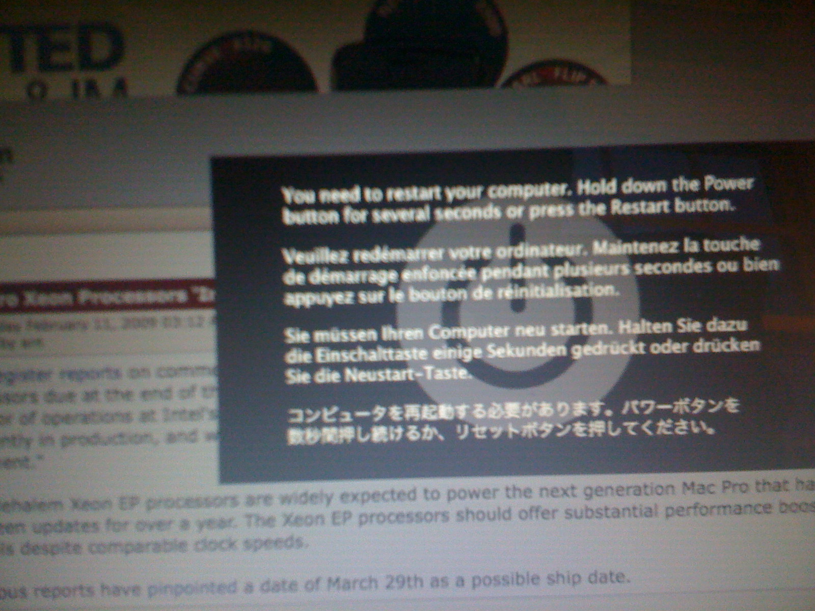

I just got the Alu MB, and I've been having some serious troubles.
1. Incredibly flaky wireless. Safari won't even use WiFi correctly, Firefox works 90% of the time, but sometimes it just kicks my WiFi off. Same with Windows XP in VMWare.
2. Some slanted keys.
3. Above all, I'll be in the middle of doing a project, AND IT WILL DEMAND I TURN IT OFF? Why!? Why would I want to turn it off? It makes me for god's sakes, and I lose whatever I was doing. See the picture attached below, it's happened half a dozen time in five days, and no way to stop it.
4. If I leave it in sleep mode for like five hours (torrenting, won't torrent in sleep mode) and I try to wake it afterwards, it flat out won't. I have to force turn it off, and reboot it. Is this normal?
Ugh. Refurb btw.

ooooh. that's bad. that screen is the mac equivalent of the blue screen of death. aka "kernel panic"
this means that there's something REALLY wrong. given that you're using torrents, are you using legitimate licensed software? it would be a software problem.

Kernel Panic
When it demands you turn it off what's going on is probably a kernel panic for more info look it up on wikipedia, if it is still under warranty I would recommend returning it to Apple.
Run a hardware test. It sounds like your wifi could be causing an issue. But if that doesn't come up with anything I would recomend re-installing OSX and start from scratch.

Torrenting isn't bad. Torrenting is a very good peer to peer way of sending and receiving large files over the internet. Because of this, torrenting is often used to distribute illegally obtained software or movies. While all the ethical reasons are there for calling this bad, this wouldn't cause kernel panics, no more then when using torrents for non-illegal issues.
There is however something really wrong with your MacBook, as kernel crashes are not supposed to happen this often at all. In all my experience with Mac (about 5 years now) I only experienced this three times, of which 2 were inflicted by my own fault (something to do with modding a videocard to play nice with my PowerMac G4). In your case some software or hardware is causing the kernel of your system to crash. You could try and find the source by looking into the logs, or you could try a fresh install of Mac OS X and see if it still happens. If so, it is hardware related. If not, it was software-related. Then try to remember what software you installed just prior to these panics, and most likely that will have something to do with it. Your third option is to take it to an Apple Reseller, since Kernel Panics that often are not supposed to happen. This means you are able to get that much loved applecare. Probably they will be able to find the cause.
