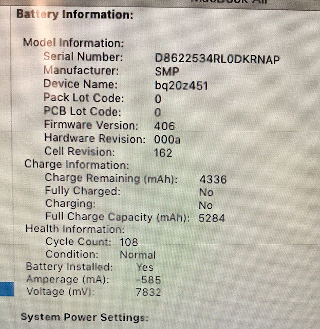

I bought a used 2012 13" MBA on ebay. It was listed in good condition, everything working etc. The machine is in great shape. The battery says 79% health. Is this acceptable for a laptop listed in good condition? 108 cycles FYI.

Yes, using an battery health app. I reset the PRAM and SMC.
See stats attached.

After 108 cycles, I'm surprised it's down to 79%; however, that could be normal depending on the age of the MBA.
Which MBA do you have?
I have a mid-2013 13" with 454 cycles, design capacity is 7150, capacity is down to 5883 mAH (82%), and battery manufacture date is 2014-01-05 as per coconut battery app.
Mid 2012. Battery date is June 22, 2012. I wonder why it's in such bad shape with only 108 cycles? Constantly plugged in?
These batteries will lose capacity over time, regardless of whether they are or are not used.
In your case, I would say that 79% is not bad at all.

The 5 year battery age contributed more to the 20% capacity loss than the # of cycles obviously.
Heat & cold cycles over its history can also affect battery health. Maybe it was rarely fully drained, albeit that's less important in modern lithium cells than it used to be.
FWIW, drain your battery fully, then reset PRAM/SMC and fully charge it while not using it at the same time.
$440 is a good deal. I wouldn't bother replacing the battery until it hits 60% or less.
Batteries are unfortunately the consumable part of every electronic gadget and need to be replaced eventually.
I have a friend that used a white MB from 2006 until 2015 with the orig. battery, down to less than 15% capacity, but she didn't travel further than from kitchen to living room, so having it always plugged in gave her 9 years usability for light work. Somebody still gave her $75 for it.

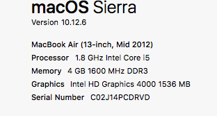

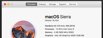

This is great information. Thank you, it's much appreciated.
It's the latest version. I mean under "About this Mac" it just lists it as Macbook Air, and then 1.4GHz i5 (which is Early 2014). Beyond, that it doesn't really specify "Early 2014" anywhere. Model Identifier is 6,2
Strange that it doesn't specify "Early 2014".

I believe so. I got it used a few months ago and even online, some people report the Early 2014 not showing up in the "About this Mac" section.
Does the serial number match the serial # printed on the bottom of the Macbook?
The serial number from your screen shot indicates that it is a mid 2013?
