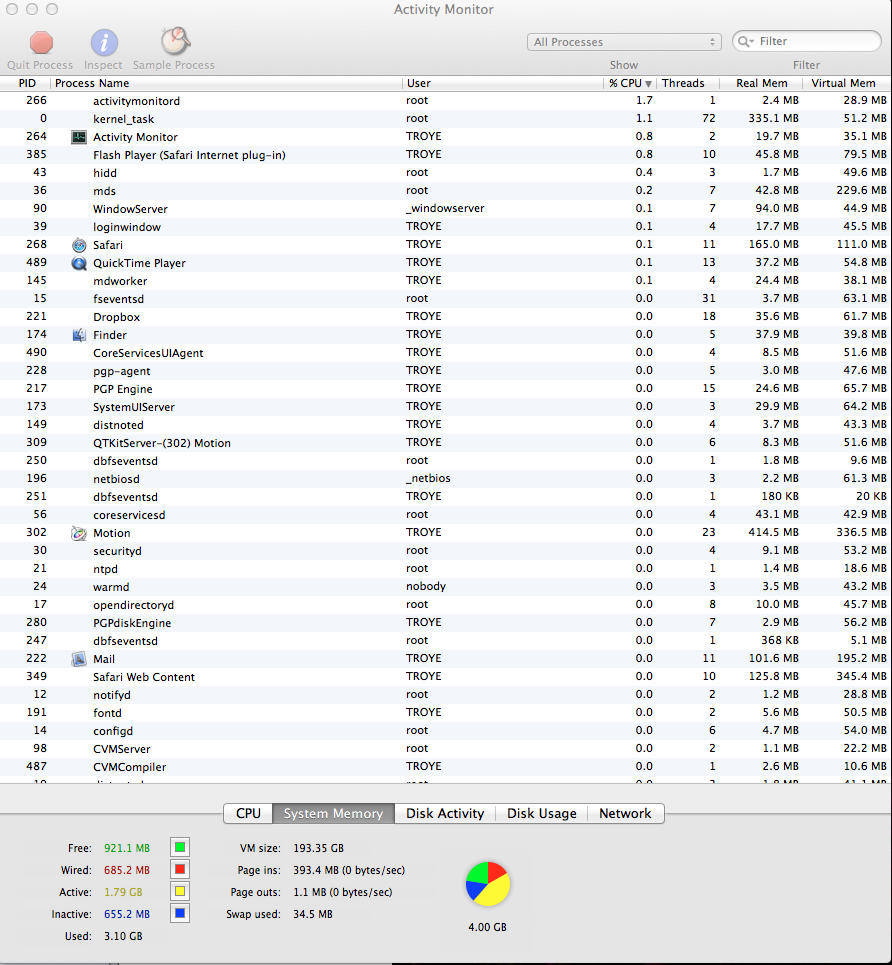

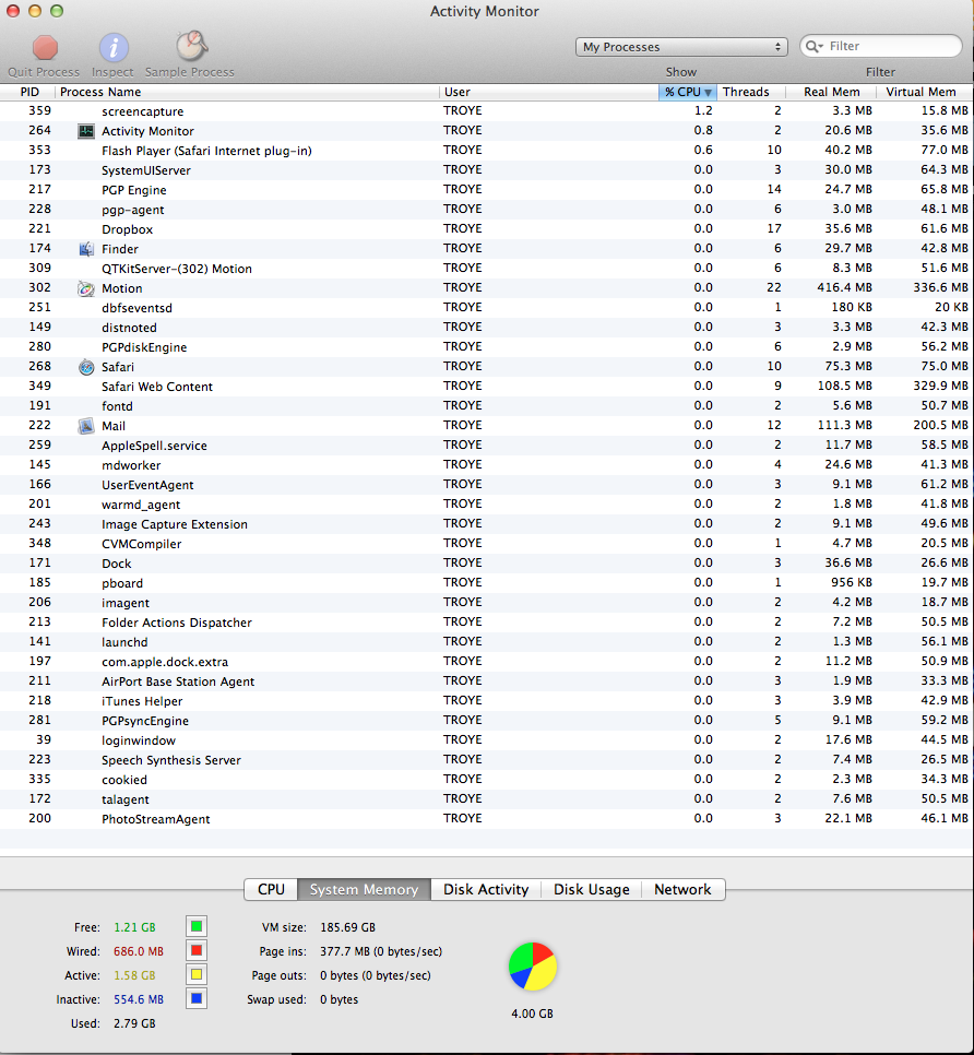

Here is the screen shot

Not really, because you still have nearly a Gig unused. Neither program is paging VM at any particular heavy rate, so a lack of RAM is not your bottleneck, and more RAM will likely not help.
The best thing is to run them separately; if that is impractical, you need a bigger boat.

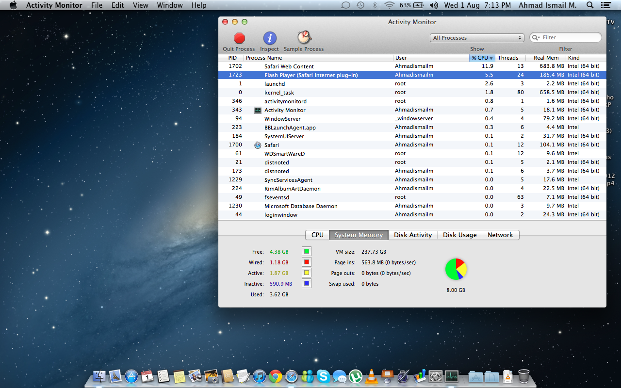

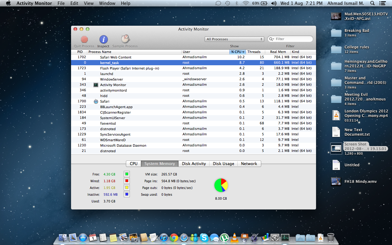

Hi there. This is my screen shot. My kernal_task goes up to 700MB sometimes when I have no applications open whatsoever other than finder, activity monitor and safari. I just want to know whether it's normal or not, because I know RAM has nthing to do my MBP's performance as I upgraded it to 8GB and I have over 4GB of free RAM, but it gets really slow sometimes with the beach ball being a pain in the a**, I don't know whether I should just switch my HD to an SSD! Thanks 🙂

The Mac OS X kernel_task will use varying amounts of memory and CPU, depending on what it's doing. You have plenty of memory available and no page outs, so any performance issues you may have are not memory-based. If you're getting beachballs on Safari, it could be Flash-related. For Flash-related issues:
  • Find your Flash version and make sure it's the latest version available. Never install or update Flash from a pop-up on a website. Always go to Adobe's site to get Flash or updates.
  • Install ClickToFlash (Safari), Flashblock (Firefox) or FlashBlock (Chrome) to control which Flash content plays on websites.
  • Try using the YouTube HTML5 Video Player to watch YouTube videos, when available. (May impact fullscreen viewing. See link for details.) Some have reported better performance with HTML5, while some have reported worse. Try it and find out what works best for you.
Because you have plenty of RAM, and if it isn't used, it is useless and you might as well not have it.

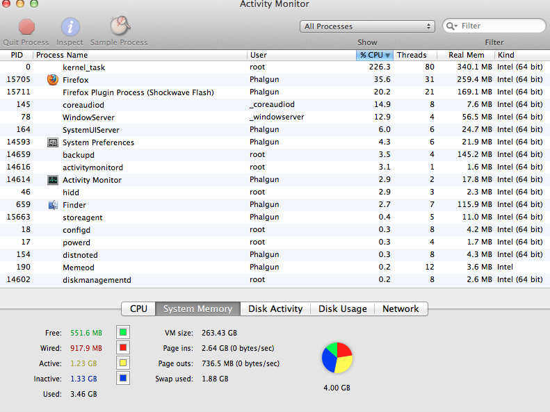

kernel_task is above 200%
Hi,
I have 13in MacBook Pro. It is 1 year old.
4GB RAM
500GB Hard Disk
2.4GHz
10.8.2 OSX
I think high %CPU use of kernel task is because of flash
I have attached two screenshots.
Thanks

It seems very unlikely to me that it is caused by Firefox/Shockwave Flash. Did you quit Firefox and then check if kernel_task used less CPU?
I'd check to see if you have an third-party kernel extensions, and try removing those. Or start with a Safe Boot and see if the problem occurs then.

How can I find third party kernel extensions and how can I safe boot? I noticed when play chess from chesscube.com which uses flash, kernel task is going up from 5% to 220% and system got slow. Also my Mac is getting very hot in 30 mins. Is this normal?
I used to play chess but I have never experienced this problem until last 3 days.
Do you think this is because my mac is getting very hot? I was not using flash player but the kernel task went above 300%

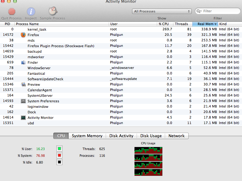

I will try to safe boot and check. I have attached another screenshot

LPZ,
I ran mac in safe mode...kernel task is below 10% even though I ran flash but the system got slow like in normal mode.

There are no page outs, so you have sufficient RAM. In the screenshot, you do have two browsers open, and it appears that Spotlight is working at indexing your filesystem. That could explain the slowness.
To see if any third-party kernel extensions are involved, reboot without using Safe Boot and then open Terminal (in Utilities). Copy and paste the following into Terminal and press return:
Code:
kextstat | grep -v com.apple
This should produce a list of any non-Apple kernel extensions that are loaded (if any). Please post the output.

There might be malfunction of a exhaust fan. I installed iStat Pro and it says exhaust fan is 0rpm. My Mac is over-heating, especially on the left side of the keyboard. I am not hearing fan sound from last 2 days. Before that there was weird sound coming from my fan (for couple of mins and then goes off), it is like a cracking sound. I thought there might be dust particles in my fan. Now I do not hear fan sound at all. Do you think this might be the reason for kernel_task having high % CPU?
I am unable to run AHT. I guess I need to connect my Mac to ethernet and then try AHT. Do I need to run SMC? Clear the dust particles in the exhaust fan?

I noticed the kernel_task is above 200% when I am watching movies or using flash and when the Mac is getting hot.
The CPU Temperature was 80-90C (not F)
