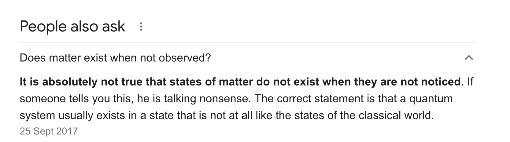

Not wrong: "Observers are powerful players in the quantum world. According to the theory, particles can be in several places or states at once—this is called a superposition. But oddly, this is only the case when they aren't observed. The second you observe a quantum system, it picks a specific location or state—breaking the superposition. The fact that nature behaves this way has been proven multiple times in the lab." Source
Oh, also this:
Oh, also this:
I’m gonna sneak up on my steak and see if I can catch it turning into liquid and back to solid.
Reactions: Enzo Morocioli
Oh, also this:
You’re talking quantum mechanics, not classical physics. Quantum mechanics are by definition “useless” and most of it is complete conjecture. I know scientists who specialise in this thing day in day out, please do not argue further
