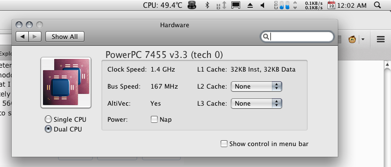

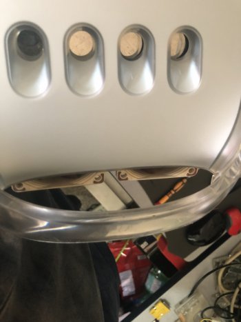

just an update, i tried an experiment, and i voltage modded the updated papst fan in the 2002-2003 mdd's. 12v makes it roar like heck, using the noctua reducer cables makes it so the fan doesn't spin at all and then i voltage modded a cable to run at 7v. now it pushed a crap-ton of air but the sound is manageable. i also cut away the internal spider behind the fan that was causing some air turbulence in the case. now it sits under my desk and it's a low hum instead of a high roar.
*edit... with chud nap off, my cpu is hovering around 49 celcius

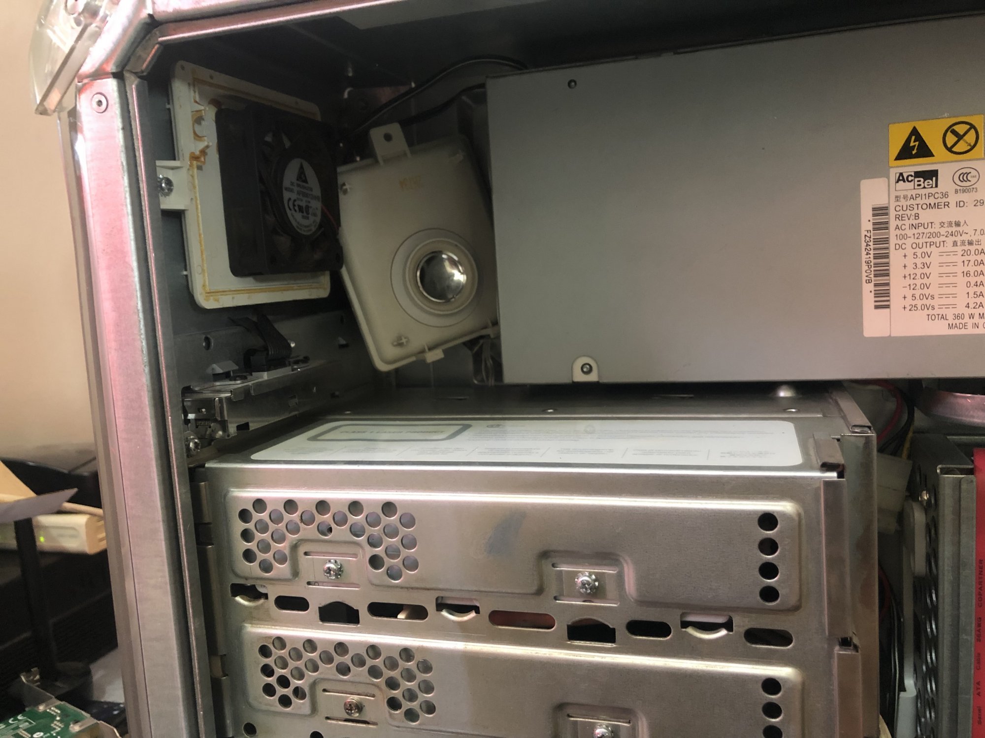

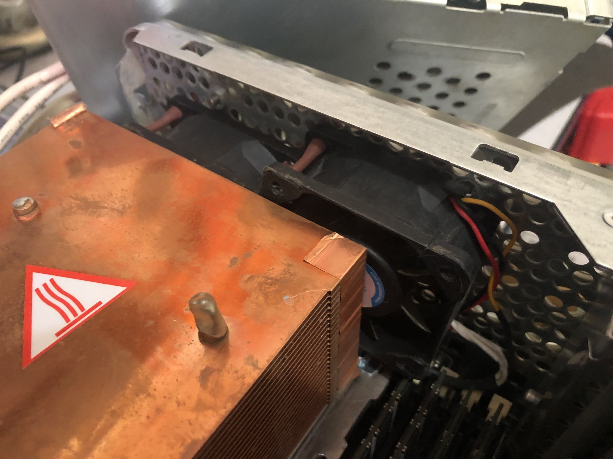

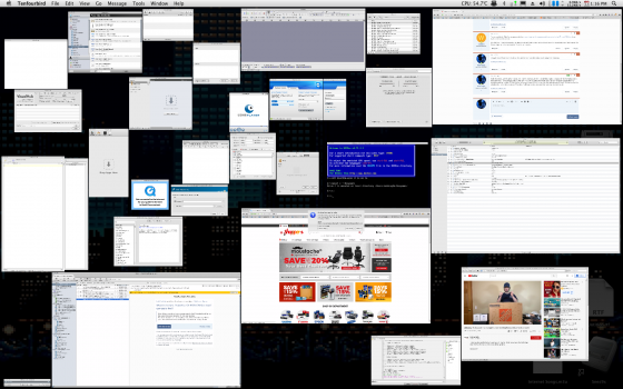

Well, the SilenX 120mm came in today. I will admit, being a 12V fan, it is definitely quiet. I plugged it into my fanbus and it blows alot of air. I'm surprised that at 1400 rpm @ 90 cfm it pushes that much air. It is very noticeably quieter than my modded papst fan running 7V. Right now i have nap turned off just to see what the peak temps will reach. So far running this website only i am sitting at around 50 celcius. I will load several apps and then see what my reading are.

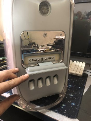

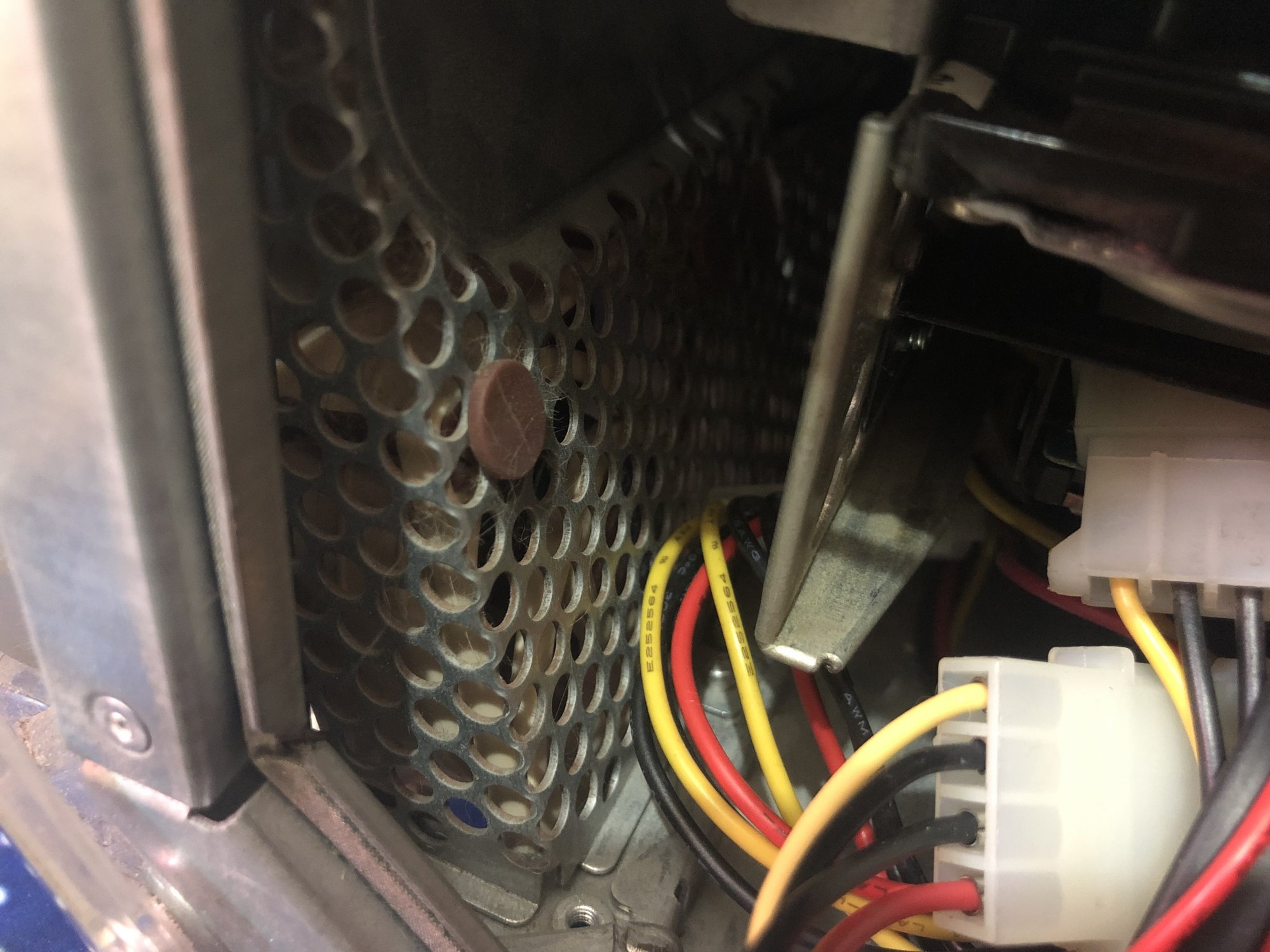

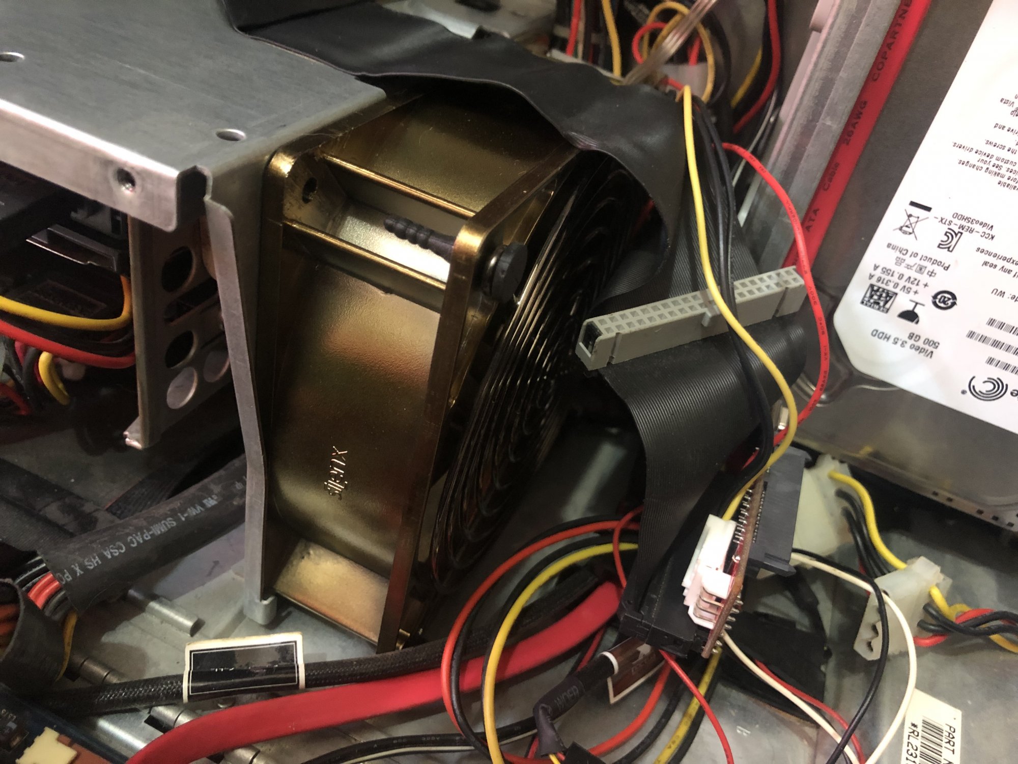

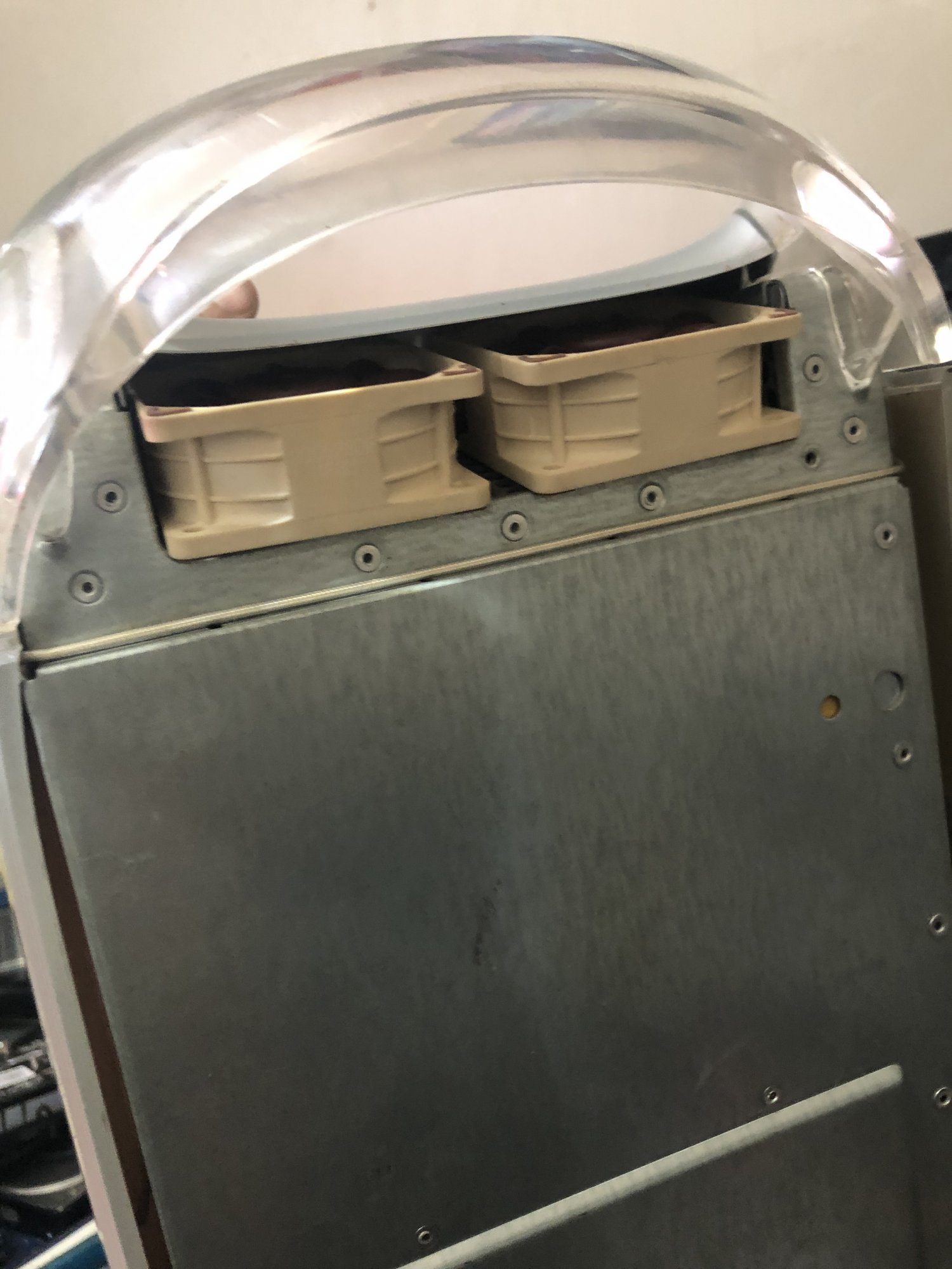

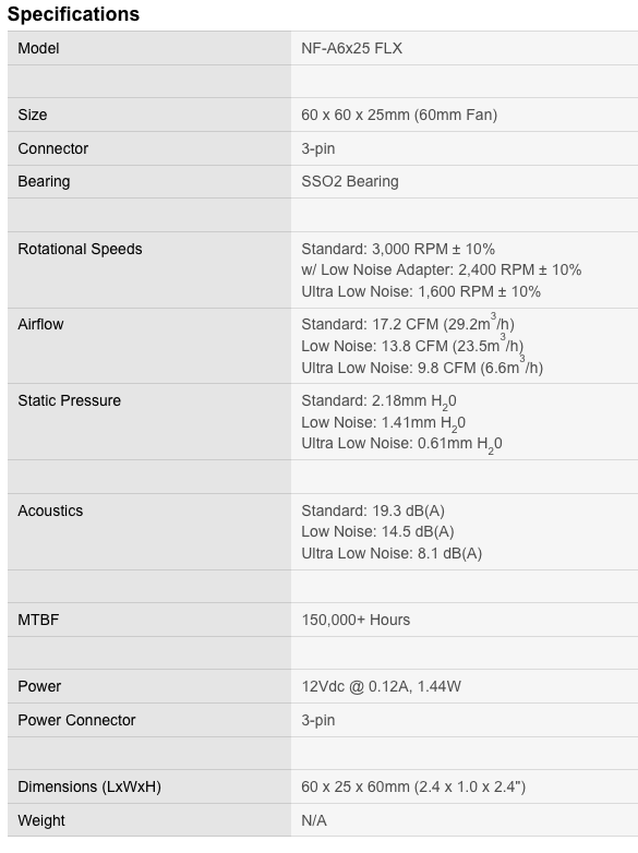

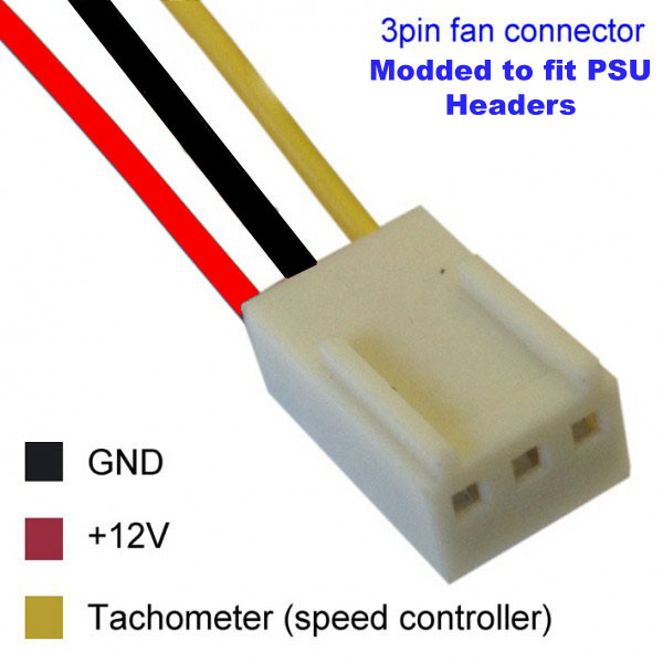

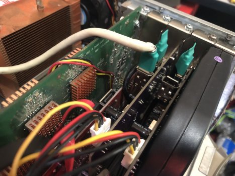

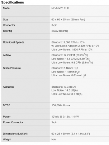

i have a set of noctua 60 mm fans and the only mod i did to them was a wire mod. swapped the red and black wires on the plug then directly plugged them into the psu fan headers. so when you look at the fan it will show the red and black wires backwards. also i will upload specs of the noctua fan too. FYI i don't use any of the wire reducers with the fans, so no 9v or 7v

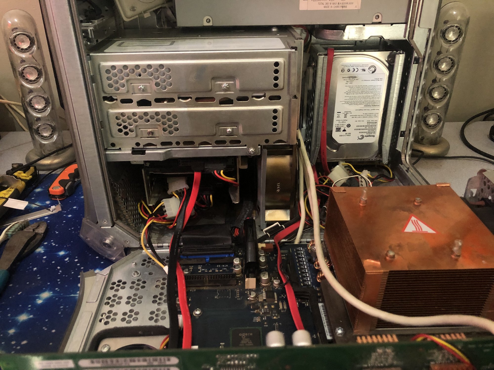

This is a video of all the fans i have running in my MDD and how quiet it is
*after watching the video, it sounds like the machine is loud but take into consideration the the iphone mic is very sensitive. So it sounds louder than what it actually is

Nice machine! Judging from the copper heatsink it appears its the dual 1.42?

Fyi: Single 1.25 GHz MDD

Yes, that is a dp 1.42 and yes the psu fans are replaceable. Just need to do a wire mod on the fans, thats all. And the psu does the rest. I chose the noctua fans because at full blast, those little guys are quiet. And i have used them before in the mdd psu’s without ever having an issue

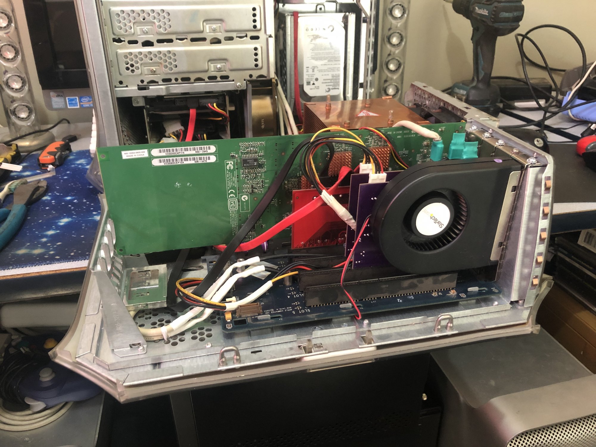

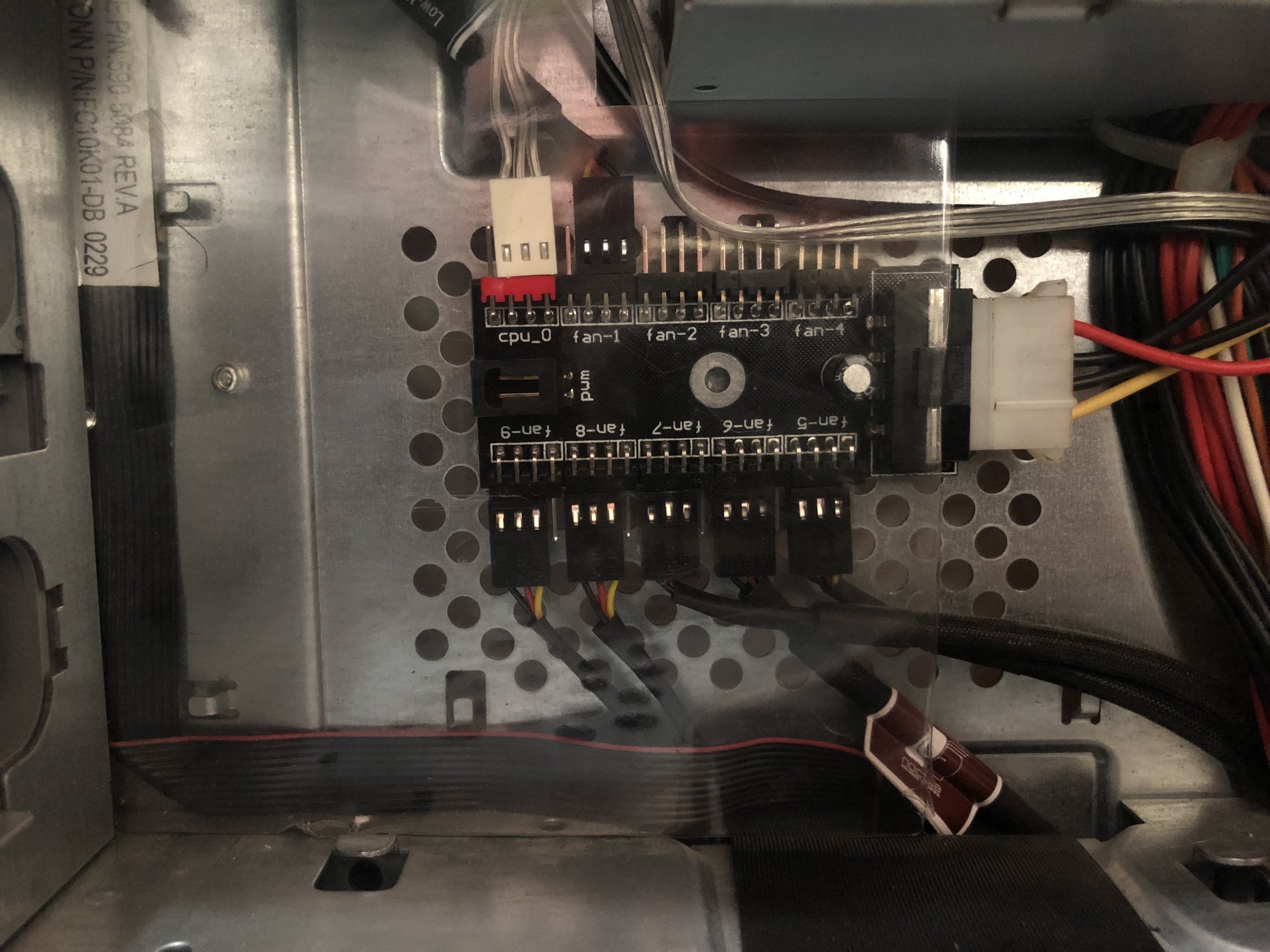

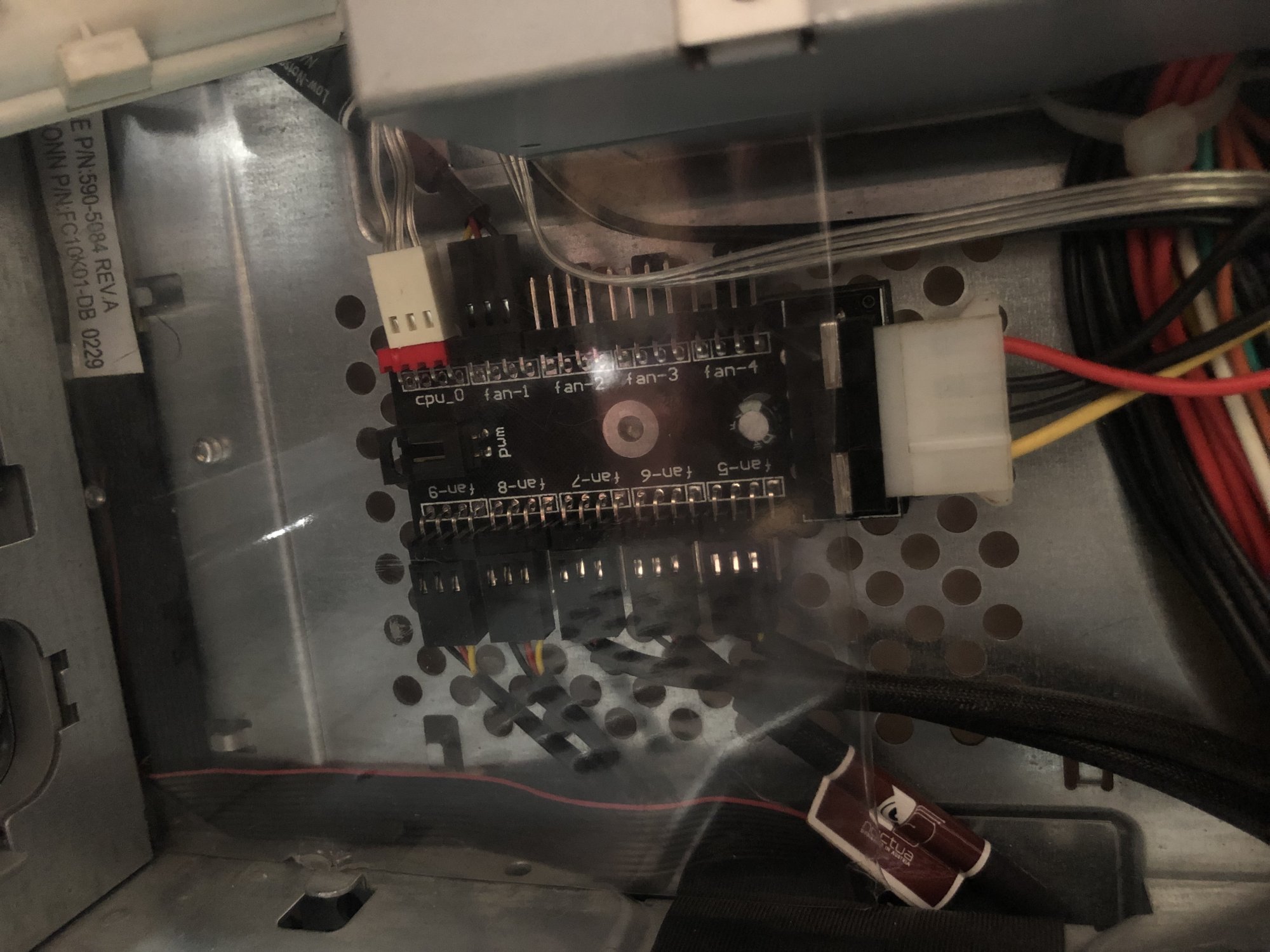

I have all my fans except the psu fans and cd fan hooked up to a fan splitter. Takes the load off the logicboard. And with those there are no wire mods, just noctua fan resistors on some of them. The silenx fan is hooked up to the cpu header and gets a full 12v and is very quiet and pushes a crapton of air
Awesome, I'll attempt this on my system. Thank you for the explanation.

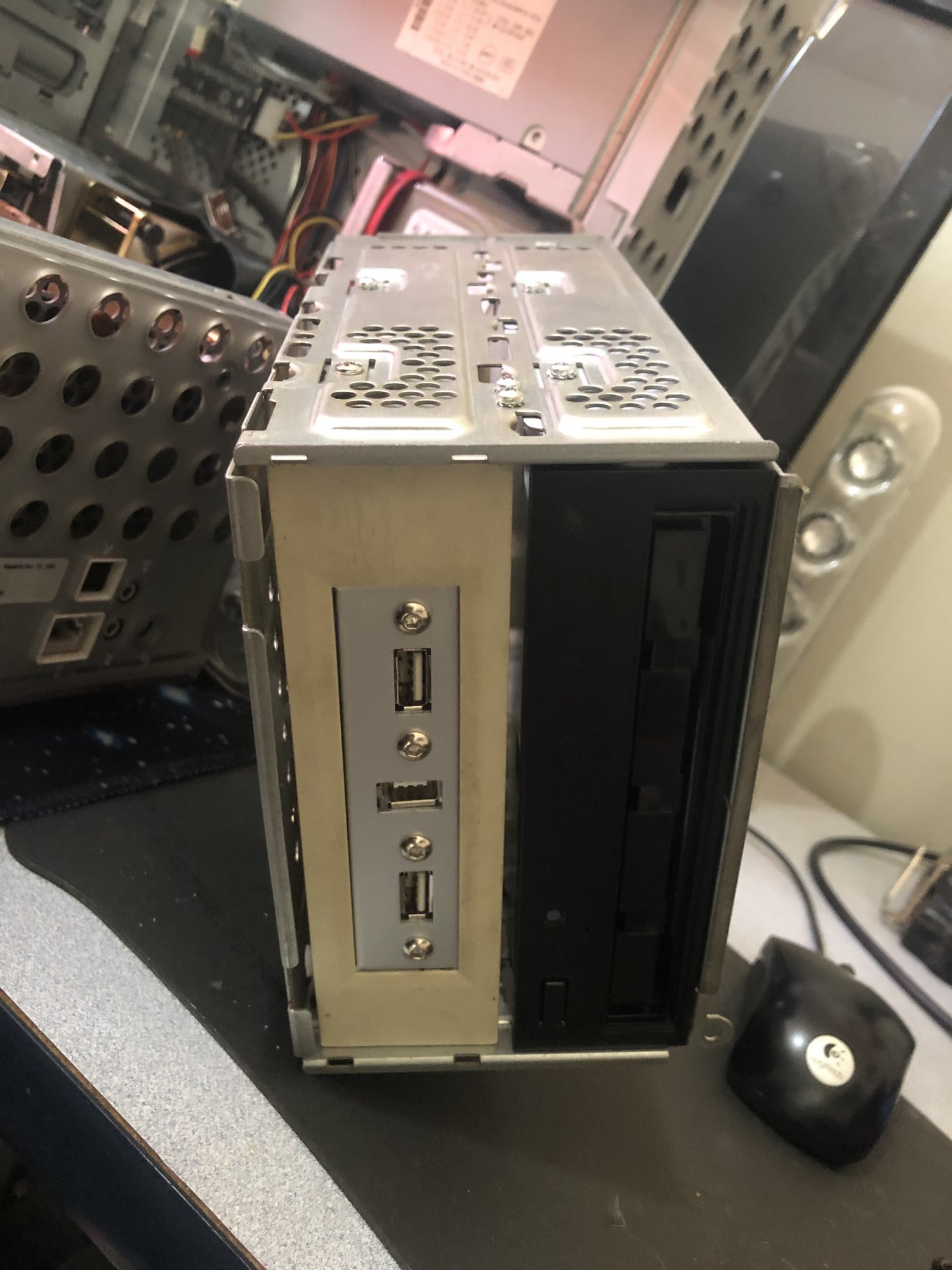

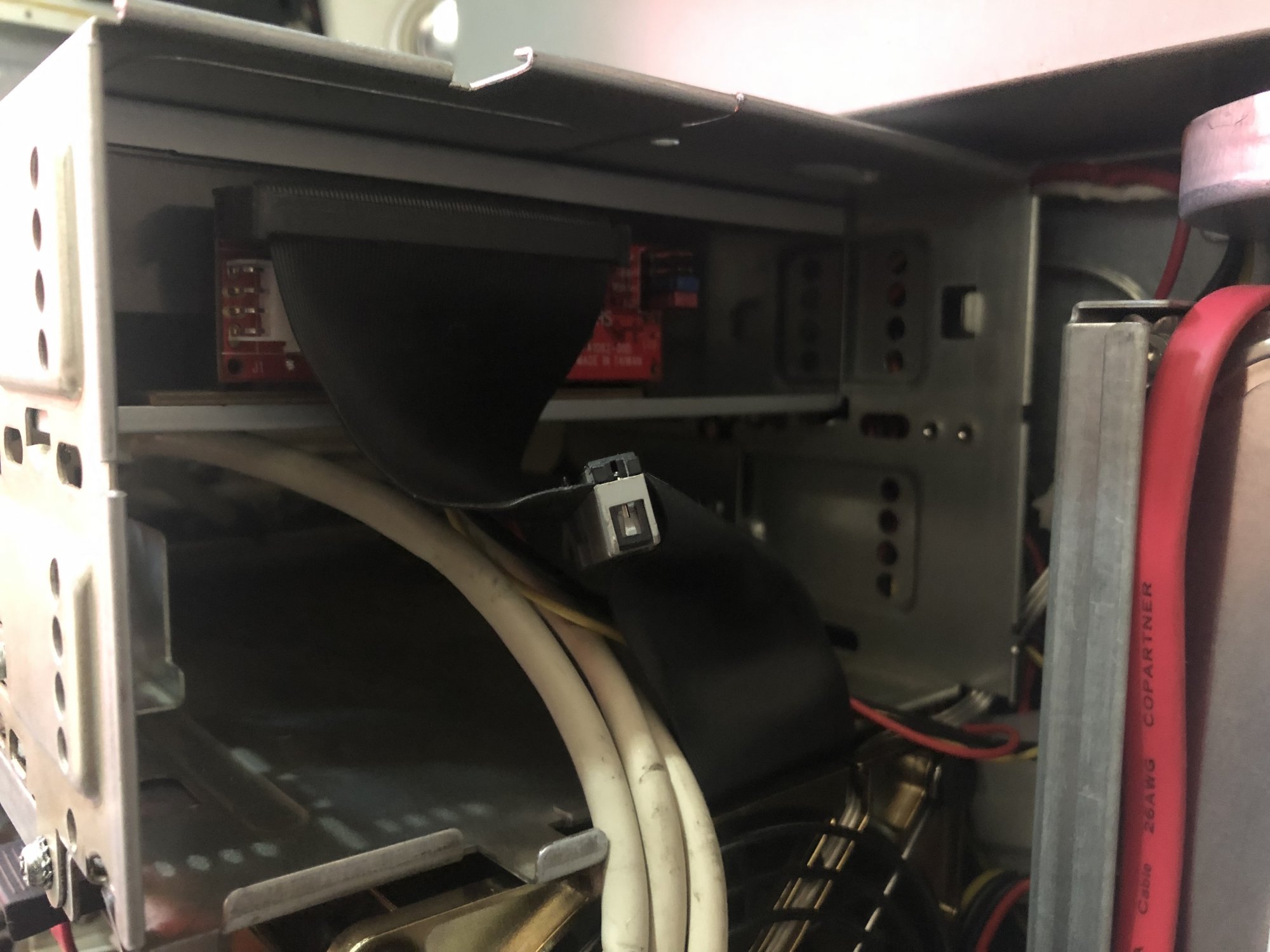

when i get a chance, i'll take some pics and upload them here with the wire routing and all the fans in my MDD.
Right now the machine isn't hooked up because i am running most of my software that i need on my mac pro. i also have a g5 dp 2.0 sitting on the floor collecting dust that i may or may not use for older software that my TiBook can't handle. also need a video card sometime down the road for my QS thats also sitting on the floor collecting dust.
i may need to sell some of my extra MDD parts that i have sitting around (case, cpu's, heatsinks, cages and whatnot)

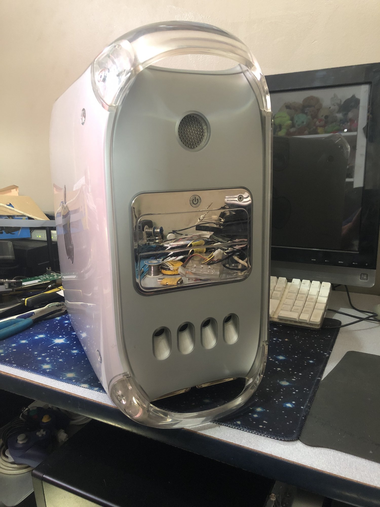

I noticed thats a 2003 model, did you do a cpu upgrade? or did you put the copper there to be safe?
actually its a full mod. the case is a different one than what i was originally using, the board is an older 167mhz board and the cpu was pushed to 1.5ghz. the copper heatsink is there because of the high heat output
