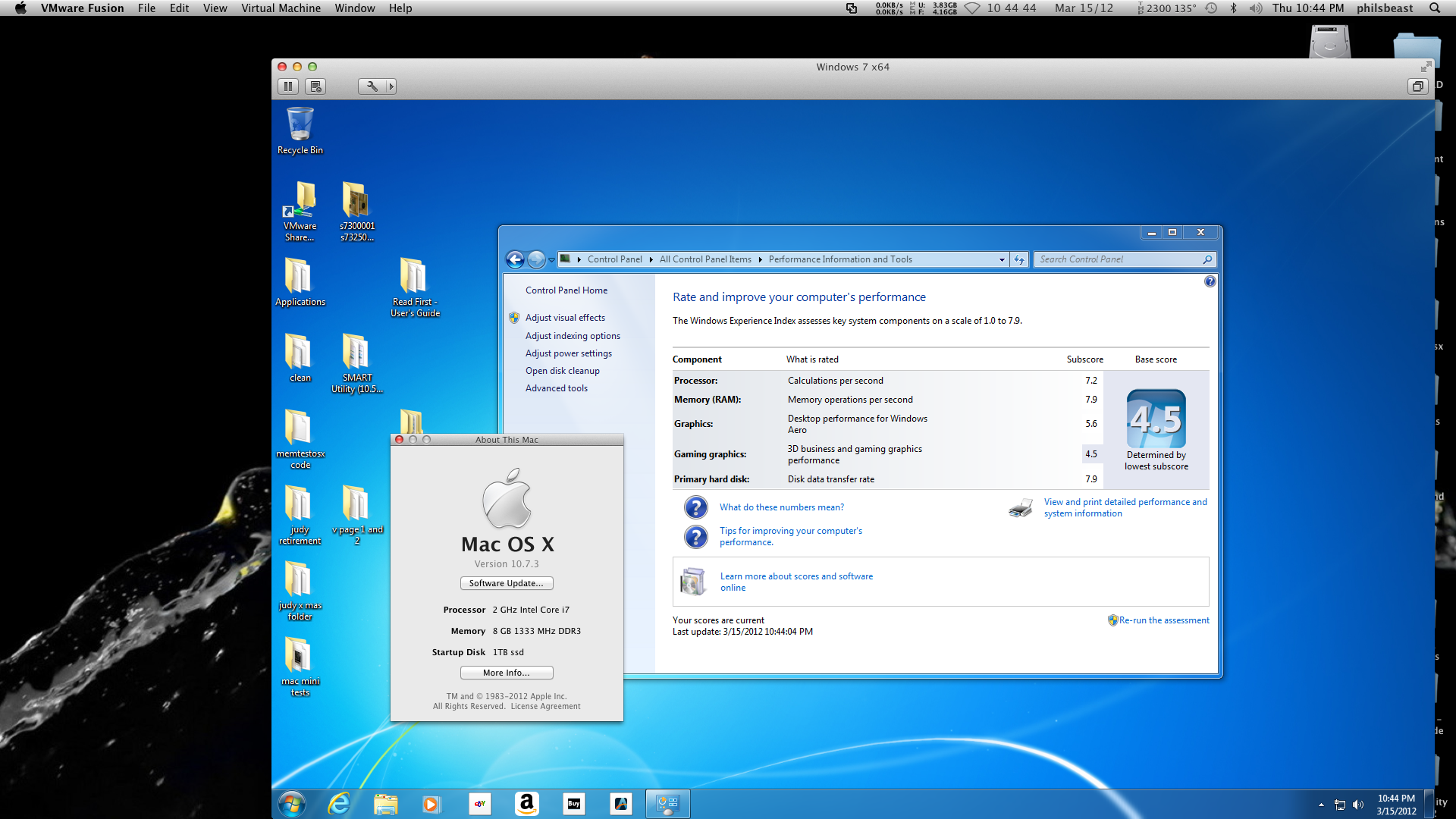

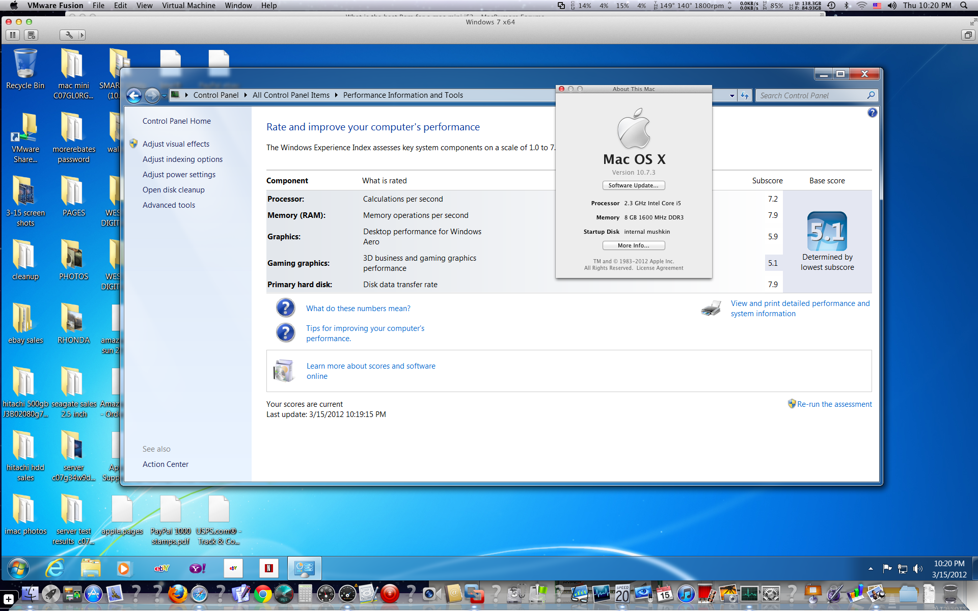

if you run windows you get better wei scores for graphics. and for ram not much but better. I will run the test with 1333 ram in a few minutes.ran the same test on my server with 8gb 1333 ram. even though the server has a better cpu it has intel 3000 just like the base mini. the kingston ram improves graphics. score is still not good. i would say you want 7.2 at least but that is not in any mini.

@philipma1957
I noticed you got your scores while running windows 7 under vmware. How accurate are they compared to a native bootcamp?
I know when I've tested scores under virtualization, they've always been god awful, due to the virtual software using their own drivers for their 'virtual' graphics card.
I'm also curious if the ram may be affecting the scores in a weird way, by not improving HD 3000's use of speedier ram, but improving how vmware itself uses ram.

I was not able to get bootcamp to do a good install . i had an issue with timeout bug when trying to attach the windows to my internet connection. It worked with my mac pro but all the minis I ried to do it with did not work.
I got a sale for vm 25 bucks instead of 50 and did it that way. (black friday)
It is a good question that you are asking. I am just a bit lazy to try and do bootcamp install again.

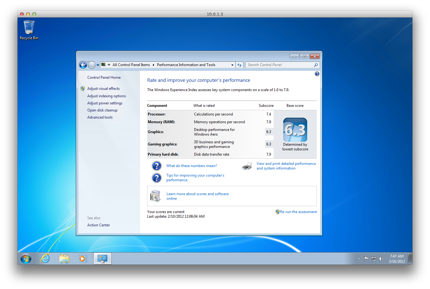

Here are native scores for Windows 7 in bootcamp on a highly optimized. Note the perfect memory and primary disk scores 😉
2011 Mac mini server
2.0GHz Quad-Core Intel i7
8GB 1866MHz Kingston Hyper X
Dual (2) 240GB OCZ Vertex 3 MAX IOPS
Microsoft Windows 7 Professional 64-bit (bootcamp with AHCI enabled)
See Windows Experience Index Score in attached image
Geekbench 2 64-bit: 11622
http://browse.geekbench.ca/geekbench2/488313
