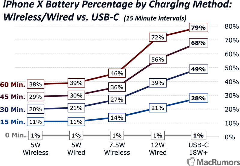

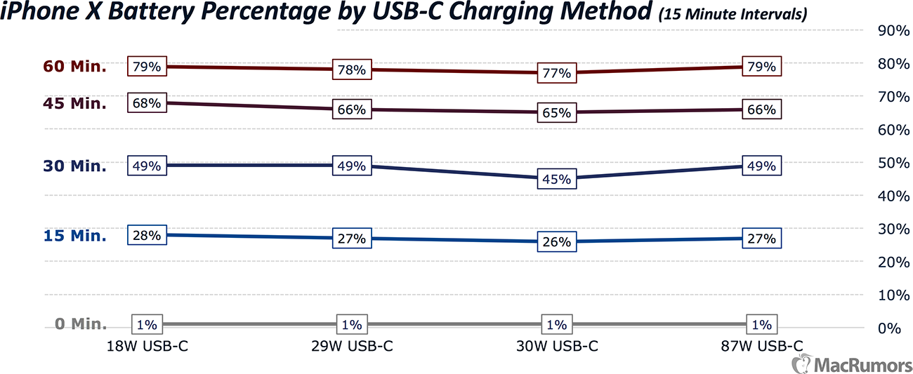

I think you're right. The quickest relevant comparison that came up with Google is from a test done by MR. Here's the relevant graphic, which shows that using a PD charger above 18W charges has essentially no impact. I was a little surprised. That was with an iPhone X, not an XS or an 11 Pro. I sort of doubt that Apple has changed the charge controllers in the newer phones, since the biggest constraint is probably battery chemistry, and that hasn't changed. What surprised me a little more was that the old 12W iPad charger does almost as well as the more sophisticated USB-C/PD chargers (second graphic below).
Test mentioned in my post above was from Inviolabs, because it measured watts real time (as well as charge time vs. %). It was on an iPhone 11. There are other tests like what you found, including tests on earlier fast charge capable iPhones....all show essentially the same result as the data you posted re. 18W vs. 30w+.
The Inviolabs (iPhone 11) test resulted in (30W/18W PD)...30 min. 55%/53%, 1 hr. 84%/80%, and both reaching 100% within a minute of each other. Insignificant difference, certainly would not justify carrying bigger heavier charger just for the phone, or worse yet buying one.
And, yes, the good old low tech. relatively small and light 12W iPad charger is a gigantic improvement over the 5W. And does nearly as well as 18w/30w PD chargers. I‘ve been using on iPhone for years, when I needed a fast charge.
