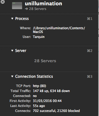

Hi All,
This new process appeared 1 week ago when I was away on vacation using a mobile USB device to connect. That device has been just fine for 6 years, and only ever used a couple of times a year (in the same place) when I find myself in the boondocks. No neighbours there, and no WiFi anywhere around.
Old MBP with Mavericks.
LittleSnitch started kicking off asking for permissions to connect to sites with addresses consisting of all kinds of longs strings of rubbish. Being paranoid I said no. Then, as it was getting insistent, I completely blocked the process, and all ok since then - even back home on a good connection.
However, what's really spooky is I can find not 1 reference to this process searching on Google, and now Adobe Lightroom (properly licensed and working) is stalling and not performing at all.
If it's a kosher process, why on earth are there zero references to it on Google ?
It's also a process that re-spawns the moment it's closed in Activity Monitor. I've added a screenshot below in case it helps - and I am *not* Tarquin.
Anybody have a clue?
Many TIA.

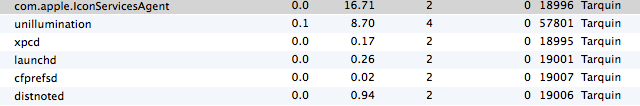

I'll take a look at Etrecheck, and meanwhile here's a view on what other processes are flagged to user 'Tarquin' in case any of it makes sense.
Thanks!

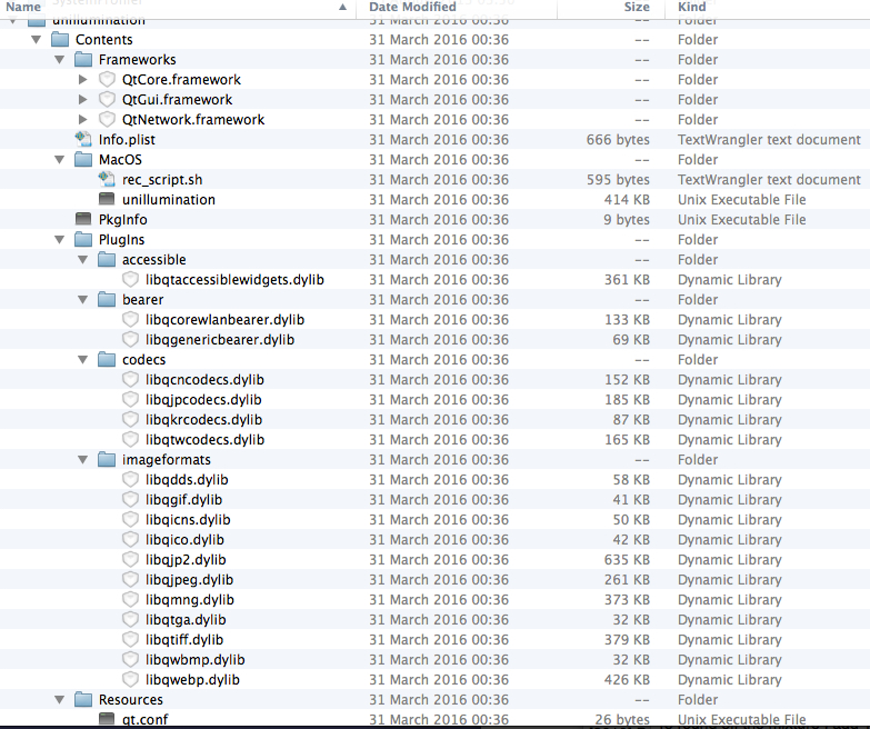

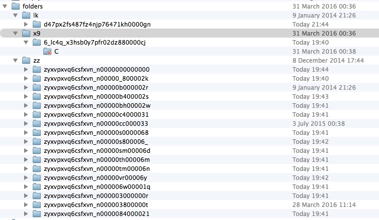

[doublepost=1459896720][/doublepost]p.s. Here is a copy of the Library contents for it in case it rings any bells.
I am far from being a coder, so maybe the contents might mean something to you or others ?
Thanks. That looks like a file-sharing App.

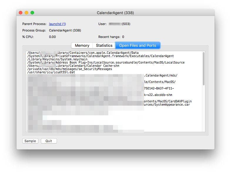

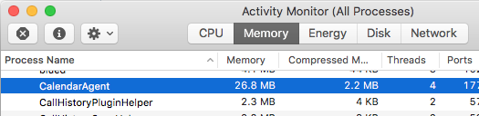

Np problem... here is what you do. Start Activity Monitor and select that unilluminated process with your mouse like I did with CalendarAgent in my screenshot. Now click the i in the tool bar just above that. It will bring up a window like my bottom screenshot. Click to the Open Files and Ports tab of the window. That will show all files that the unilluminated process is using.
Reactions: 997440

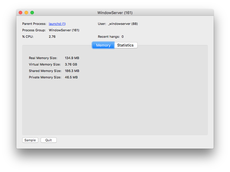

* Activity Monitor
Now I see the problem. I only have 2 tabs - Memory & Statistics; no 'Open Files And Ports' tab. I'm using v10.9.2, and haven't updated as it will disable some of my important software. Maybe that's why I don't have that tab?
Whatever, many thanks for the tips. You have given me enough to hopefully get rid of the user & the plist.
Will hang on though in case there's a work-around for my missing tab.
* Activity Monitor
No... that just means that process does not have any other files or ports open. Like this process for example.
Could anybody else have had access to your system to install this? I am still baffled how it got on there if you were doing nothing else at that time. Have you recently installed any new apps that may have carried this malware payload?
I just checked myself, and for other process the tab is there - just not for those being run by Tarquin. Phew.

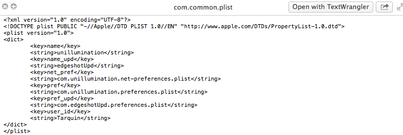

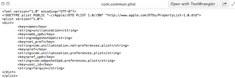

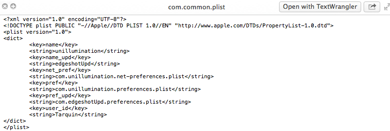

Based on what you posted above as well as the shell script, you should probably proceed like follows.
  1. Check out: /Library/Preferences/com.common.plist (with Quick Look)
    If it only contains entries relating to ‘unillumination’, then remove the file completely (it is not present on my Mavericks installation, so it may have been created by it).

Kallt, thanks for posting the code - and Amit for your article/advice. Now, where to start ?
I have another one that Etrecheck found - 'edgeshotUpd'. I thought I'd got that one back in December. It came posing as MacKeeper, and I immediately realised it was dodgy, so did what I could to get rid of it. No new user name though.
I'm posting a screenshot of the com.common.plist as it includes entries for both of these mongrels.

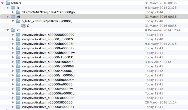

While looking for more traces of that, I also noticed a folder modified at exactly the time this started, and a sub-folder created at exactly the same time. It's at /var/folders/ per the below snapshot, and the subfolder 'x9' was also created at the same time - 31/3/2016 00:36.
I can't get in there though, as I'm told I have no permissions, despite being setup as Admin.
Is this something you found during your testing? And should it be deleted ?
[doublepost=1459973136][/doublepost]And the attachments of course. BTW, Just realised the edgeshotUpd file has my machine ID, so maybe not a good idea to u/load that one.
[doublepost=1459973769][/doublepost]And the related folders under /var/

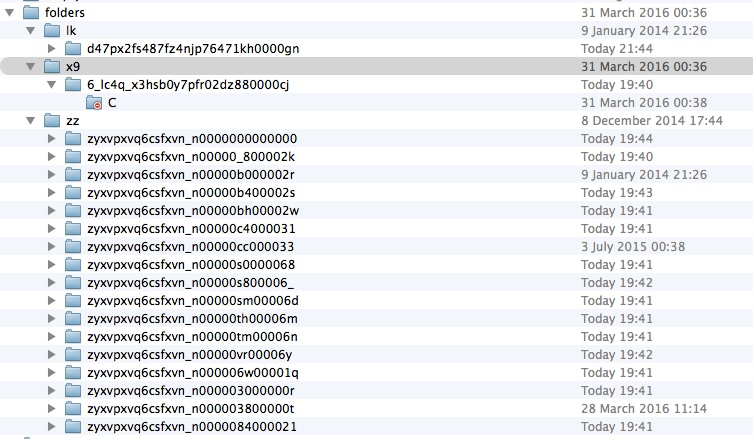

Just when you think you've nailed it.... :/
Whatever ends with Upd ia a variant or pirrit (its also in my research paper). Again, running my script as root should fix your problem. I found some more variants and checked their installation script against my removal script, shouldn't be an issue there. Can you look in /var/tmp and see what's the date thats written next to the word DemoInjector on that folder? Also, please look at your download folder, did you download any cracks or something like that lately? Try to think about what you installed before you were infected.
Amit, I have run all the Terminal commands already, but shall give your script a go tomorrow. Thanks.

Meanwhile, any thoughts on the /var/folders/x9/ screenshot pasted above ? That was created at the very same time as it all kicked off.
Ok, radio silence has ensued.
Weaselboy, I wonder if you can help me with the last unanswered question? being;
"Meanwhile, any thoughts on the /var/folders/x9/ screenshot pasted above ? That was created at the very same time as it all kicked off."
From what I've found searching, these are basically cache files. Some advice says it's ok to delete folders at this level, but other advice says 'don't mess with them'.
Seeing as this folder & contents were created when the adware was installed & started trying to communicate with the outside world - to the second - I can't see that nuking them would do any harm, but would feel a lot more comfortable to get other opinions here.
Thoughts ?
