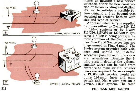

Fifty-some years ago, 110/220, 115/230, and 120/240 volt systems were pretty common in the U.S. The image below is from the November 1956 issue of Popular Mechanics, which suggested that 115/230 was perhaps the most common 3-wire system then in use.
When I was growing up, all the older electricians in town called it "110/220" because that was the voltages used by most of the area's mining companies that operated the power stations that supplied power to the "company owned" town in the Central Appalachian Coalfields, back when they were first installed in the early 1900s.
