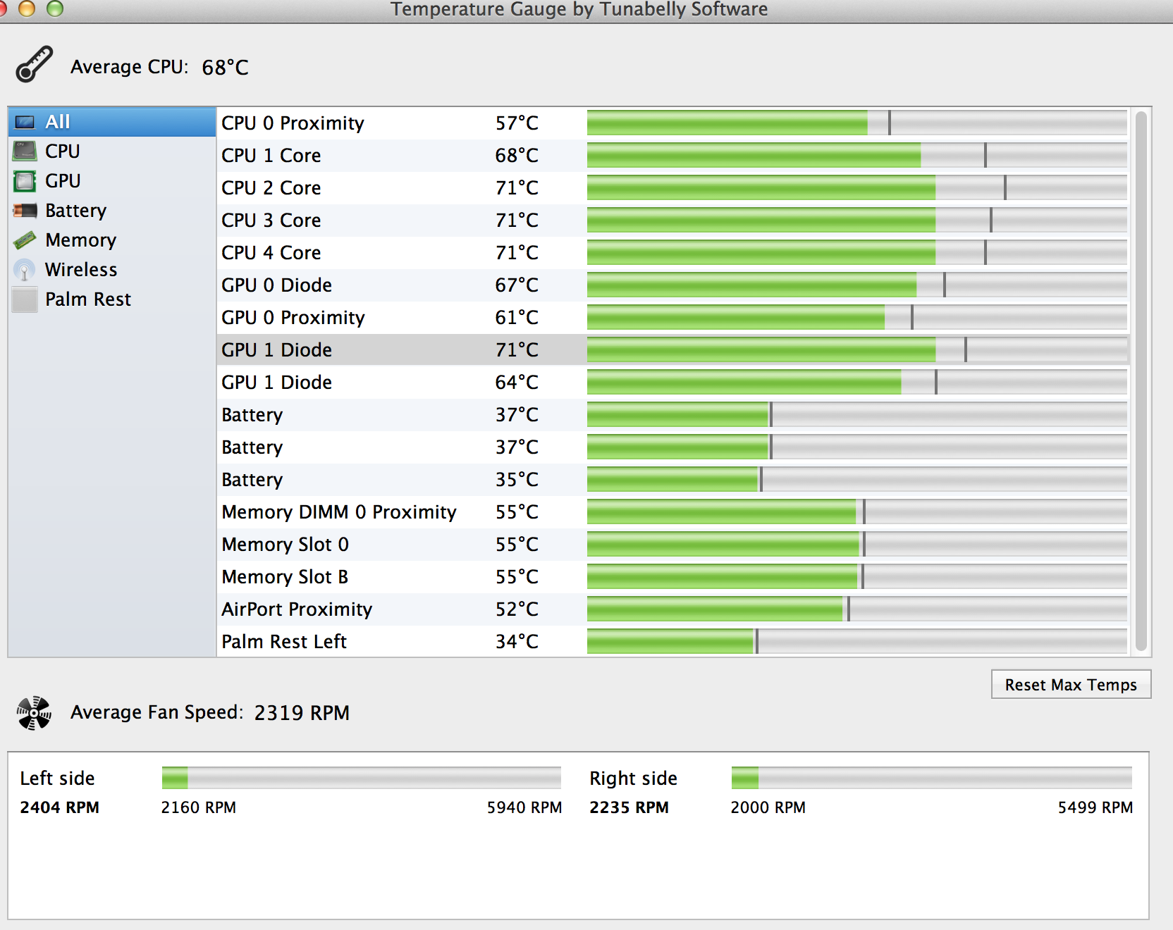

I just want to know what is your MacBook Pro's temperature when running idle and on loads.
Are using any software or apps like SMCFan Control or Temperature Gauge maybe?
Please post a picture or post your temperature readings🙂
Thanks.

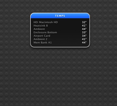

Thanks Mark. Is there any way you could tell us what software do you use for the temps?
Could you show us a picture too? 😉
Here you go
I'm using iStat Nano. Looks like the temperature in the overview is the hard drive temperature.
